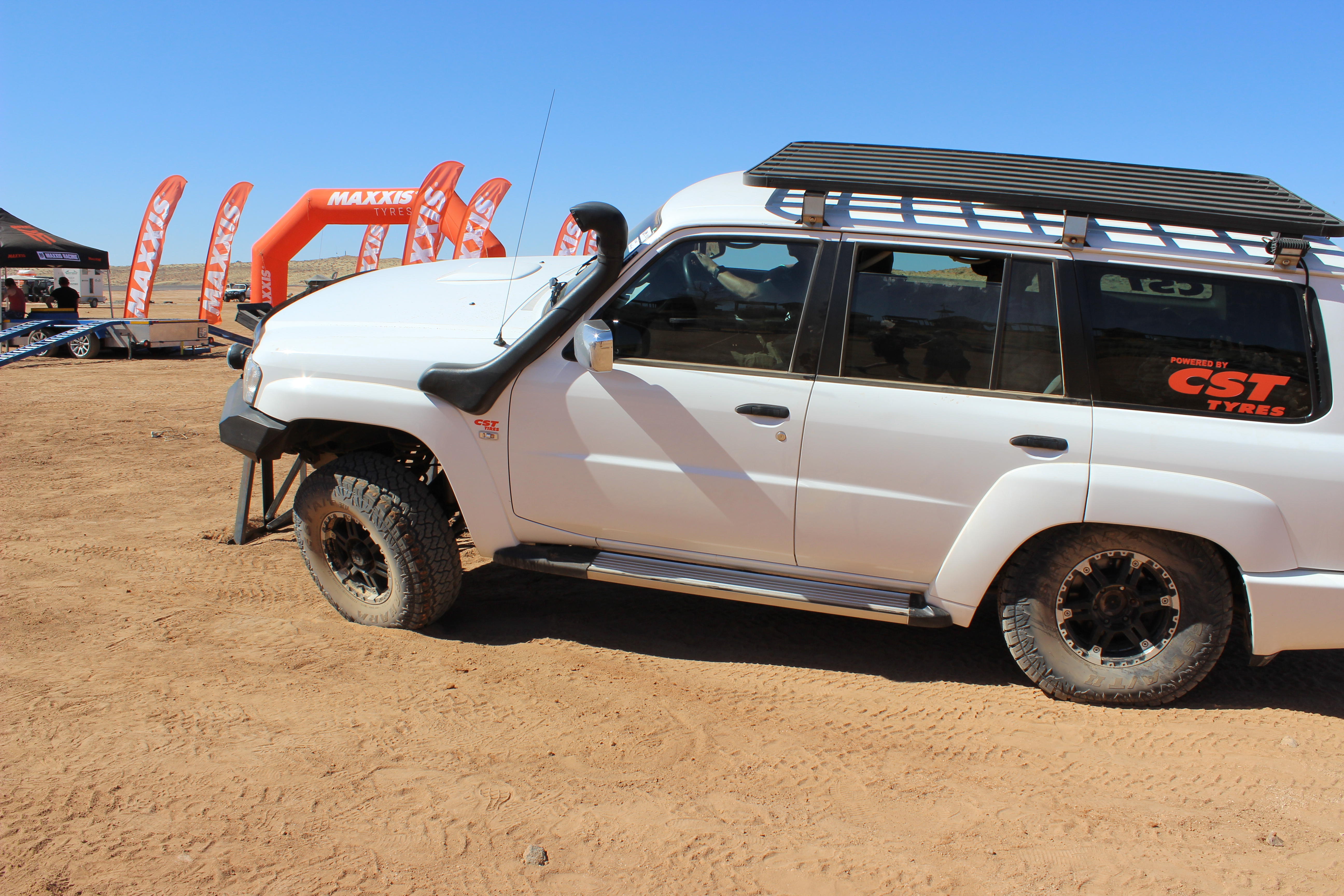

Re: Speedy se toer trokkie
I agree with Tinus, the 33's really shouldn't be touching, unless the offset on your rims is way out. The 33's on my Trol fit easily in the wheel arches on full articulation.
- IMG_3561.JPG (7.12 MiB) Viewed 10048 times
Cheers, Gareth

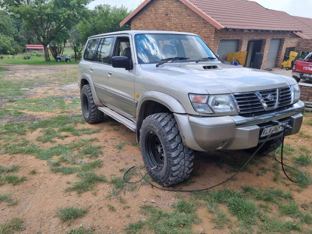

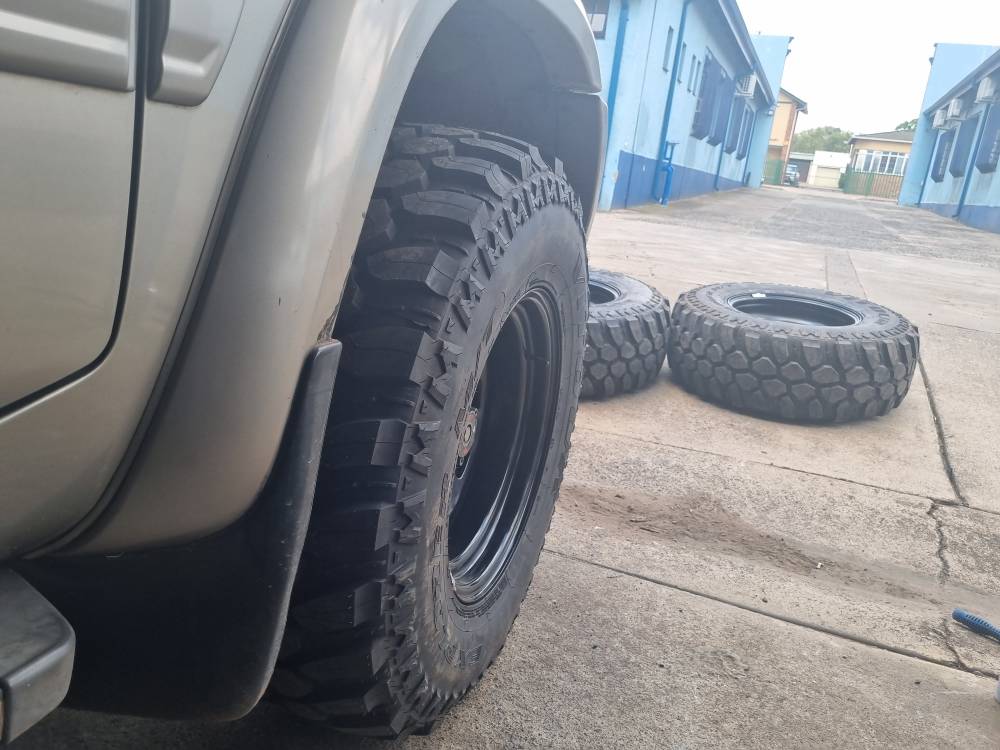

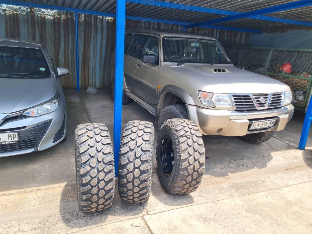

My new tires arrived! I decided to go with the Vitour Explorer MT as it has a nice aggressive thread and since Toer Trokkie will mostly be used for adventures, I didnt want to go with an AT. Unfortunately the options on wheels are very limited out there and I was left with choosing Dynamic steel rims with a -25 offset
Sent from my SM-G990E using Tapatalk-

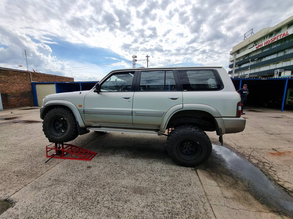

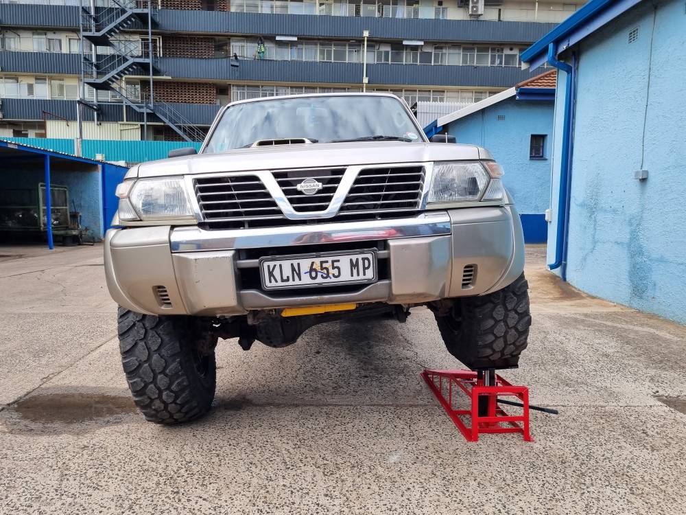

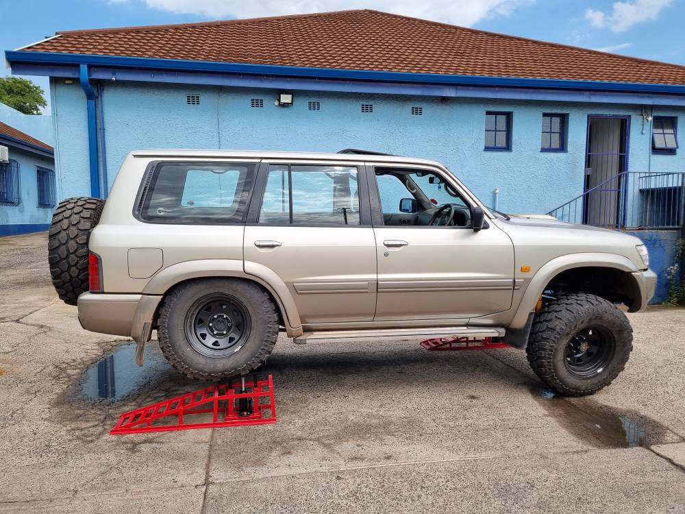

Playing around with the ramps to make the necessary modifications for the 35s. Im currently running at 1.8 bar and it feels like the right balance for road use. Swaybars are connected again to get the handling back as well. I actually forgot what a difference these things make on the road.
I will have to give these wheel arches a slight trim on the inside and then modify the fuel tank hose cover as the tires are pushing against it Sent from my SM-G990E using Tapatalk

Some feedback
After we fitted the 35x12.5R17 on a -25 offset wheel, I thought it would be good to change out the OME 2" comfort coils for the Tough Dog 742 HL coils that has a constant load rating of 300kg. Obviously the thought process is that if it was meant to carry more weight, it wont flex as much if there is no constant load right? Wrong! The Tough Dogs gained me an extra 30mm lift unladen compared to the OME and compressed a lot better than the OME too and I genuinely cant say that the Tough Dogs ride any harder, honestly, I thinks its softer!
So, my next mods are to extend those bump stops with about 10mm for extra safety and I need to get myself some swaybar disconnects and some decent shocks that can provide more travel compared to these OME shocks.
Engine wise, the Lexus 3uz 4.3 V8 really impressed me! I think my biggest issue has to be that I cannot lock a gear, even though I have all the wiring set up to be able to keep it in the gear. So the next step now is to give the Spitronic TCU a go and see what the results are. Since I changed to 35s, one can imagine that the revs are significantly lower and I managed a 22L/100km on the open road. My 3 biggest factors are that I cannot make the gearbox downshift and keep the gear and then I am still waiting for the fuel pressure regulator and my O2 sensors still need some cleaning or replacing. Taking that into account, I really dont think Toer Trokkie did bad at all. Torque wise, the motor didnt lack in my opinion either. Heat was also not an issue with these Davies Craig fans making quick work to cool her off in less than a minute!
Tire wise, my Vitours did exceptional. We did the red route at De Wildt 4x4 and the rain certainly did a number on the track! I opted for 1.0 bar pressure all round and the Patrol kept up with all the Jeeps from Rockrawler without issues at all. Considering the terrain is quite rocky, I checked the sidewalls for any damage, but glad to say not a single cut!
I am now in need for some new swaybar disconnects as my OEM ones are stuffed and might as well upgrade while we're at it!
To more adventures!
