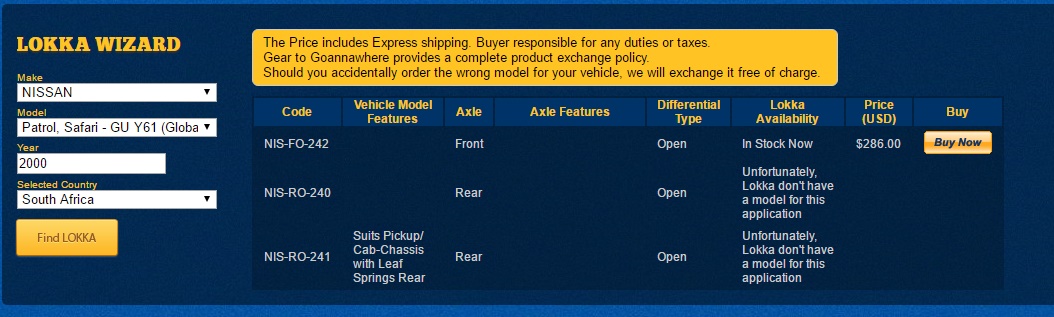

For which locker?offroadbiker wrote:a Group buy should maybe bring the price down even further.....
Lokka is currently $286 = R3827. But import duties is probably another R2k.
There is a "not so active" member on this forum who have bought a lokka locker from australia and imported. (He is more active on 4x4community).
http://patrol4x4.co.za/memberlist.php?m ... ofile&u=63
