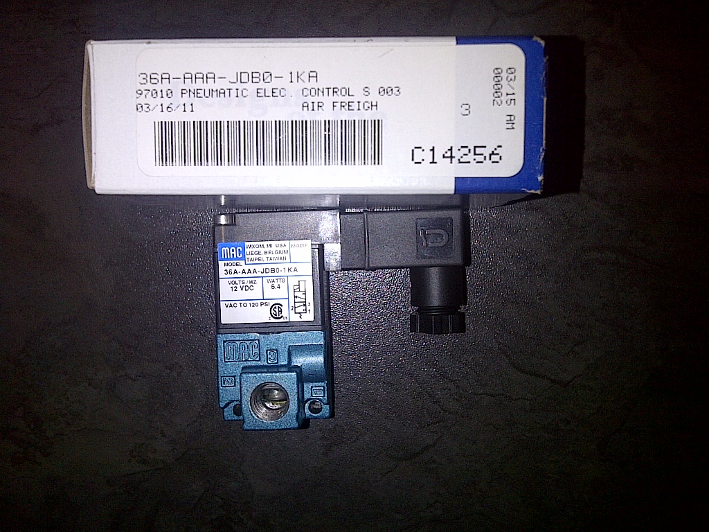

Ons doen iets soort gelyks vir die turbo Subaru manne, ons vervang hul ou 3 port boost control solenoid met n MAC 36A-AAA-JDB0-1KA (teen R377-00 excl vat en less 5% discount) ons kan ook die barbed hose fittings doen teen R15-00ea excl vat en less 5% discount.
Soos die foto wys, die valve is electically actuated (12VDC) so daar moet n control circuit wees om die excess boost te kan reguleer, die pics wat jy ge-post het lyk of hul manually adjust, ons het ongelukkig nie n replacement vir n manual valve nie.

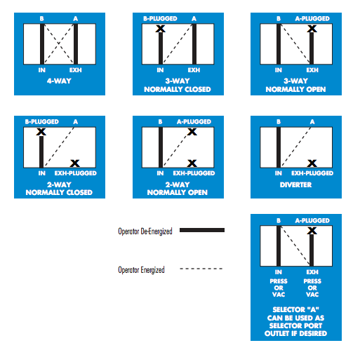

I picked up my MAC solenoid from PECS in Cape Town today. I read on the the aussie patrol forum that the exhaust port of the valve needs a filter. Anybody know where I can find such a filter? Or is it ok to just plug that port? I found a document on macvalves.com regarding the 45-series valves, and by the looks of it, we'd be using it in the DIVERTER configuration, in which case the exhaust port only needs to be plugged.

Marco, do you know what thread is in the valve's holes? It should say on the box or paperwork, and it's probably either 1/4" or 1/8" NPT.
You probably can't just plug the hole, as that would prevent the system from operating. I am however surprised that PECS cannot supply you with a breather. Most such suppliers have little screw-in breathers that have elements made from little copper/brass balls pressed together (sintered) and rated at about 5 micron, which is more than adequate.
