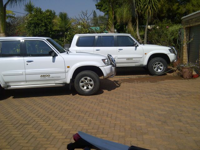

My 2001 4.5 had the big nuts with the washer and the 2004 4.8 uses the small nuts.
Here is a photo showing the different rims.
Re: Wanted: Patrol Wheel Nuts
So it looks like it is not model specific, but rather mag wheel specific.
But beware that if you use the wrong nuts on that specific mag that requires those larger washered units trouble will follow.
