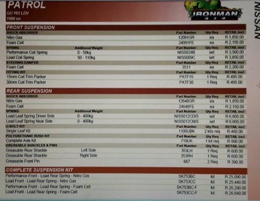

Vaal ironman: R25k for iron man suspension...
