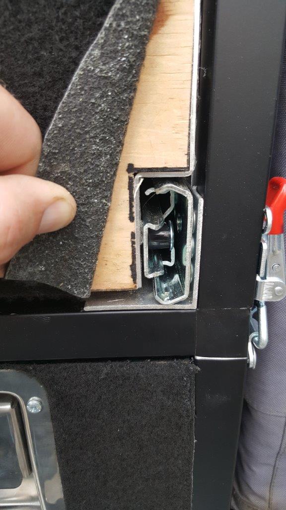

This is a close up showing the bent sides for the drawers and how the drawer slides fit in the recess.
I was fretting about how I was going to bend the aluminium sheet until I mentioned my problem to the guy that cut the sheets for me. He pointed me to a small engineering firm and an hour later they were done:)With great Power comes Great Fuel Consumption

I got it at KELHs Upholstery Suppliers. They had a large selection and the stuff I got as a rubber base so is quite pliable and stretchy. In the photo above you can see what it looks like. It stuck down and went around corner very well.
