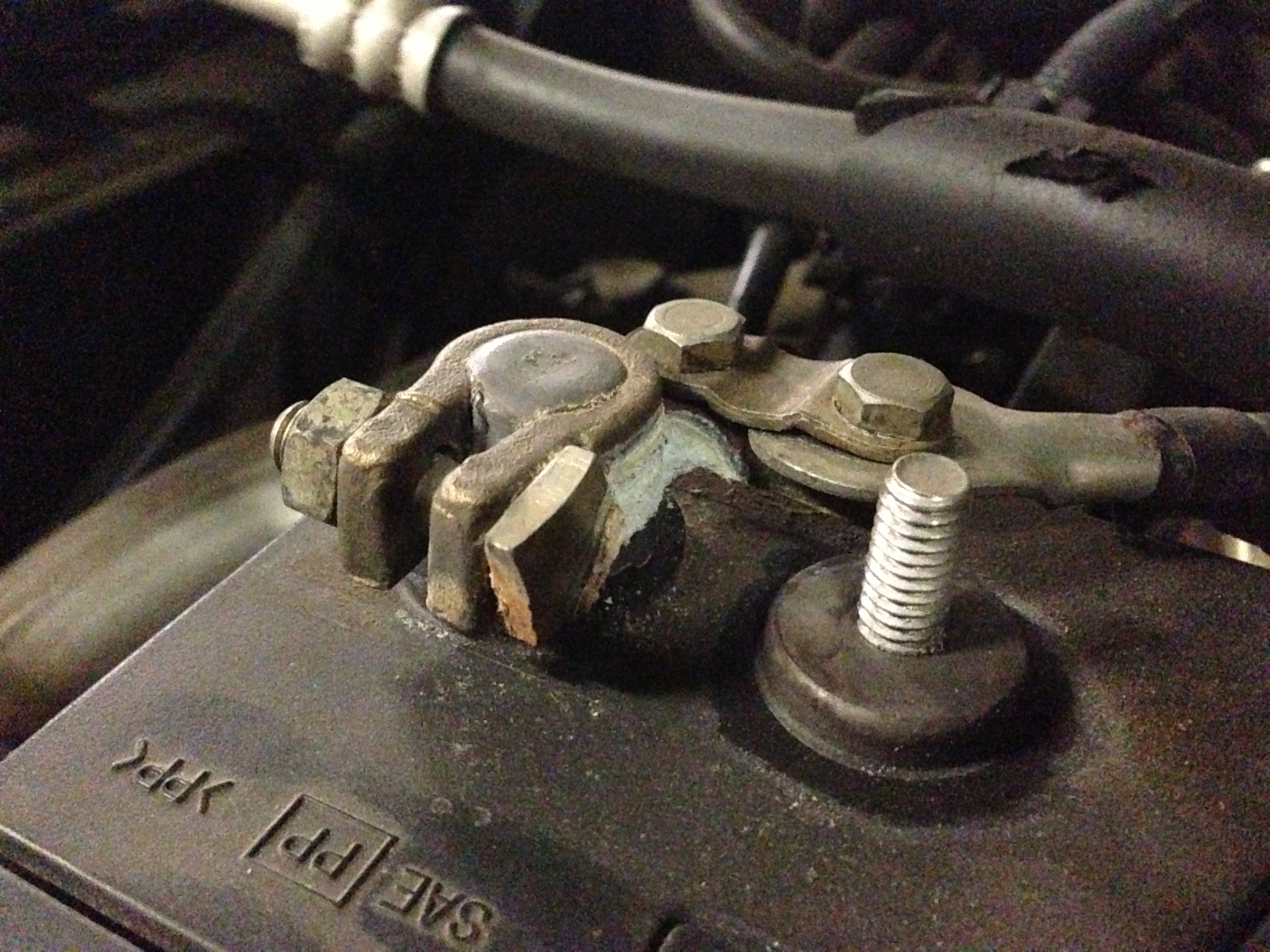

Inspected my battery system last night and notice that the deep cycle really is kaput. Corrosion on the terminals. So i was thinking if this wasnt perhaps a cause for my other battery not receiving proper charge.
So i was thinking of the following questions when it comes to a dual battery system:
1. Does the health of the deep cycle or starter battery make a difference to the performance of the system with respect to charging?
2. Can you have two short cycle batteries in place (i am familiar with the advantages/disadvantages of deep cycle when the car is stationary and off, so this question is mainly to do with will the system still run well when driving, including charging of both batteries and running of fridges etc)?
3. Do both batteries have to be connected in order for the charging/electrical system to work properly (for example will the short cycle/starter battery still get charged) - i suppose will the "circuit" act as if it is complete?

Re: Replacement alternator
1) Not if the system is correctly connected. Both batteries should be connected directly to the alternator and to earth, rather than the dual running through the main.davejones wrote:
I have an old national luna dual battery system.
2) Yes, in fact with a system like the ML you will probably be able to run your camp for longer purely because the standard battery will be able to charge very much faster.
3) The main must be connected, the second not.
4) listen to Tinus. Go lead crystal. They charge faster, , can be used like a deep-cycle and last longer

Okay so my patrol has been standing for almost 3 weeks... actually maybe even a month... i lost count
Picture of deep cycle battery:
Have had the same battery since i bought my Patrol back in 2010 so i think it's done well. Kept my NL well cold the whole of december. But if Peter and Tinus recommend lead crystal then i will definitely look into this more. Thanks for the tip.

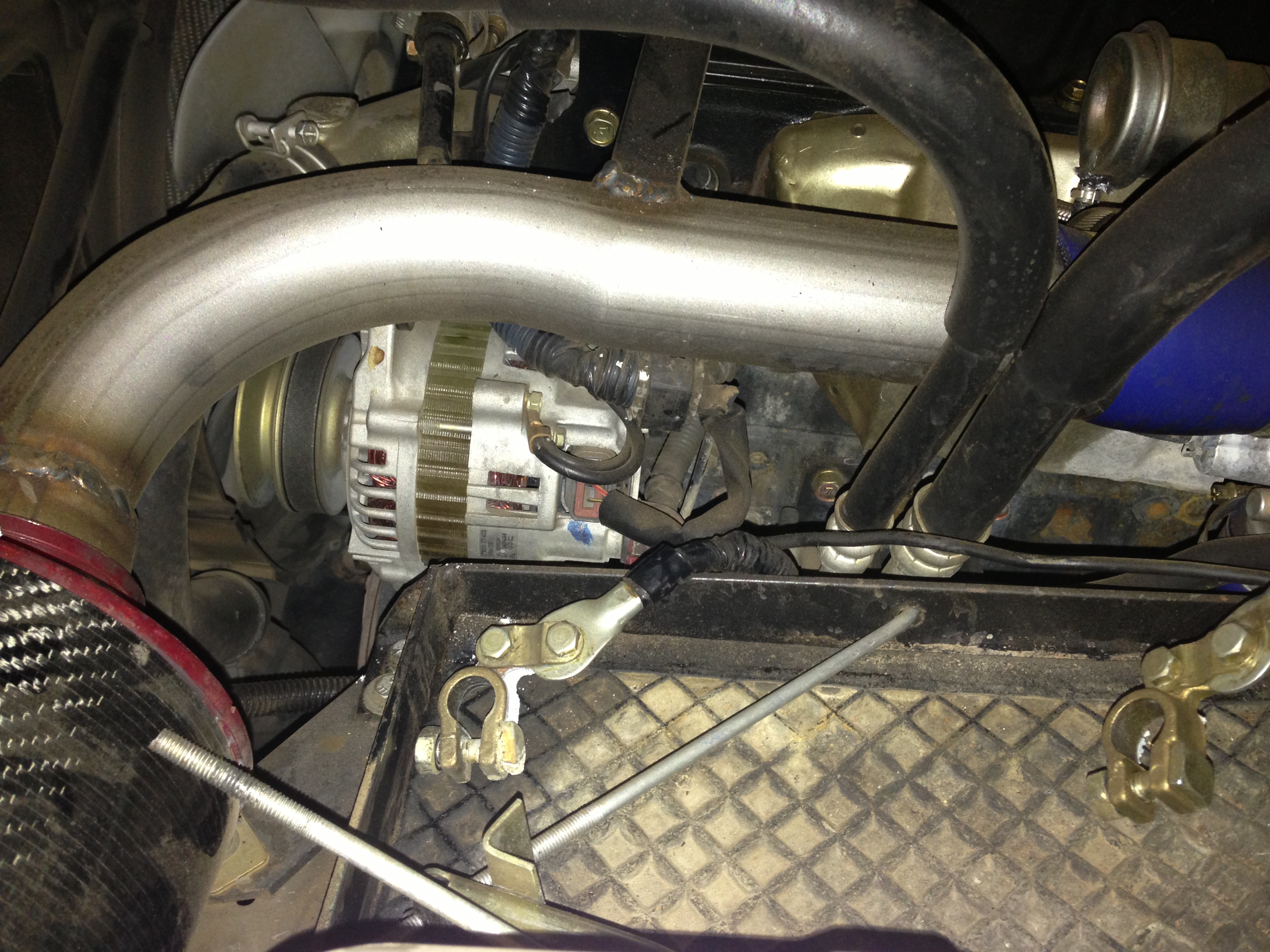

Picture of existing alternator:
Looks like the original 60A job. Just hope there'll be space to fit a larger delco as the air intake run straight over the alternator as my turbo sits quite high in the engine bay.

Hi Dave,
I see you also have your 2nd battery in the engine compartment. just be aware that heat is not a friend of batteries, unless you can install some kind of heat shield or insulation mechanism it will drastically reduce the useful life of your 2nd battery.

Thanks Tinus
I hear you Stefan - plans in place to install some heat protection... also considering options to have second battery installed in the back.

Dave and Stefan, that is one of the major benefits of the lead crystal battery. It can operate at much higher temps without loss of life.
