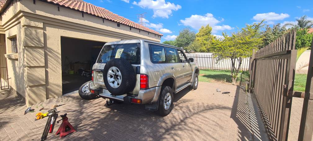

So I finally got her back and today we get to install her new liftkit[emoji16]
Before height:
FL 807
FR 905
910
RL 905 Sent from my SM-G985F using Tapatalk
Before height:
FL 807
FR 905

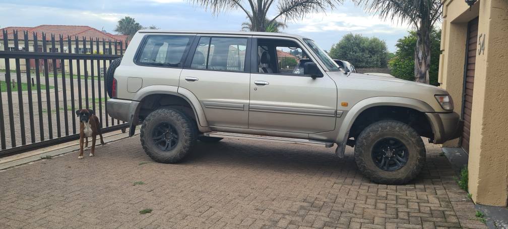

After the lift kit has been fitted
FL 950
FR 950
965
RL 965 Sent from my SM-G985F using Tapatalk
FL 950
FR 950

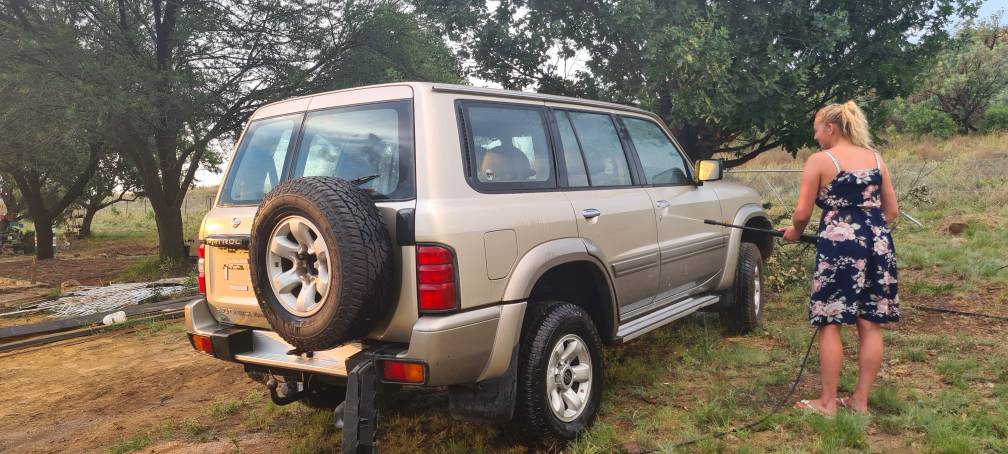

Always fun when your wife helps out[emoji41]
Sent from my SM-G985F using Tapatalk- Tinus lotz

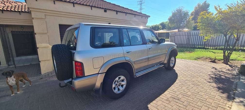

I finally got the new wheels fitted, so time for a before and after. Going from 31"to 33" is a nice jump
- Been thanked: 473 times
Re: Speedy se toer trokkie
good rubber always makes a Patrol look meaner !!
