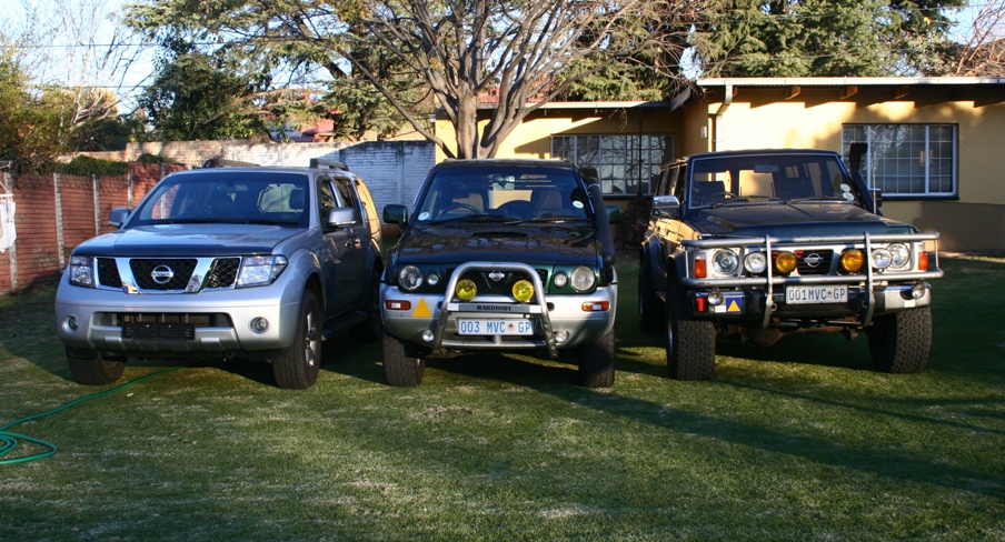

You laugh, at one stage (just after I retired) I was sitting with 3 Nissan 4x4s. I had a Terrano, a Y60 Patrol (4.2i GLX - Grey import from the UK) and a Pathfinder....
Fortunately I came to my senses and sold one, which just happened to be the Y60. Both the Y60 and the Terrano were on the market. Then about 3 years later, I traded the Terrano for the Y61 3.0 Di
The Patrol is my Offroad Tourer and taking clients on Safari to Botswana, Zim and Namibia, places where 50ppm diesel is not available (for the Pathfinder).
The Pathfinder I now see as my platkar, I use it for general driving around and when taking clients on Tours to the Lion & Rhino Park, Soweto, our like an upcoming tour to Swaziland, St Lucia, Sani Pass and home via Lesotho.
