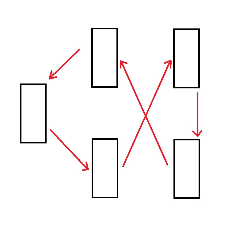

Re: What tyre and tyre rotation
This is how I rotate mine (obviously not directional tyres):
But I like Peter's reasoning with regard to wear vs rotation.
Peter Connan wrote: ↑18 Jan 2018 05:25 I check wear and roatate accordingly. On my car, the fronts wear faster than the rears, and the rights wear faster than the left. So the "best" tire goes right front, the second-worst left back and the worst goes to spare.
