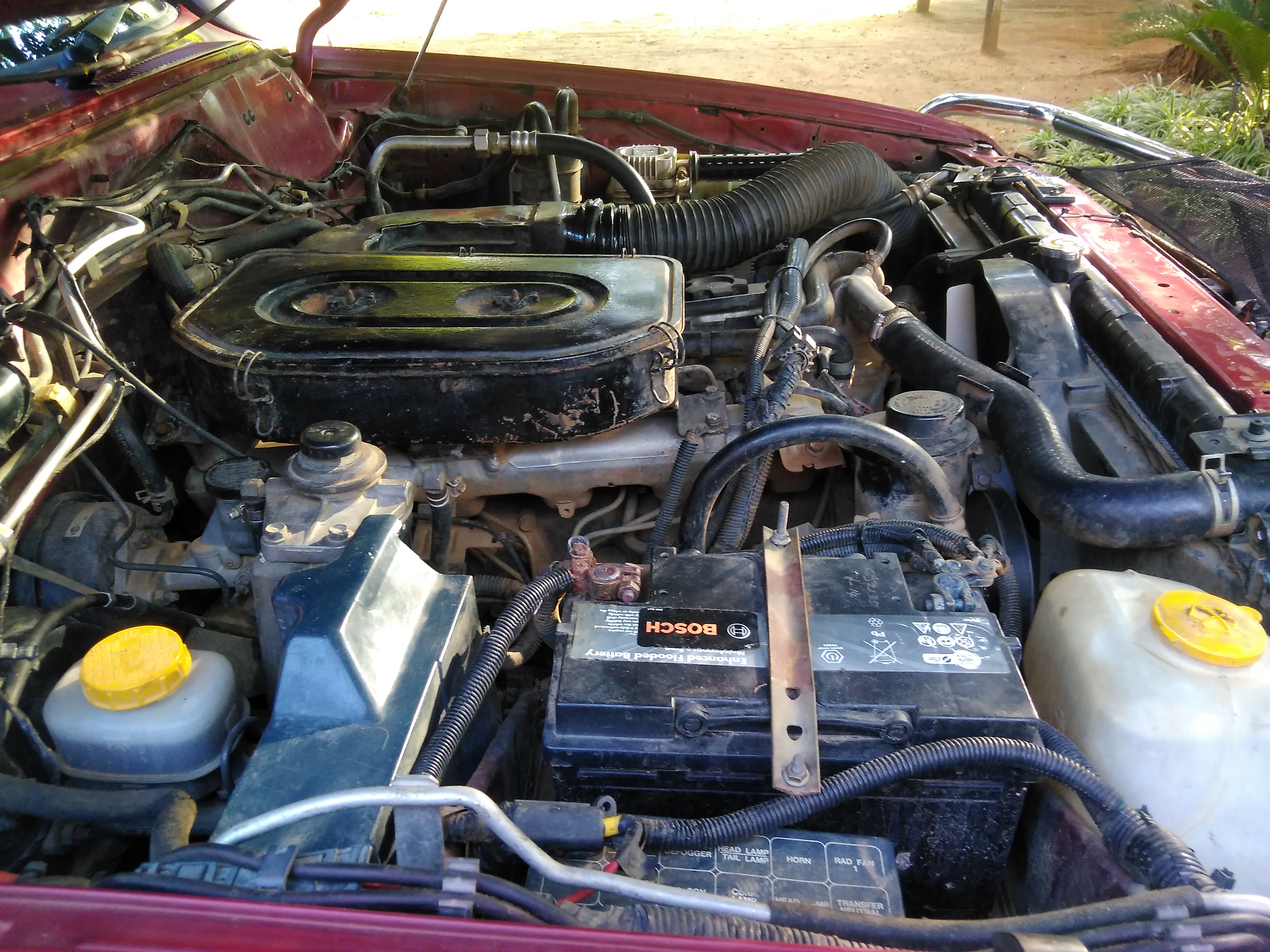

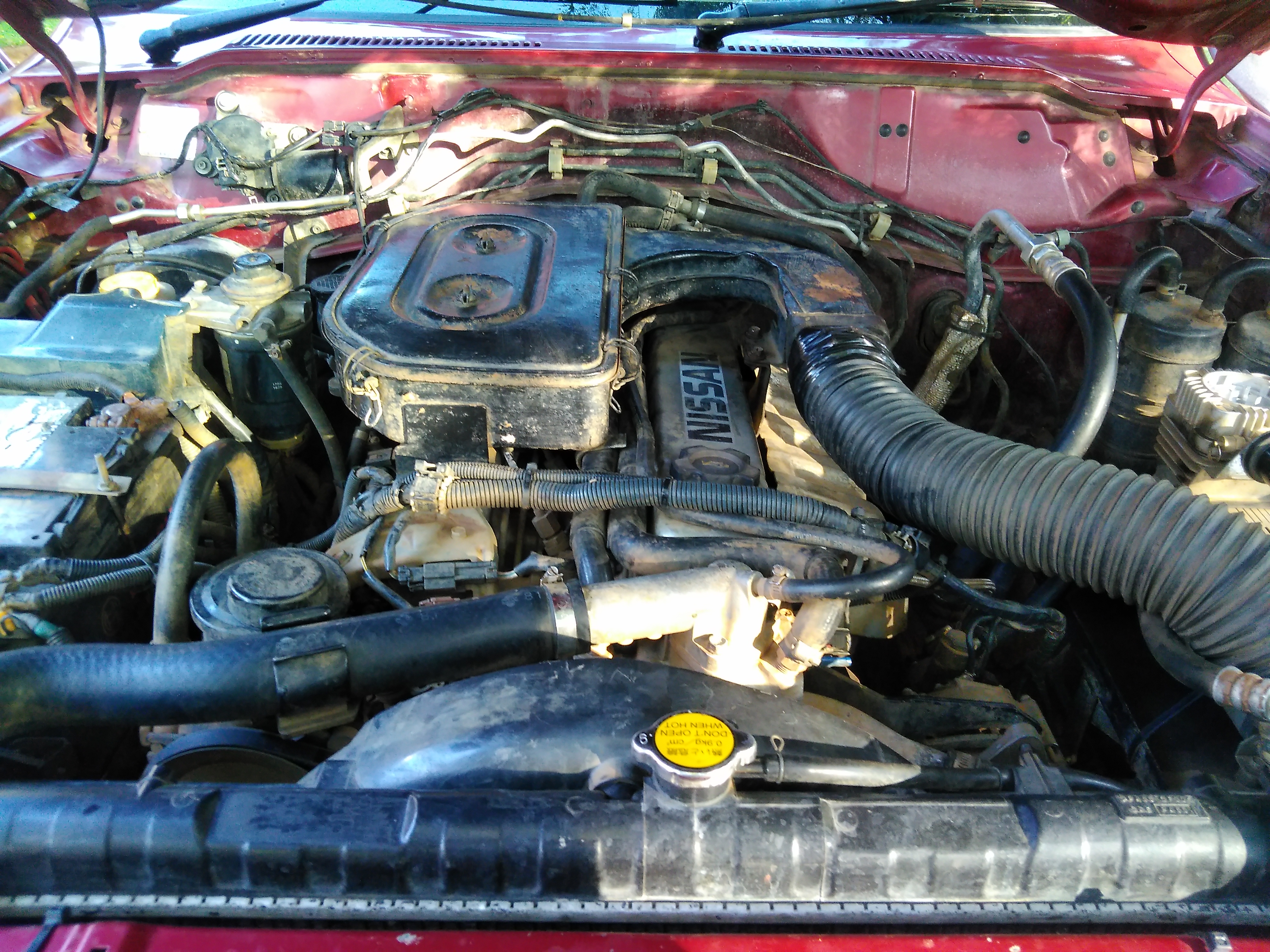

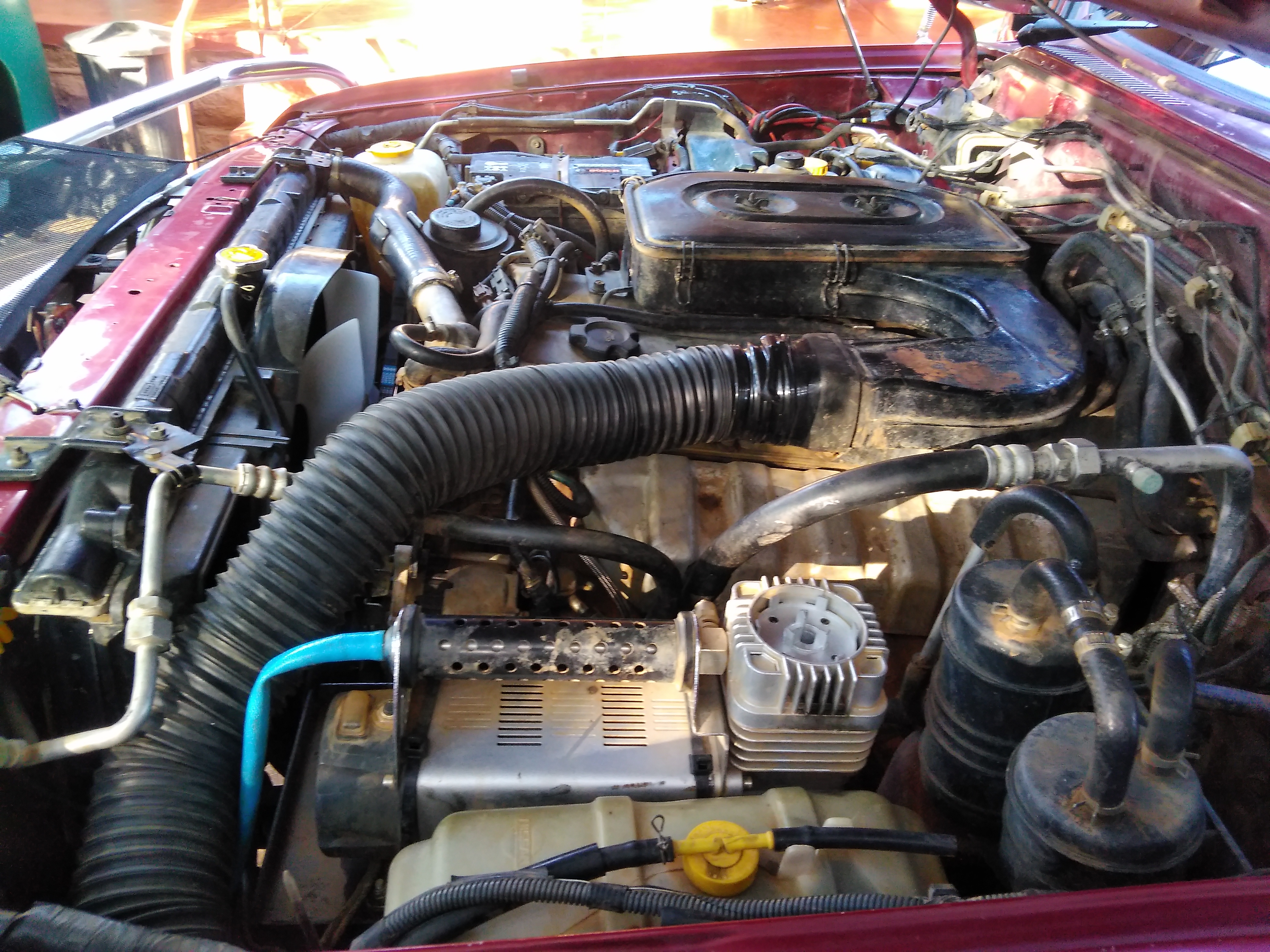

I have a sneaky suspicion that either your Patrol was one of the first GU (Y61) Patrols here in SA that landed up with a ( dare I say it.....) silvertop TD42 motor in, but this I think is VERY unlikely, or the original motor was changed and a (GQ) td 42 motor was fitted into that Patrol. This makes VIN number checking a waste of time unfortunately. Take a few pics of the engine bay from all sides as well as a clear photo showing the bottom radiator hose, as this is way different between the GU ( Y61 ) and the GQ (Y60 ) and post them here so we can have a look. We should be able to see the subtle differences to confirm this.

ricster wrote:I have a sneaky suspicion that either your Patrol was one of the first GU (Y61) Patrols here in SA that landed up with a ( dare I say it.....) silvertop TD42 motor in, but this I think is VERY unlikely, or the original motor was changed and a (GQ) td 42 motor was fitted into that Patrol. This makes VIN number checking a waste of time unfortunately. Take a few pics of the engine bay from all sides as well as a clear photo showing the bottom radiator hose, as this is way different between the GU ( Y61 ) and the GQ (Y60 ) and post them here so we can have a look. We should be able to see the subtle differences to confirm this.
OK chaps, took a few pics.
Tour de Frans reckons its a silver top.
