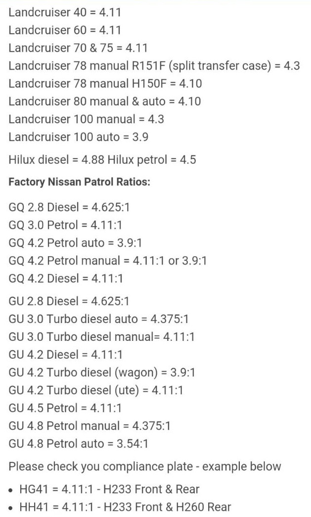

hugejp wrote:Hope this helps...
Patrol Ratios.jpg (150.22 KiB) Viewed 10610 times
Can someone explain this to me
It says that the 4.8 manual uses the 4.375 ratio, while the auto uses the 3.5 ratio.
That is a heck of a difference, for the same engine, almost the same gearbox ratios, and same weight?
Posts: 2671
Has thanked: 61 times
Been thanked: 258 times
Re: Diff ratios
I just realised,
the gearboxes cannot have the same ratios.
That is probably were it evens out again.

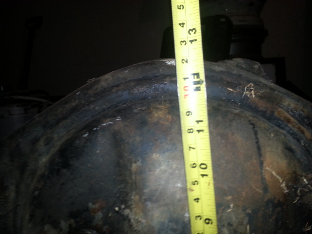

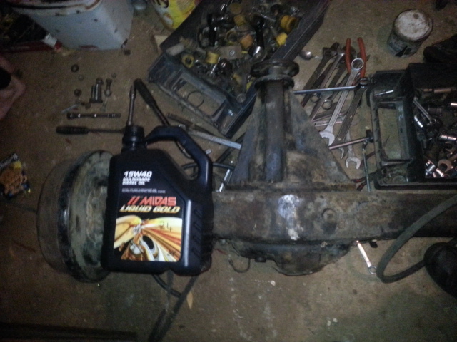

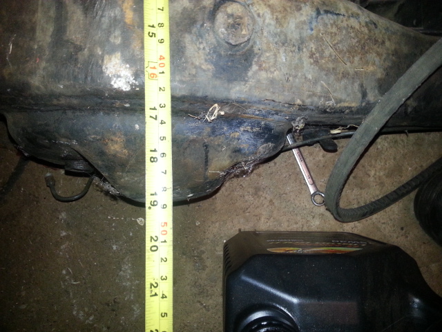

Re: Diff ratios
Post by davidvdm »
davidvdm wrote:
Wilkie wrote:its big..
My wife says the same thing.... But compared to what??? :lol: I'll go measure the Sani's H260 pumpkin and then you can compare :wink:
Pumpkin is around 320mm high and from pinion to back of pumpkin it's around 480mm.
This thing is Beeeeeeg and heavy...
