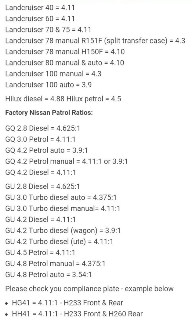

Hi guys,
Is there anyone who can give me some info on the standard diff ratios used on the different Patrols? Does anyone know the ratios for the 4500 and 4800 and the GQs especially the 4.2 petrol?
Thanks in advance
Thanks in advance
Re: Diff ratios
Hope this helps...
- Patrol Ratios.jpg (150.22 KiB) Viewed 11896 times

Got this from Graham (G-tech) a while ago.
