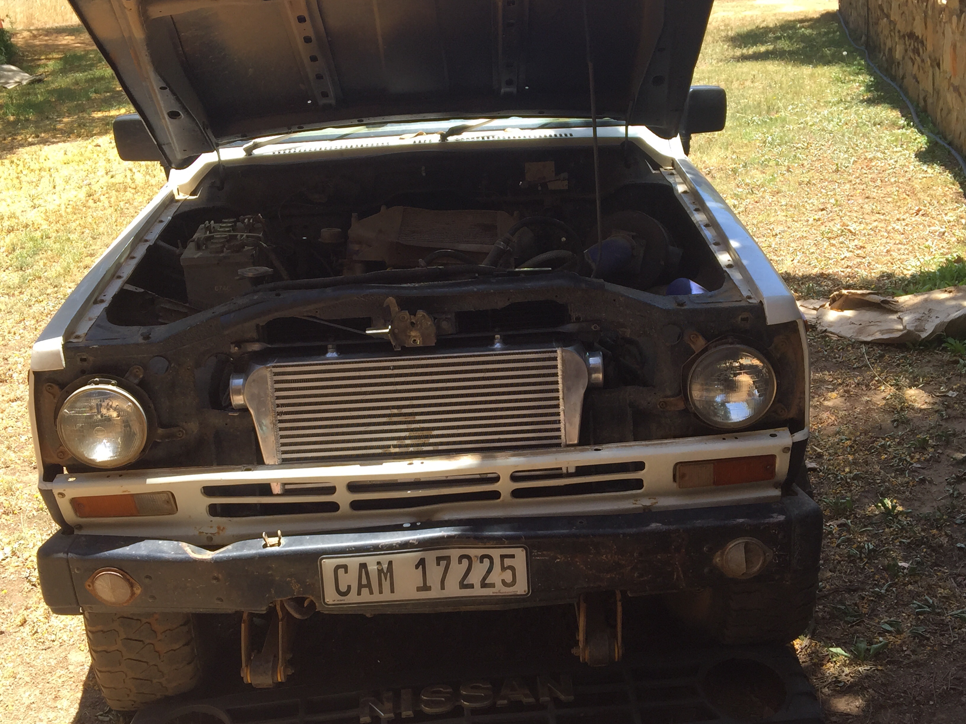

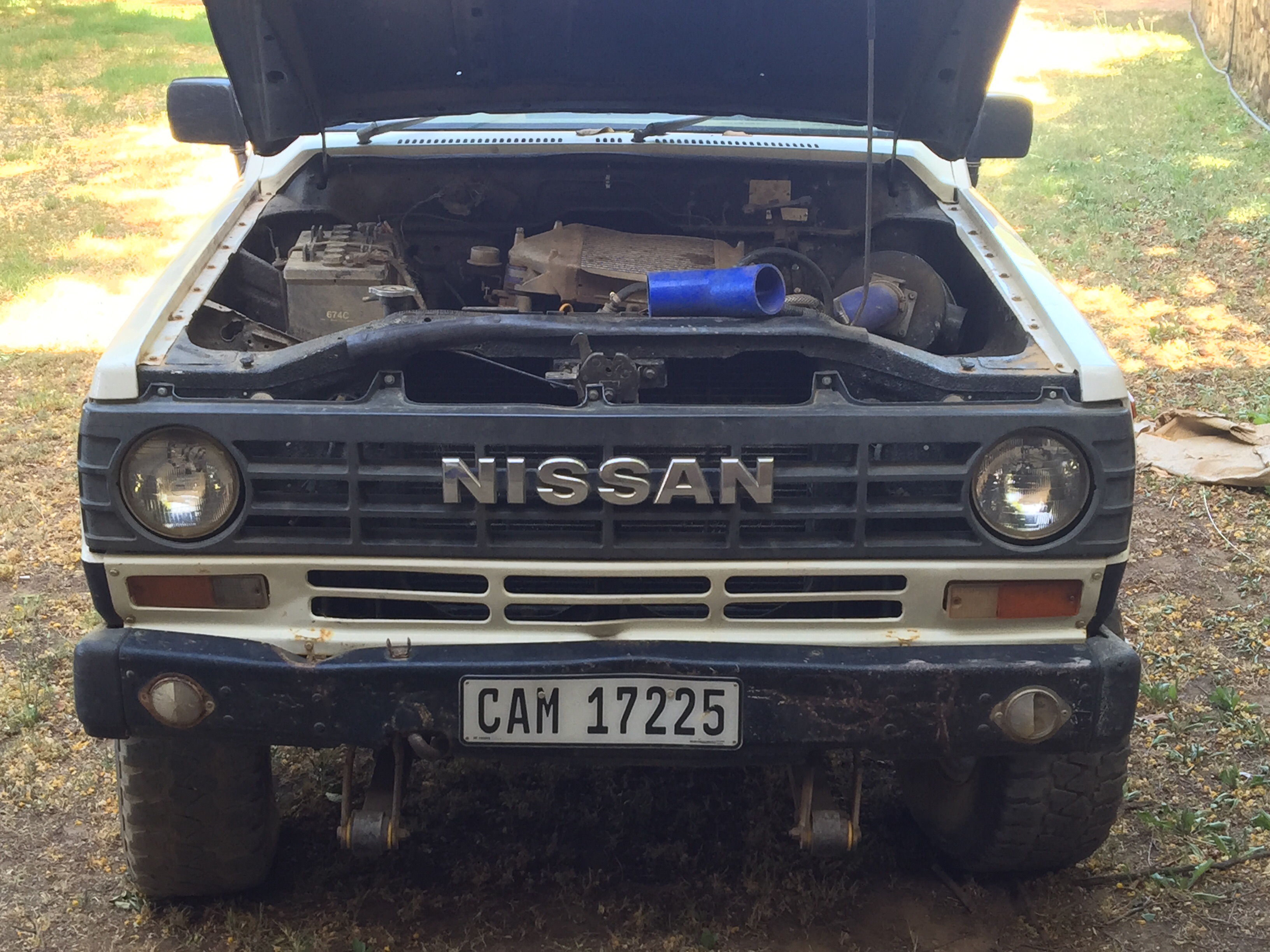

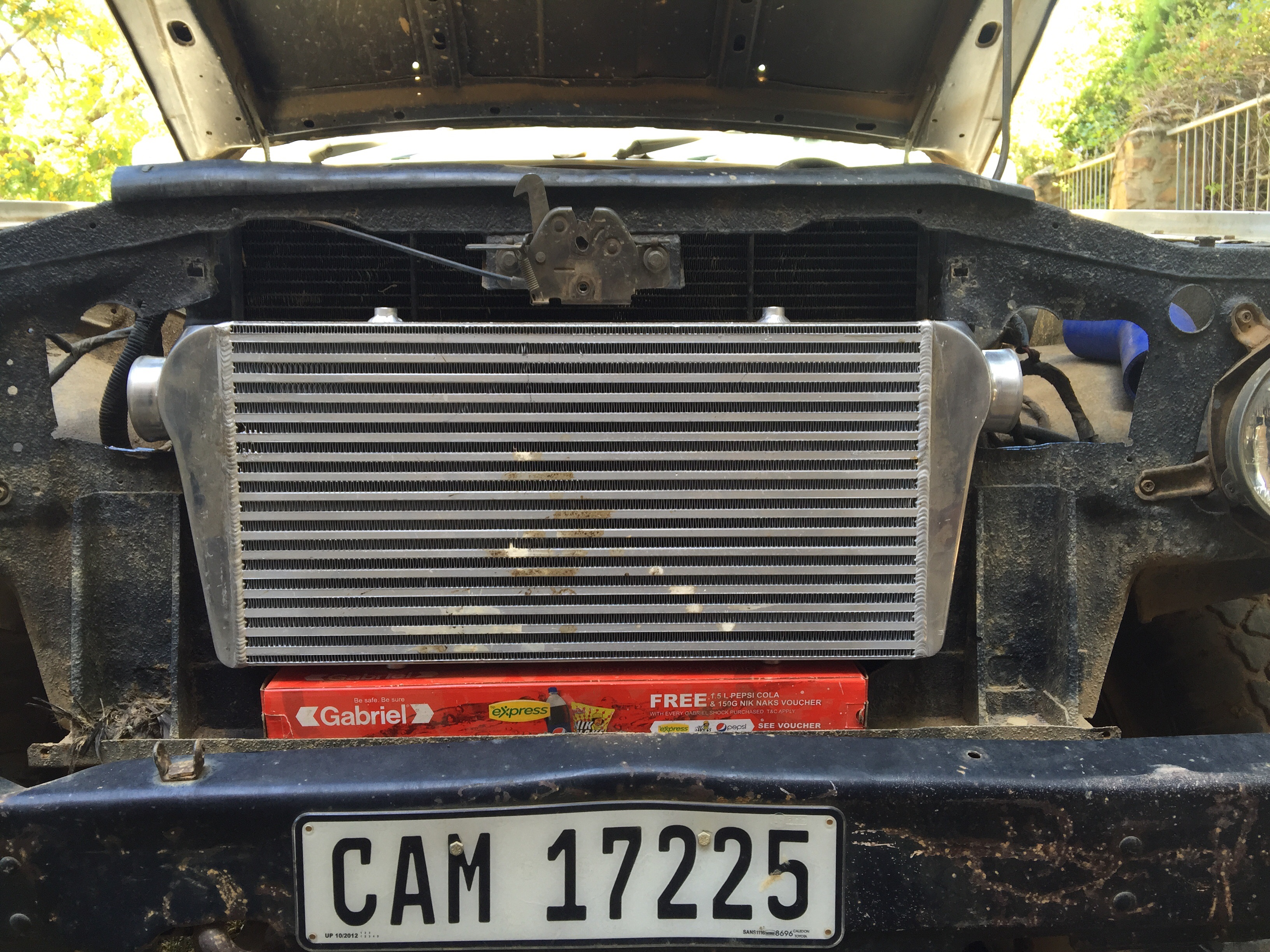

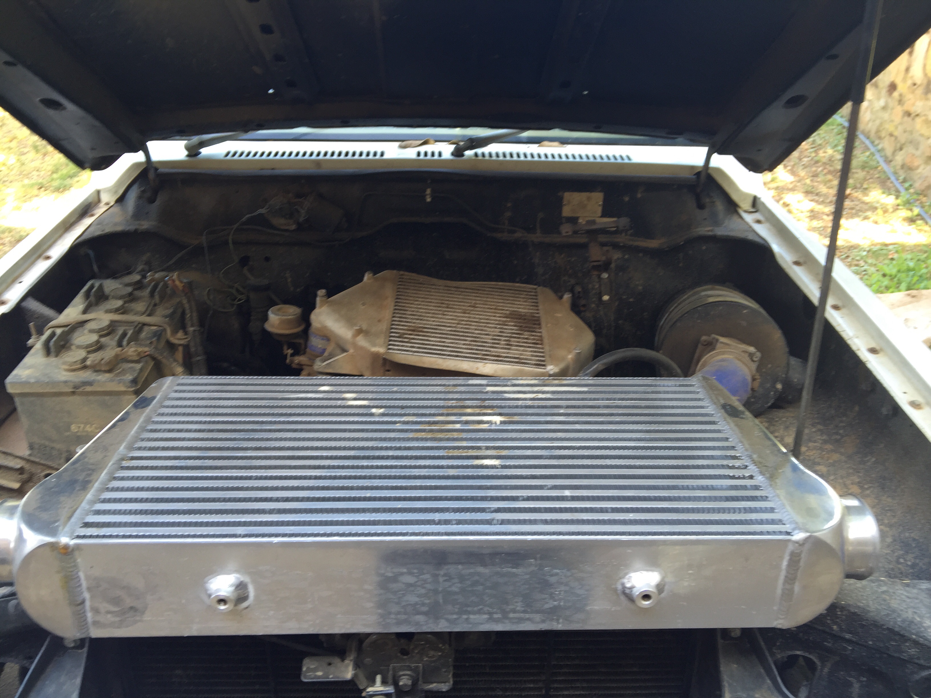

Re: 1984??? Safari pickup build
Post by Reenen »
Groter intercooler ingebou.
Pas perfek, kan niks sien van buite.
600x300x100mm
Been thanked: 432 times
Baie mice Reenen, dis n mooi size cooler daai!
