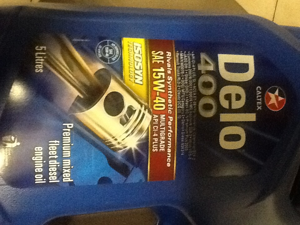

Hierdie een gekoop:Kagiso II wrote:oompie hoop jy het die Delo 400 LE gekoop ?

- image.jpg (208.41 KiB) Viewed 5911 times

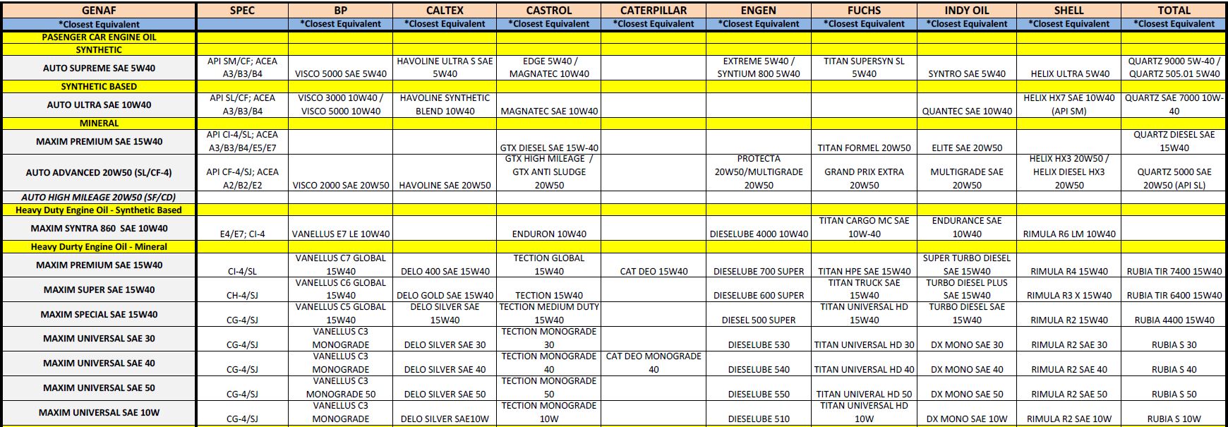

Hier is n baie handige "Oil Equivalents Chart" om mooi die verskil te kan sien tussen die verskillende olies
Oil Equivalents Chart.pdf
- (70.7 KiB) Downloaded 373 times
- Been thanked: 432 times
Re: Best Oil - TD4.2Ti High Mileage
Hier is die kort weergawe
- Oil Equivalents.JPG (292.56 KiB) Viewed 5907 times

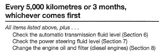

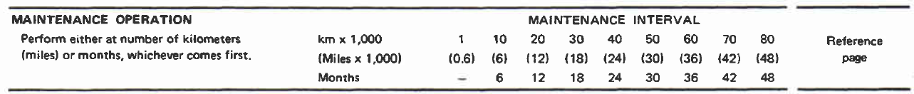

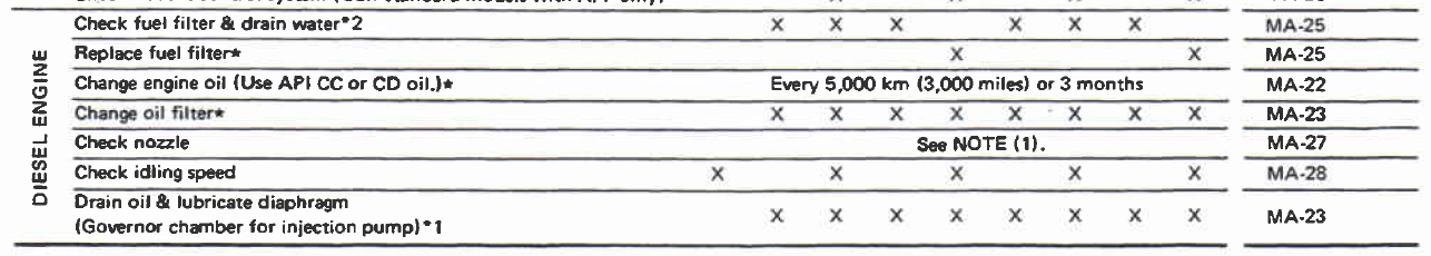

Nissan and Haynes agree on the regular 5000 km oil changes for our old TD42 diesel motors:ricster wrote:I do mine every 5000Km, with new oil filters.
