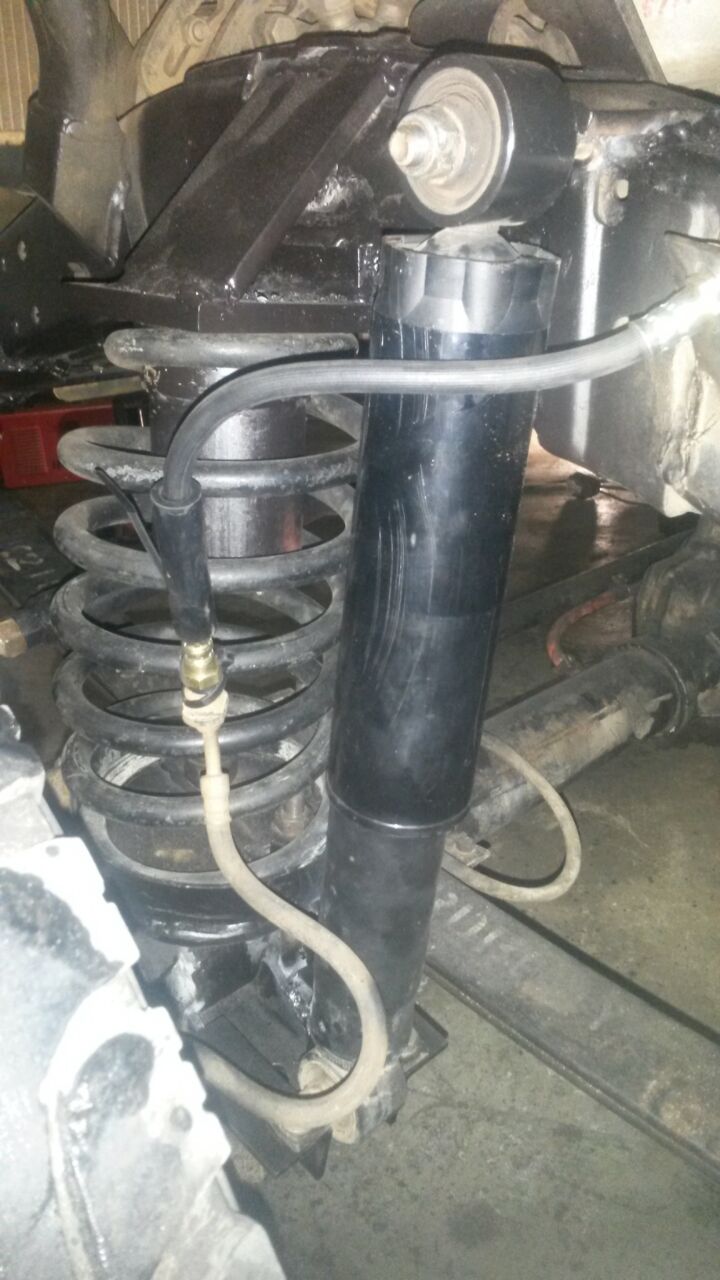

After all was in, we managed to keep the lift from original IFS hight to a mere 130mm. Our one problem that has now haunted us, is that our Castor has gone to 7.5deg. With the backside still running standard height (130mm down), the Castor is as 9,3deg.
Yesterday it looked like we were nearing our goal. We got our brake lines extended, and steering arm off the top kingpin position built and a steering arm from a new Pitman arm off the steering box.
A set of second hand Landy D2 shocks was donated by a community forum member, but we realised we were not going to have time to get that installed last night. But as the excitement of having a car that could actually steer and brake, we could not contain ourselves to take it around the block.
With the backside hanging it feels nothing but weird. It's a boat at the moment without shocks (I am hoping the shocks sorts some of the rocking out), but what caught me out, is the death wobble that started before I even got to second gear.
I believe we have some bearing and seals issues on the new diff. The Birfield on the left wheel is leaking diff oil, which means the seal between the tube and the Birfield knuckle is shot. The diff oil will be washing the grease in the Birfield by now.
I think a total recon of the Birfield/wheel bearings and seals is in order.
We are busy with shock mounts as we speak, to get the D2 shocks mounted and see if it in any way fixes the DW I experienced last night. I can't imagine our geometry can be so stuffed up that we have built a DW machine.
I will post some pictures later..

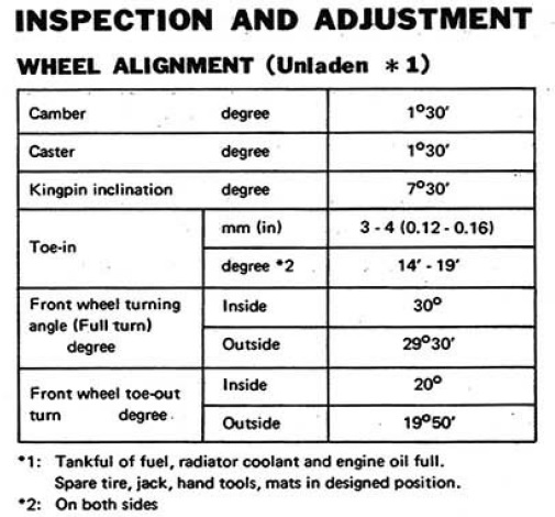

Something I found in the manual..
Seems the Kingpin angle which I thought was the Castor angle is not the same thing. Off the top of the Kingpin I am presently at 7,5Deg which seems to equate to around 1,5deg Castor.
I am going to copy and paste my posts off the community forum so that the info is the same on all the sites and the guys can see the process we have been through and where we are at.

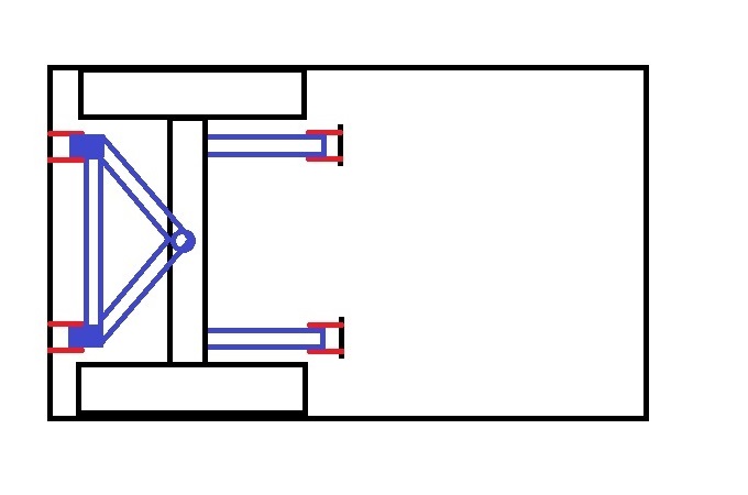

I have been on the drawing board. I know I need to contain axle wrap as well, so was looking to do diff location (panhard) at the same time with the same arm.
I have the forward leaf perches in place that offer wide mounting for two of the four link arms needed to come together on the diff for sideways location as well as contain axle wrap. Then the remaining rear mounts for the radius arms to locate diff from front to rear..
This is what I have in mind...
Here is my problem http://youtu.be/E64fBqAnjXU
We are on our way to put the other two blades back into the pack. If it gets the front stiff enough side ways, I can live a bumpier suspension. It would be a shame though, as the ride is actually softer than the IFS was.

This, in conjunction with the existing steering linkage will give you SERIOUS bump steer, and contriving a steering linkage that will prevent that will be very tricky.
To prevent bump steer with the existing steering linkage, the axle needs to move sideways a little bit as the body moves up and down. Effectively, this requires a panhard rod of almost exactly the same length and agle as the drag link.
If a linkage like this is used (and I reckon you can just use a single tri-angular link at the top, as the leaf springs will take care of the bottom), then you need a steering linkage that does not move the hub ends sideways as the axle moves up and down. The only such I have ever seen was fitted to a live-axled racing buggy, and consisted of a bell-crank mounted on top of the axle tube, which relaid the steering backwards to a steering box which was turned through 90 degrees so that the pitman armed moved forwards and backwards.
Furthermore, the linkage you have drawn will have a very strange effect on caster angle, and odd stresses on the springs.
Hope this makes sense?
