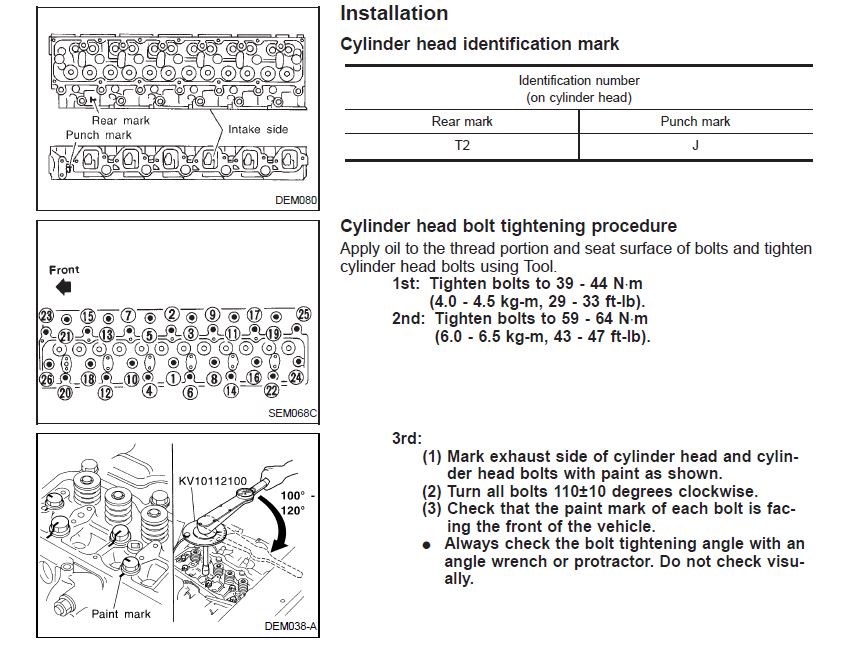

Here are the torque specs for the TD42T engine that I found on the net, would like to compare with ricster's manual
- Torque prosedure.JPG (121.81 KiB) Viewed 7296 times
Re: TD42 engine assembly
Micheal.... That looks like the correct settings. That 110 deg +/- 10 deg is the real bliksem, but you then know exactly that the torque is right. cause if you don't do that final turn when using a torque wrench in one fluid movement, you then may get the torque wrench clicking before the correct torque is reached. Trust me here, but its not always easy to do it in one fluid movement. By doing it this way you can see exactly how far the bolt has turned..... Piece of mind is a fantastic reality !!!

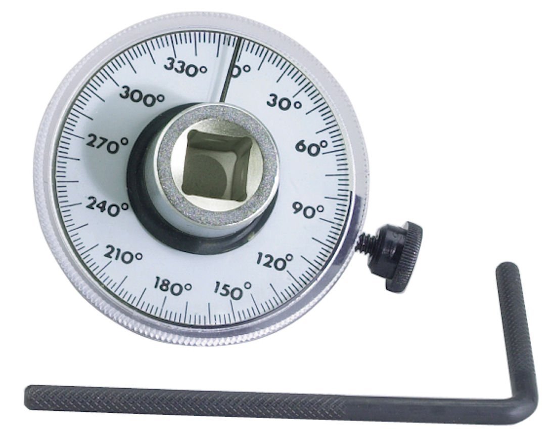

I would recommend one of these when torqueing the head. I think any decent tool place will sell one
- angle torque.jpg (90.86 KiB) Viewed 7290 times

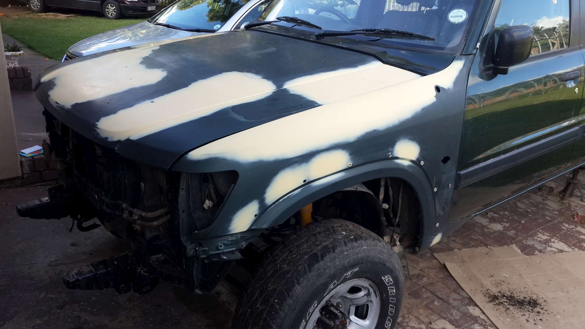

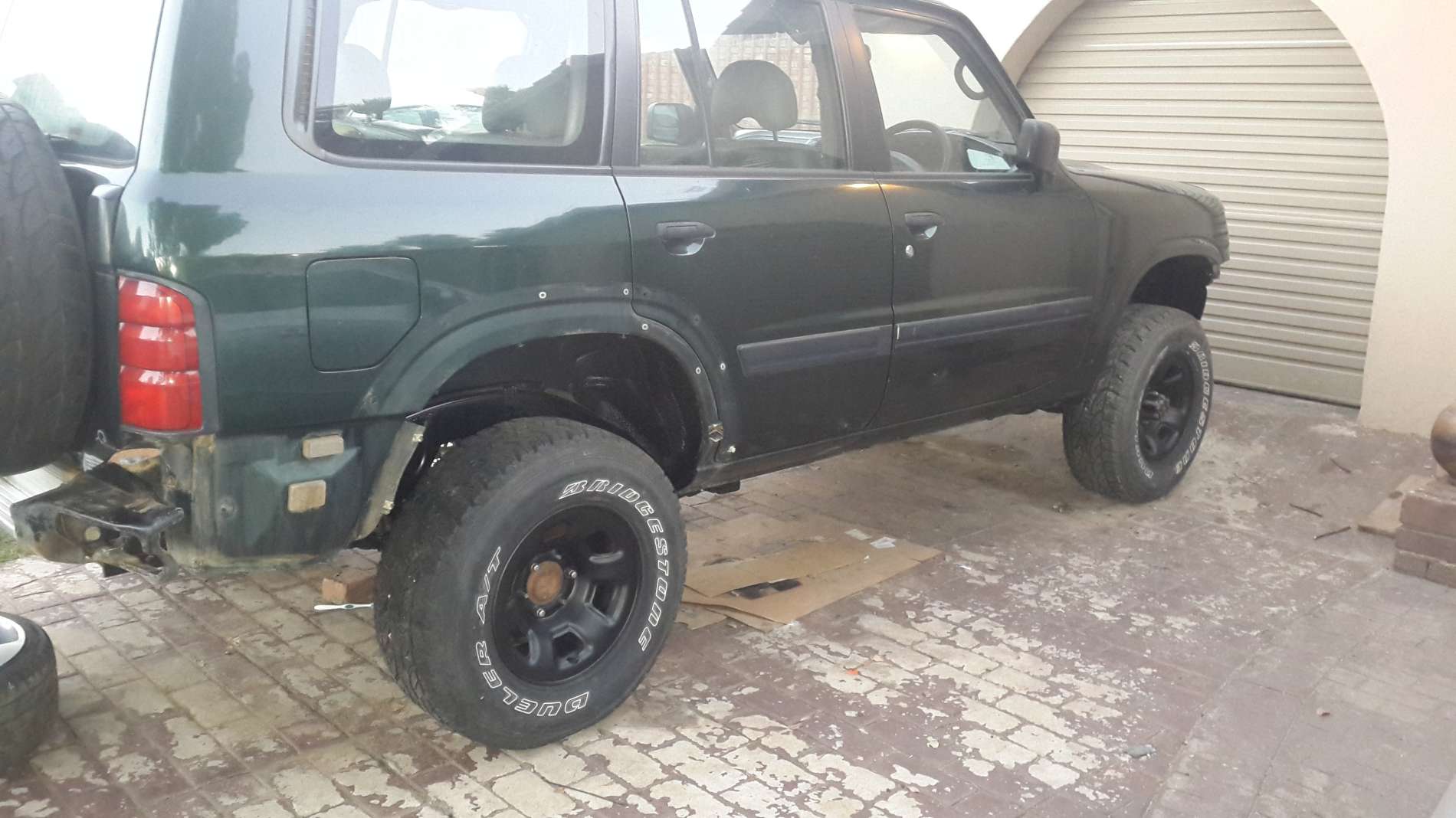

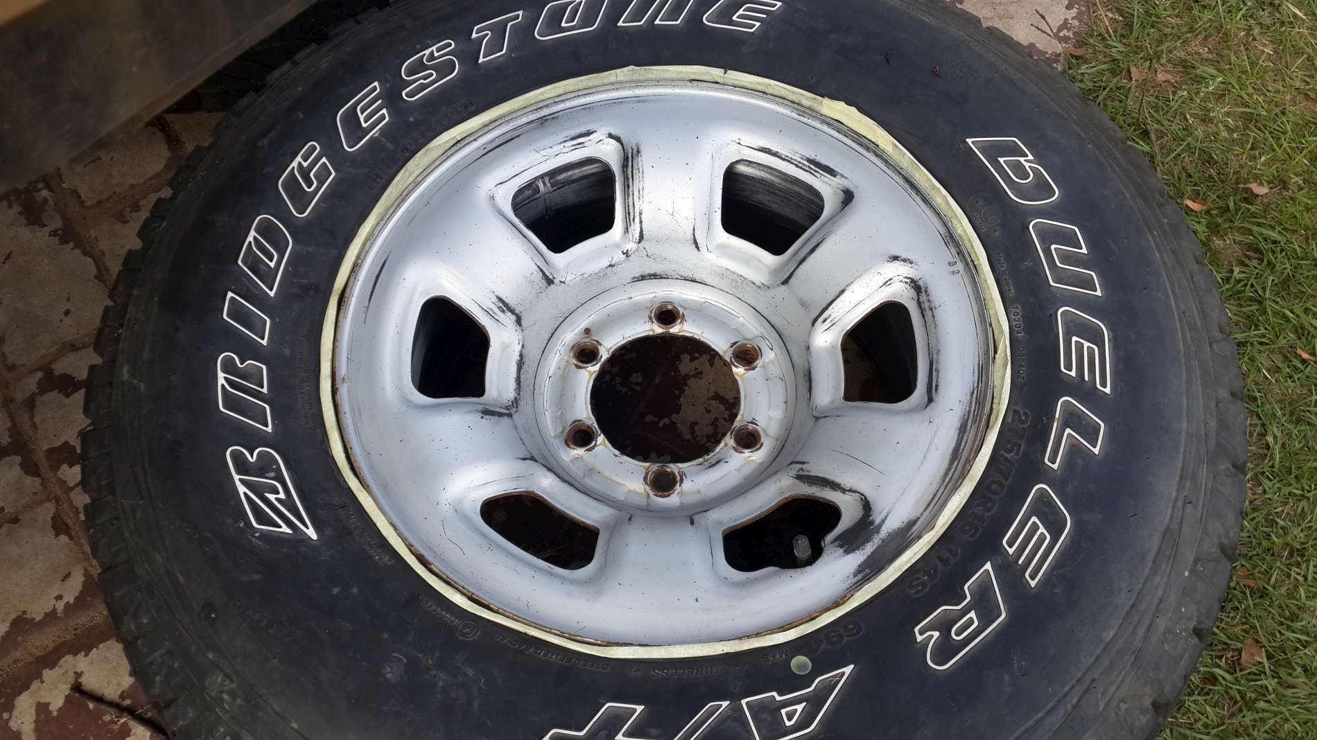

Ek het oor die naweek nog so bietjie werk aan die Patrol gedoen.
Ek het die neus oor geverf omdat die verf baie beskadig was en die bonnet n klein duikie in gehad het....... toe verf ek sommer die rims ook
- body_7-1900.jpg (156.33 KiB) Viewed 7260 times
- body_9-1900.jpg (208.08 KiB) Viewed 7260 times
