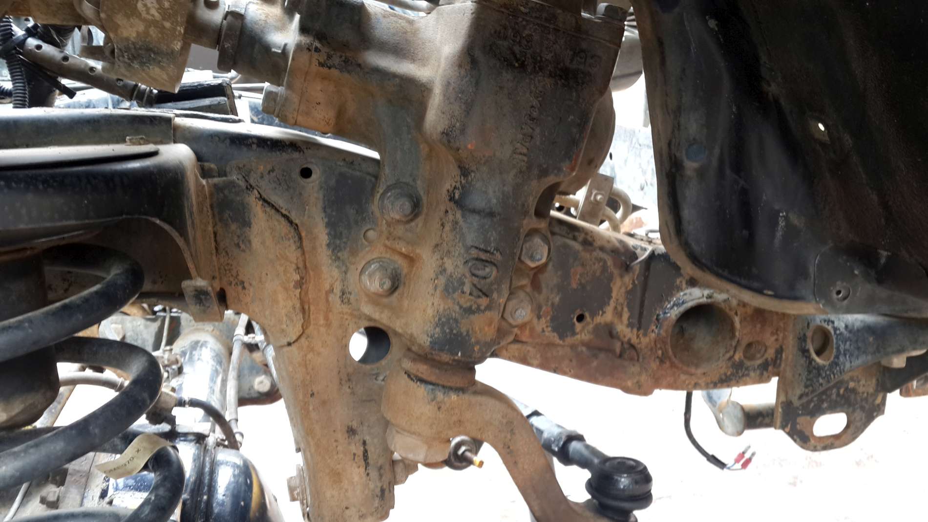

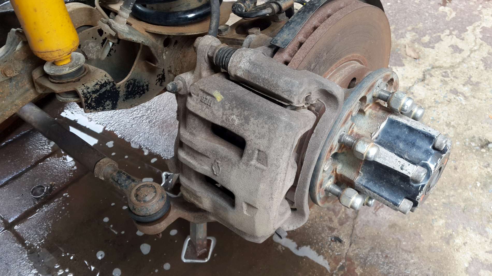

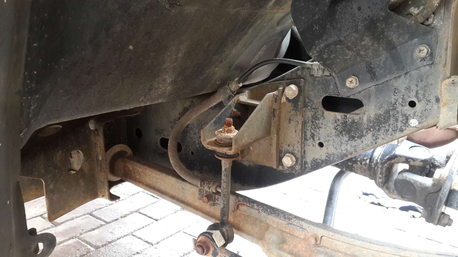

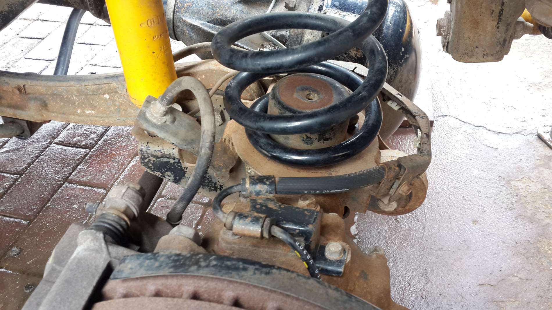

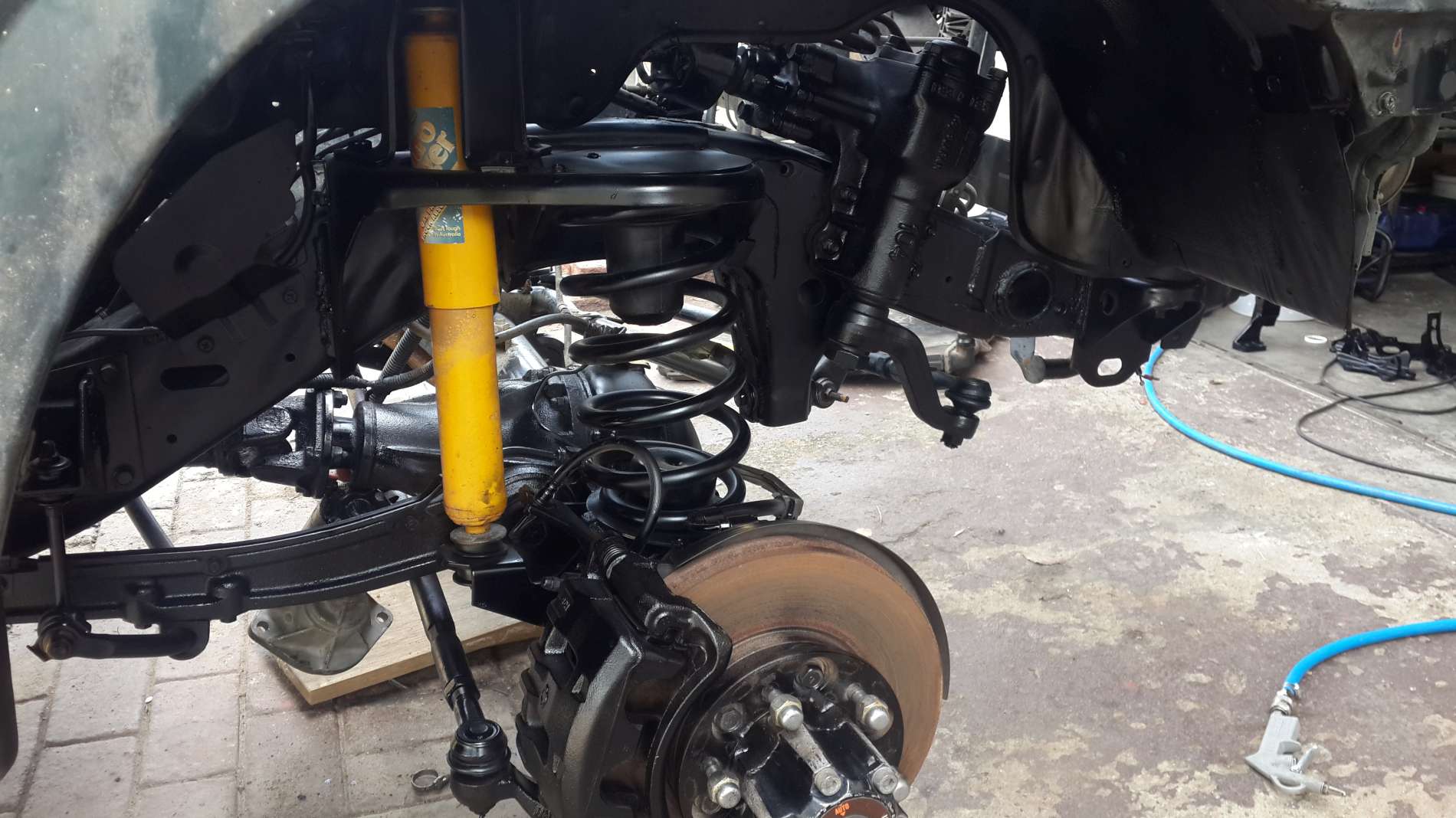

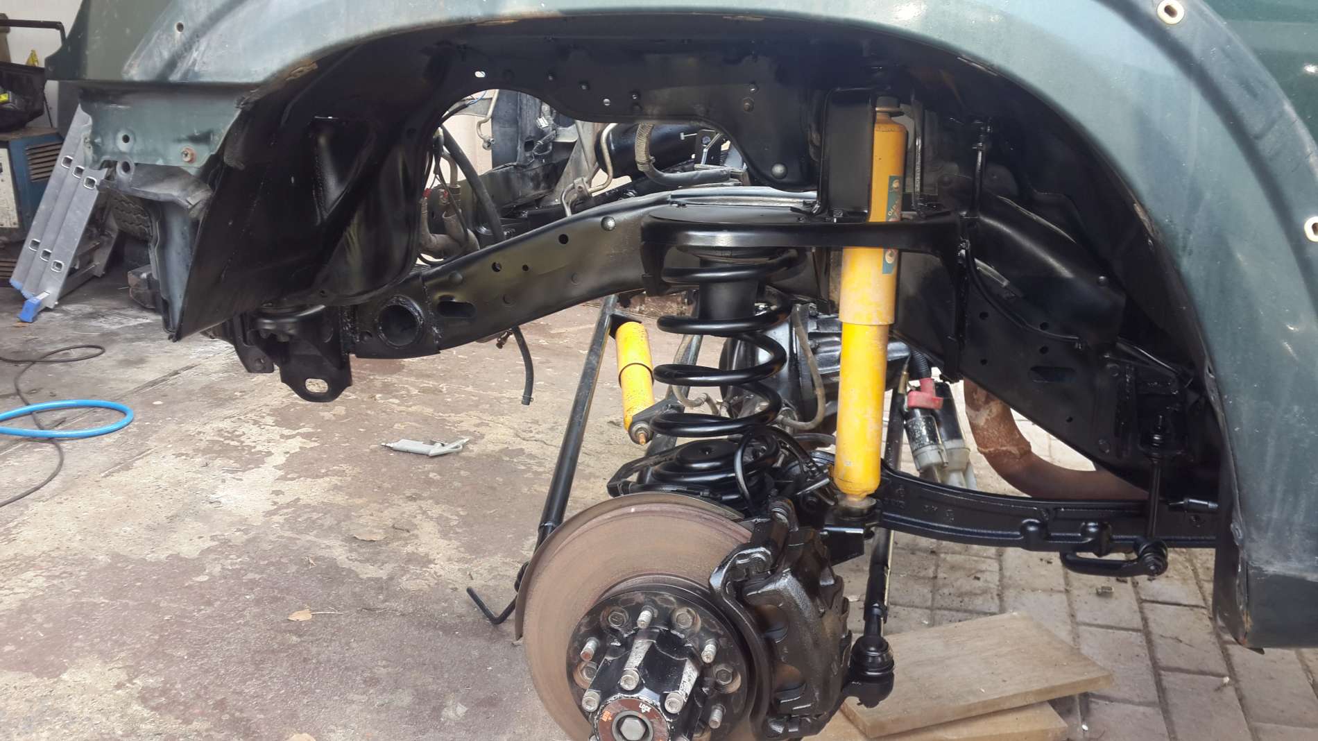

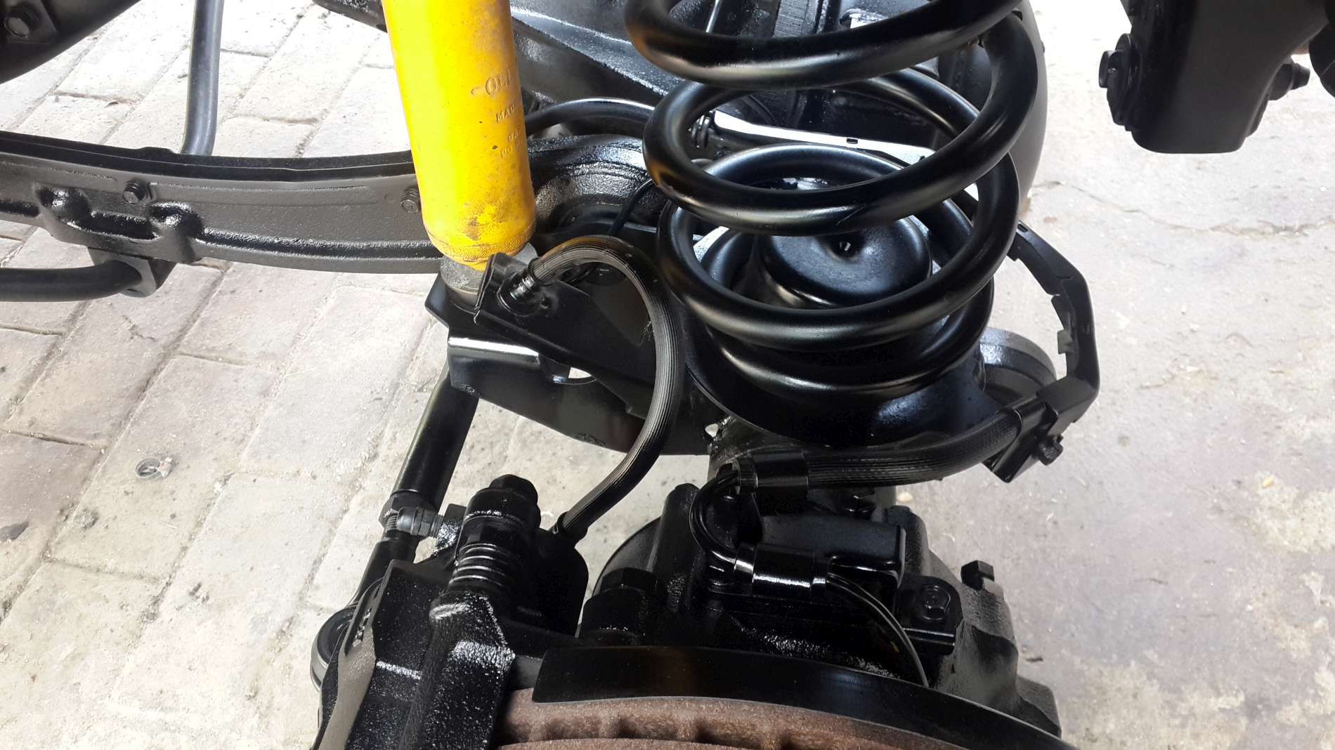

Here are some before and after photos of the progress on the Patrol.
While I am waiting for some engine parts I started working on the suspension a bit, getting it clean and giving it a new coat of paint.

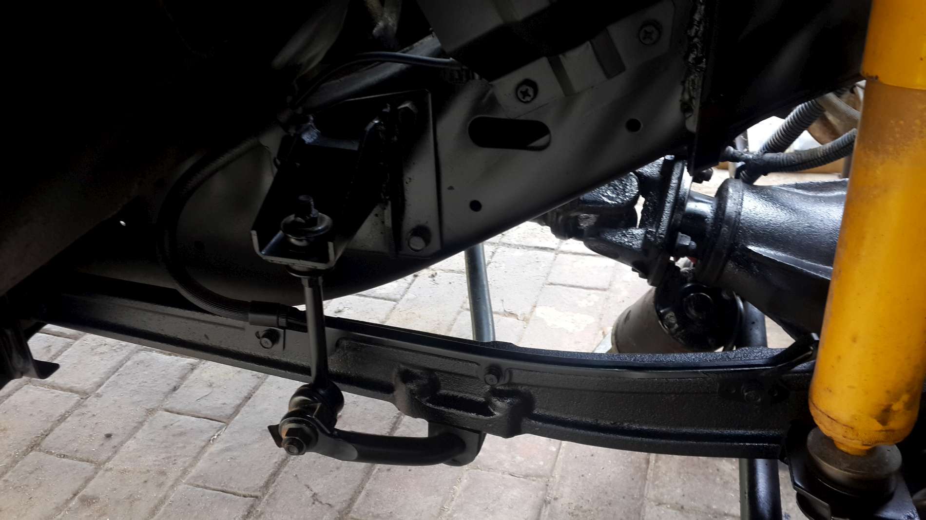

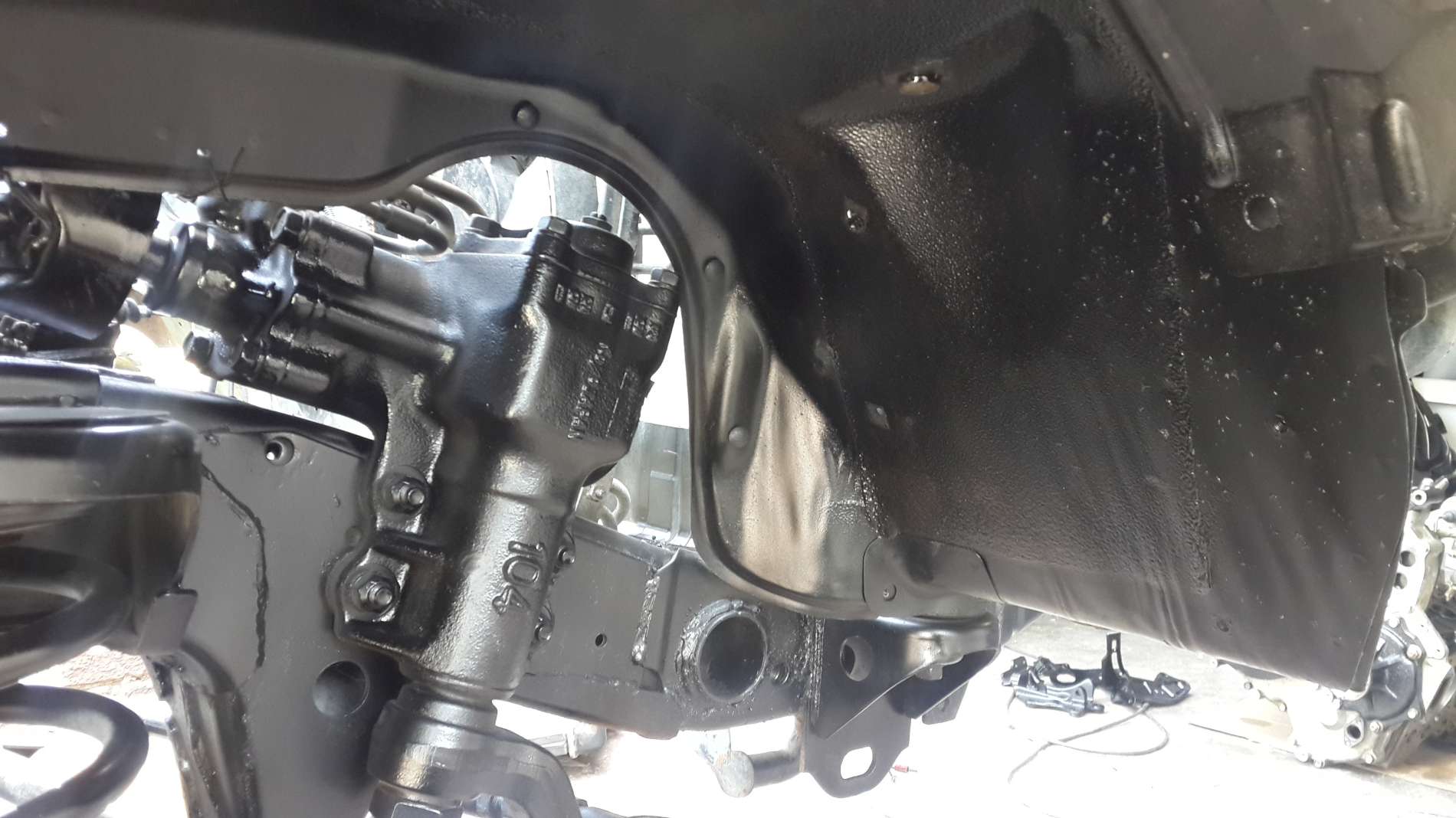

And some after.....
- suspension_12-1900.jpg (196.19 KiB) Viewed 9233 times
- suspension_11-1900.jpg (188.06 KiB) Viewed 9233 times
