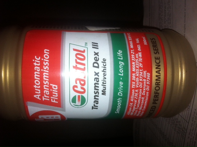

Tinus lotz wrote:I added 1liter atf to my gearbox and 500ml atv to my transferbox and it works great now sincro works better....and then fill up with gl4 75w90
Ek sien Dex III is 'n ATF? So indien ek nie genoeg het nie (het 1.5 liter), kan mens met GL4 75w90 vol maak?
Of sal 1.5 liter genoeg wees? kon nie 'n direkte antwoord kry op hoeveel nodig is nie, maar het errens gelees dat 1.5 genoeg is... (maar is nie meer seker nie).
Dis seker te laat vir my om nou hieroor te wonder, aangesien ek nou besig is om die transfer case olie te dreineer... :lol:
(het op ausie patrol forum errens gelees dat dex 3 beter werk indien mens auto locking hubs het, gl4 beter vir manual.... maar ja, sal nie weet nie... kan nie nou die link kry nie..en het werk om te doen :wink: )
Anthony Forgey wrote: I really struggled. Ended up buying from 3 different places, and DEXIII only in 0.5L quantities. The liquimoly was expensive too :eek:
I also only got the half liters....this is what I got: How much did you end up using?

PS. dit wil voorkom of my transfer case oor vol was. toe ek die boonste plug los gemaak het die olie begin uit loop..(en redelik baie) :think:
Posts: 3328
Full Name: SJC
Has thanked: 237 times
Been thanked: 203 times
Re: Gearbox oil - Which would you choose right now?
1.5 liter was genoeg... :thumbup:

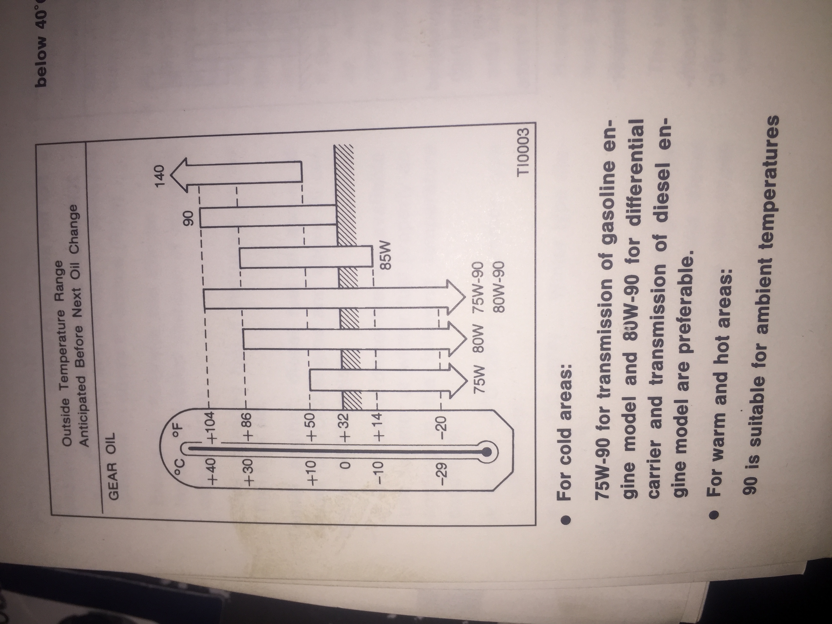

Anthony Forgey wrote: 24 Oct 2016 15:11 My 4.2d recipe (aka the happy oil family)
From the left, engine oil, diff oil(both), gearbox oil, lastly, transfer case oil.
Apparently this is an acceptable brew for my patrol :thumbup:
Ant what do you use for normal diff. 80W90 GL5 or EP90?
