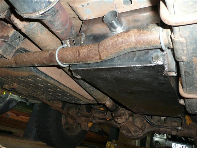

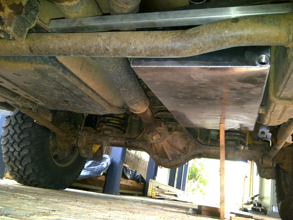

I'm busy looking into making a 50L water tank that fits in underneath the body, basically opposite the sub tank. The only thing that sits in the way is the exhaust. To overcome this problem one would need to run the exhaust parallel to the propshaft.
So the reason why I am highjacking this thread is to ask if you can see how easy it would be to make the exhaust parallel to the propshaft till it gets to where the body rises around the rear diff (behind the back seats). From there the exhaust pipe can bend to the side and up and over the diff ( similar to the existing exhaust ).
This just allows one to have the option to easily have a water tank done at a later stage if one wants to....
Here are some pics of roughly what I am busy designing. These pics are from another Patrol.
