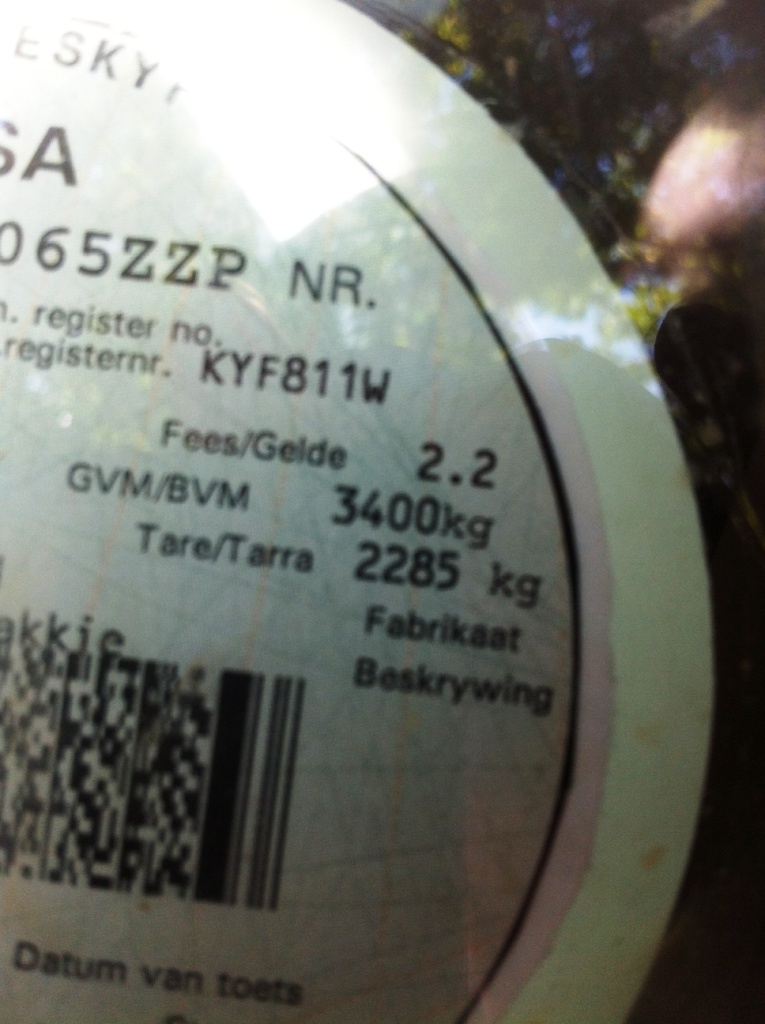

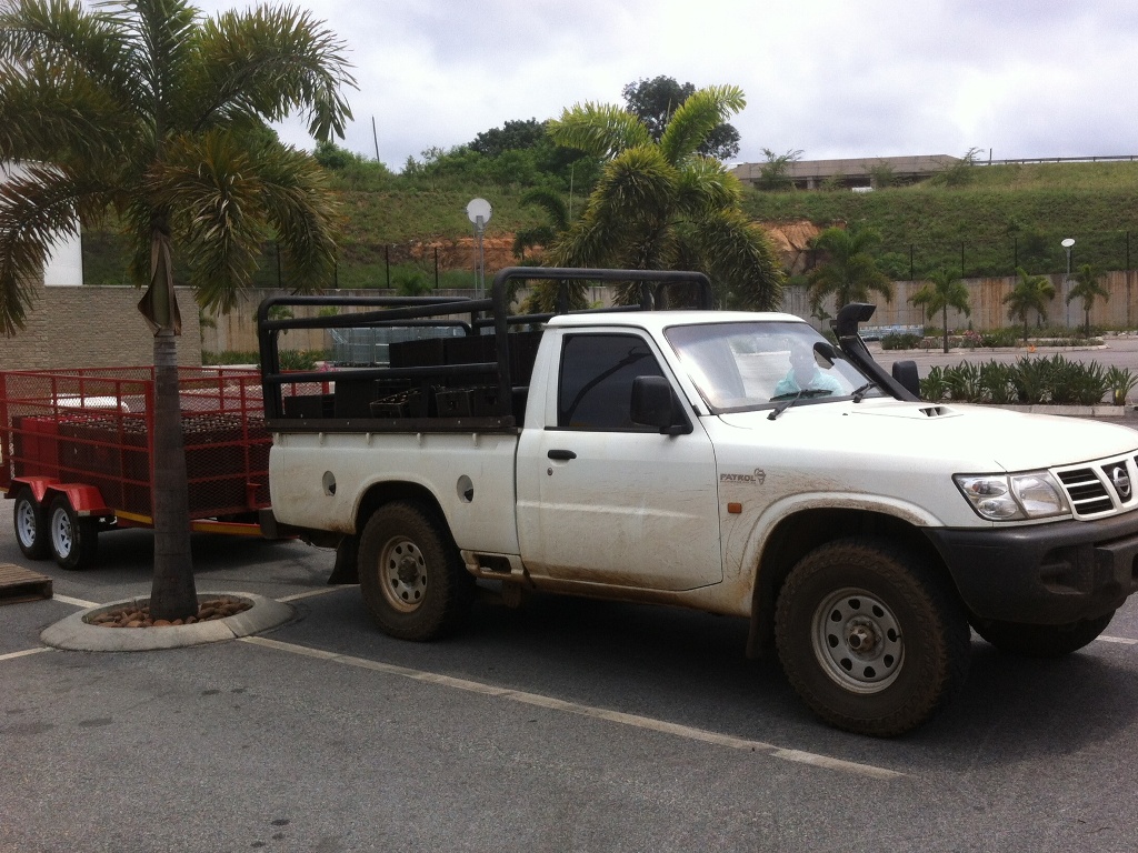

With a pickup it will be easy to go over the allowed limit.
My 4.2 pickup's tare is 2285kg, gvm is 3400kg.
So with full tanks 175l of diesel, cattle/hunting frame, replacement bumpers, 100kg driver, co-driver, etc. you could easy add 400-500kg to the vehicle without realising it. And then if you load 65 cases of courts(I did this the other day
), that is another 1100kg.
That will give you at least 3800kg in total.
