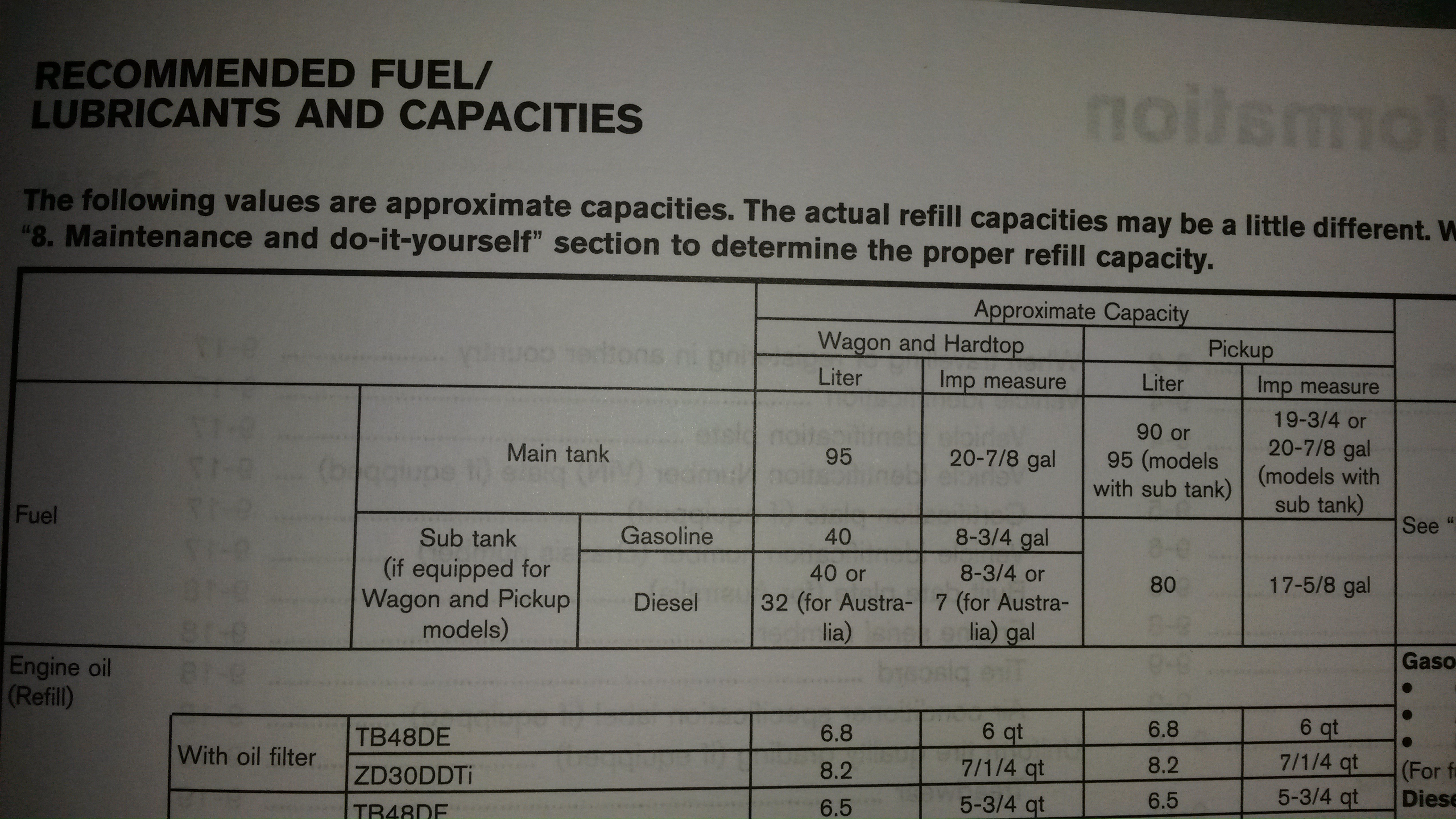

Re: Sub-Tank Capacity
This is from the manual I got with the car. Maybe you guys with the smaller sub tanks have an Australian version.
