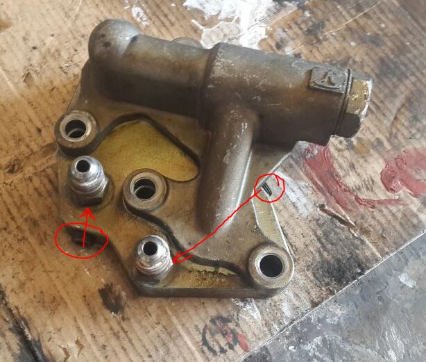

Just by looking at it, there is something strange happening with that plate. There are 2 fittings on that plate, I assume one for oil in and one for oil out. There is no exit hole on the flip side of that plate, so that means that there must be a chamber or channel in the plate that connects to each one of the round sections where the recesses are. If I recall there are 2 blue "O" rings that fit into that recess creating a seal between the pressure regulator and the engine block, so that would probably mean that there is an opening somewhere on this plate ( on the inner diameter of the recessed "circle" ) to allow oil to flow into the chamber or channels and out to the external cooler and then back to the plate inlet, back in through the chamber or channel and then on to either the block or the pressure regulator, depending on which way around the oil cycles.
I would think that the size (volume of these chambers would be fairly important to get the max efficiency. Michael, Give this goodie a good going over if possible to see what where when and how. One can reverse engineer a "sandwich" plate to do exactly that but that to me seems like re-inventing the wheel, as one can just buy sandwich plates and an external pressure valve from most turbo shops etc that fit between the 2nd oil filter and engine block ( internal oil cooler ). I don't think that it would be any more cost effective time wise to draw up a CAD model and get he lazer cutting and milling work done plus the 2 extra "O" rings..... but that is just my opinion,

Cedric, yes there are some holes drilled on the side that connect the two. I will try and indicate on the below pic.
The holes that were drilled are just blanked off via small bolts which you can see in the pic.
Oil Filter adaptor.JPG (73.34 KiB) Viewed 3718 times
So the reason why I like this setup more than the sandwich is that it is far away from the water system and it sounds like the oil pressure is higher where this plate sits which means you should get a better flow to the cooler (also I'm not 100% sure of this tho).
See I don't like the standard oil cooler system as the water is mostly warmer than the oil which means the oil is actually been heated by the water and not cooled. Now the sandwich adaptor is so close to this setup that it might influence it in some way.
Also, I have read how some people did not get significant improvement with this setup as the pressure is too low there.....not sure how true this is and know of no one with this setup that measures the oil to confirm that the oil is actually cooler than usual.
Basically, I just wonder why UD has chosen this setup instead of the sandwich?
