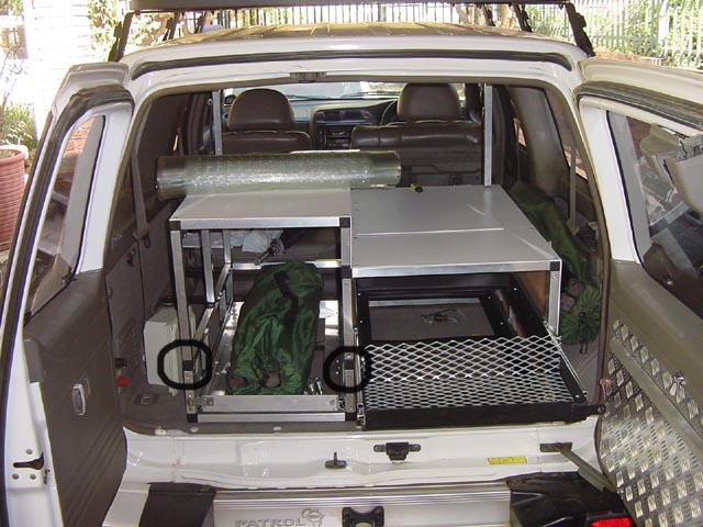

I don't have drawings for my system but I would change a few things if I had to redo it. The joints marked on the photo (on all sides as well) is not necessary and one could use a continuous piece of tubing running down.

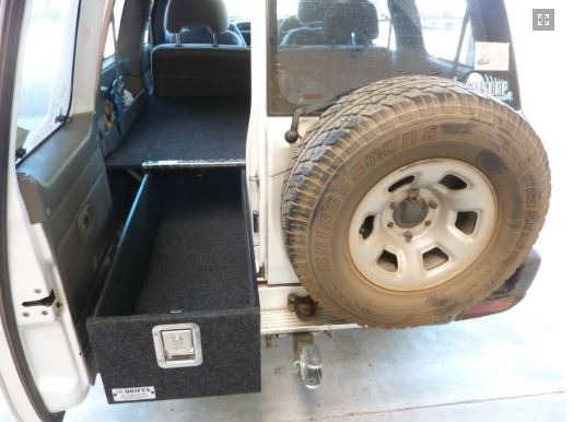

I started this thread almost 2 years ago and made 0 progress. But a new troll and a big trip coming up in April have spurred me on.
I found this idea and wondered if anyone had done it? This is definitely what i want to do.

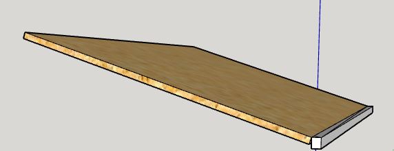

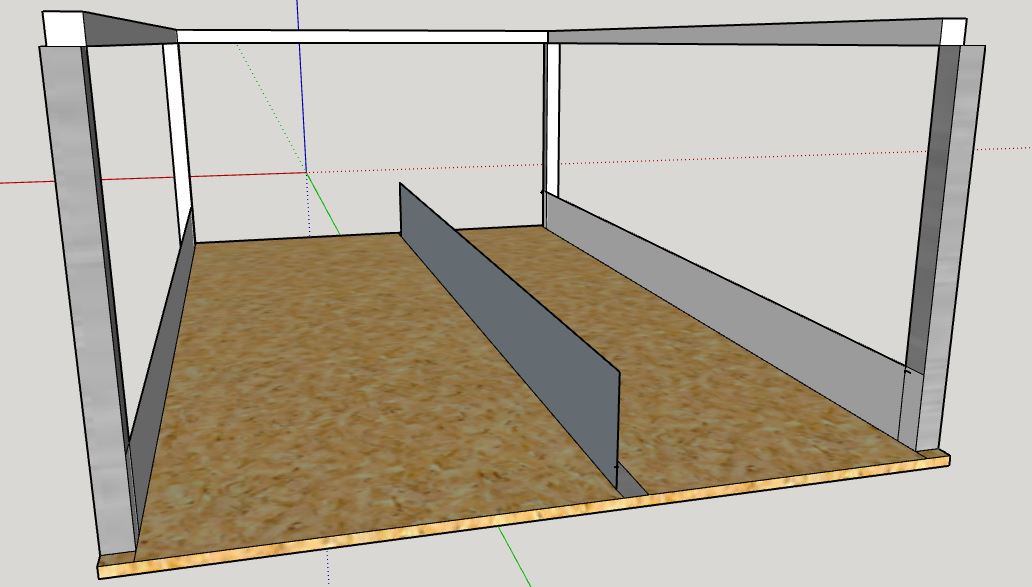

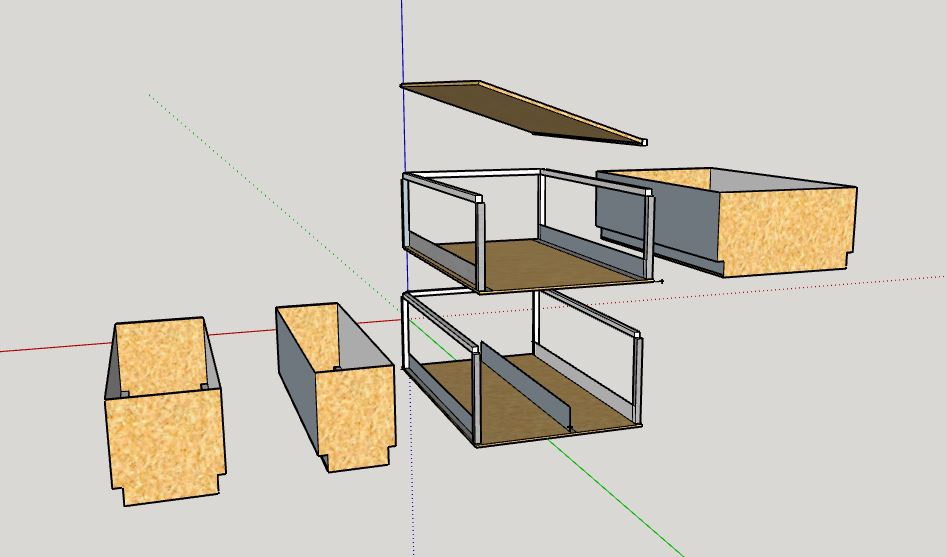

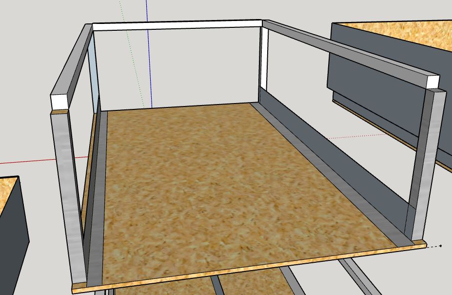

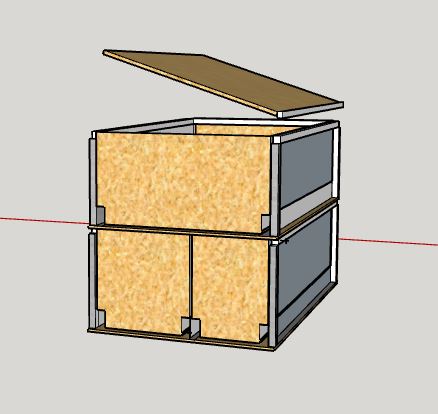

So after discovering Sketch-Up my plans have surged ahead. Construction is 19mm aluminium square tube and "connect its", aluminium sheet, 10cm hard board/ ply, and aluminium "angle iron"
It is a modular unit that can just be the bottom two drawers. The bottom drawer can open through the small barn door. Or two bottom and a big upper drawer. The hinge lid is there so you can get at stuff from inside the car. As my recovery gear will be in the drawer... I have a habit of getting myself in to a situation I cannot open the rear door (don't ask!!). Not being able to get to recovery gear would be a disaster!! Hence the hinged lid on the drawer. The lid gets removed when you put on the top drawer system and the top drawer gets the lid.
I wanted to maximize space so kept tolerances tight. You will see that the concept is that the rails for the drawers are directly on the base. So the sides are not supporting the drawer. That also means the rails are low and can be accommodated into a recess in the base of the drawer. I noted some drawer systems will, due to design, have up to 4cm gap between the two drawers to accomodate the 19mm square tube and the rails. P.S. Not pictured are the hardboard sides that sits between the aluminium square tube to add torsional rigidity.
I am debating whether to connect the drawers directly to the slides. Or have them sit in a cradle so the drawers can be lifted out. I would imagine that being able to remove the drawer will make life easier in a number of occasions.
The top drawer system will fit onto the "connect it" sticking up from the bottom drawer system. I will pin it down somehow and have a cable tied down to the base. The hinged lid will also fit onto the connect it that sticks up so the top drawer will also have a hinge lid.
Anyway this is a first pass and I have almost a month to think about it before i start construction.
Water and dual battery will go behind the rear seats. Upper and lower drawers will sit next to the fridge and be the same height.

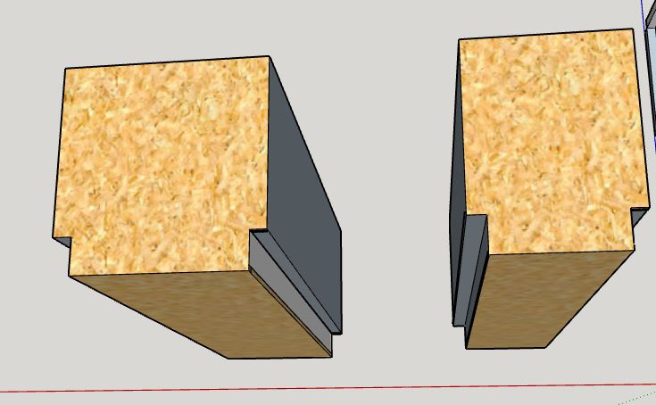

Re: Drawer System. Ideas.

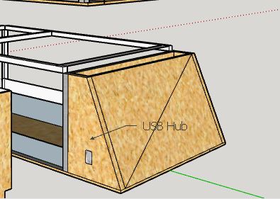

So the design is finalised. Very similar to what I posted. Main difference is the drawers will be loose and can be taken out off the slides. I am also forgoing water and behind the drawer will be a sloped box for USB charging. It will have padded leaves to put cels, tablets, go-pro, batteries, laptops, etc in. Lockable, semi concealed and accessed by pulling the seat forward. It is a common issue on trips keeping everything charged and stowed on long trips. It is just next to teh battery as well. So security and convenience.
Some help from a fellow forumite and I have sources most of the bits. Going to build the bulk of it so i have accurate measurements before getting the aluminium sheeting and get it cut when I buy it. Guillotine cuts are much nicer than me and hacksaw!!
I am wondering where to get the black pile carpet that most commercial drawer systems use? I presume a material wholesaler?
Pics of the changes
- The carrier that attaches to the slides and the drawer drops in.
- Drawer base.JPG (40.77 KiB) Viewed 10182 times
- USB charger station.JPG (29.78 KiB) Viewed 10182 times
