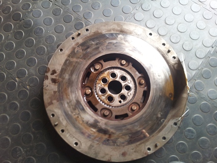

Booked the Patrol in at Mayfair gearbox. The gearbox has been removed and it seems that the DMF has some bad patches.
Gilo engenerring will be making up a new solid flywheel for me and I have ordered the Valeo NS20 clutch kit from Midas.

They removed the gearbox and labour will be around R2500. The clutch kit was R1900 and I had to purchase a diffrent thrust bearing as the one that comes with the NS20 kit is larger in diameter.New solid flywheel will cost around R4800.
I will post final pricing and part numbers of all items once complete.
