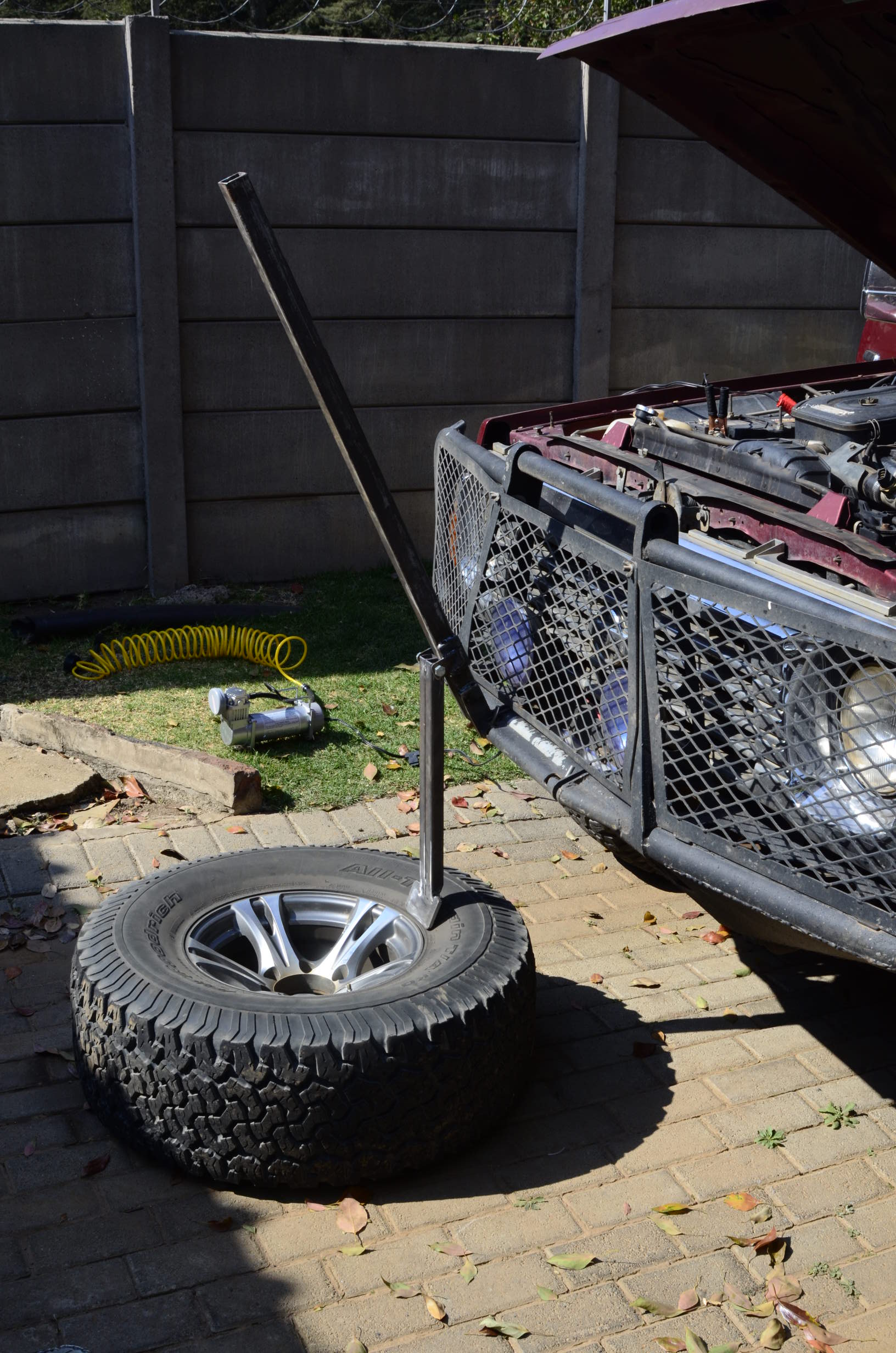

I have long wandered what I would do if I got a puncture requireing a tire to be removed from the rim, and decided that this was the ideal opportunity to make myself a bead-breaker. This clips onto my front bumper:
It took about two hours to make from material already lying around in my garage.

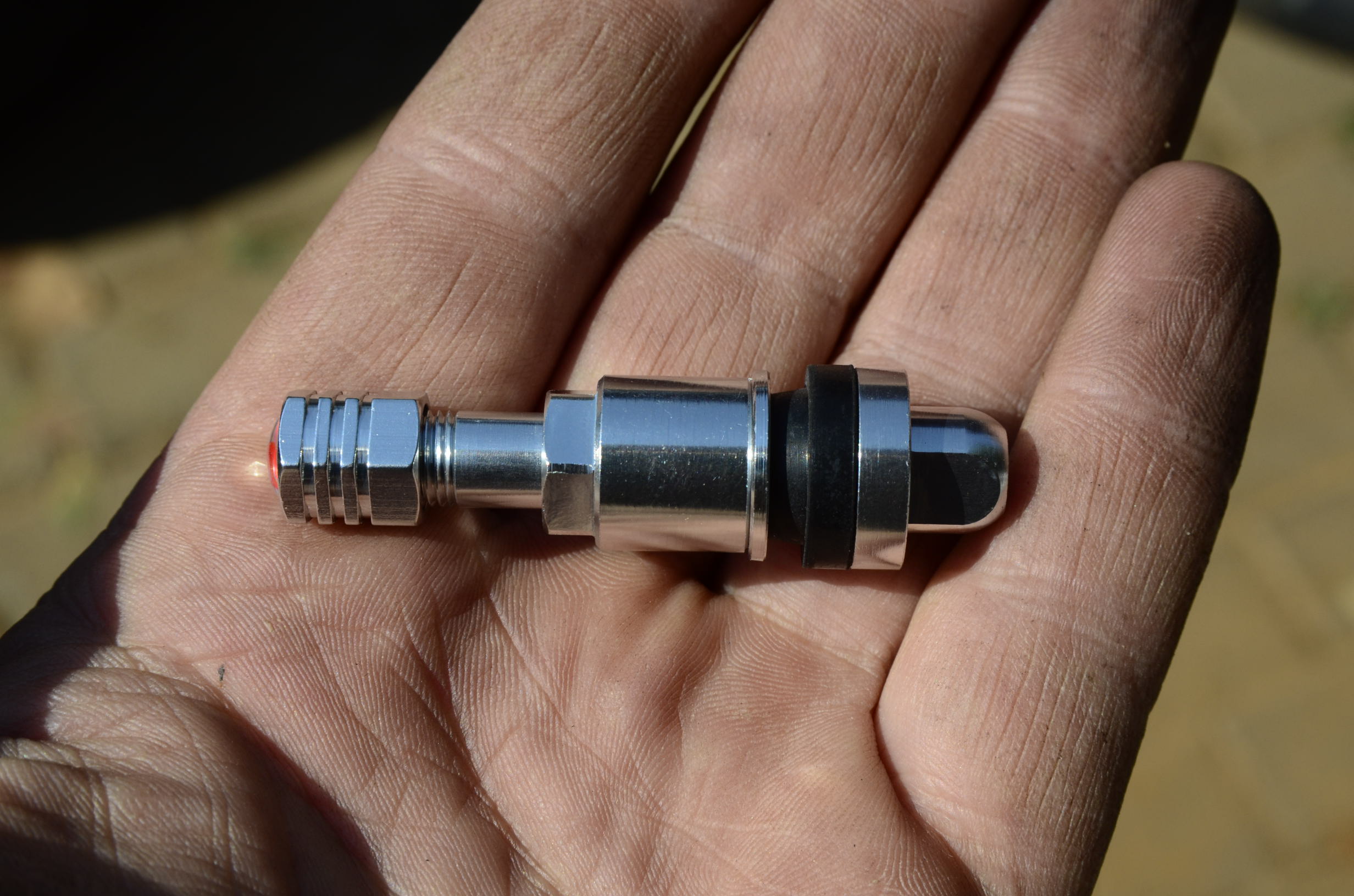

This is what the valve looks like:
Basically it is a standard metal-stem valve with an attachment at the bottom for the sensor, cosisting of a flat section and a tapped hole. It takes a standard valve (the internals), uses standard caps and works with standard deflators.

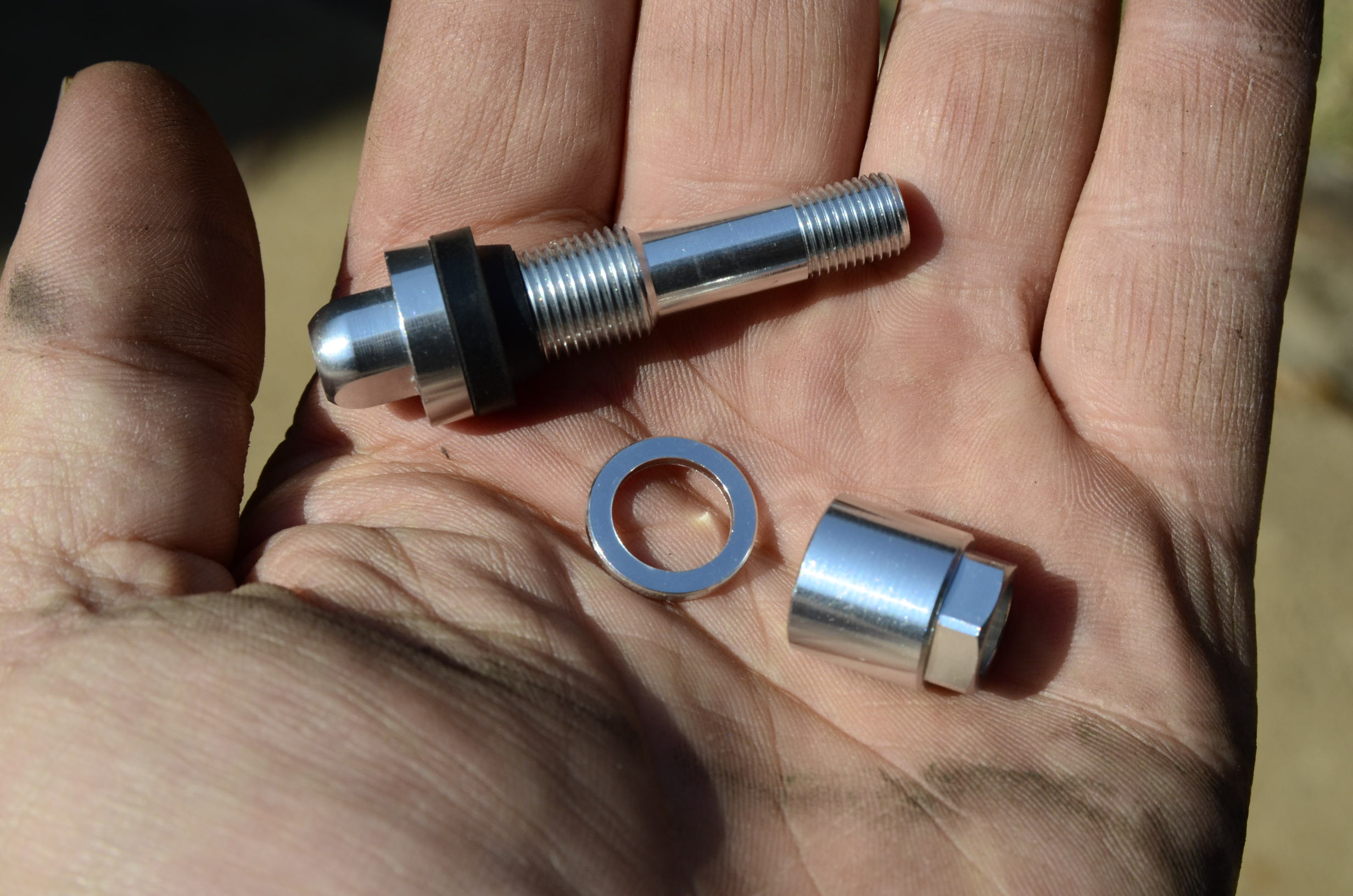

The vlave consists of:

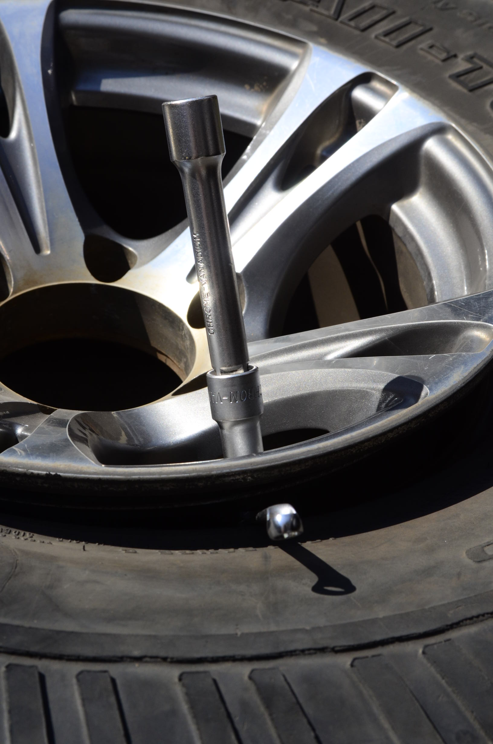

Valve installation in progress:

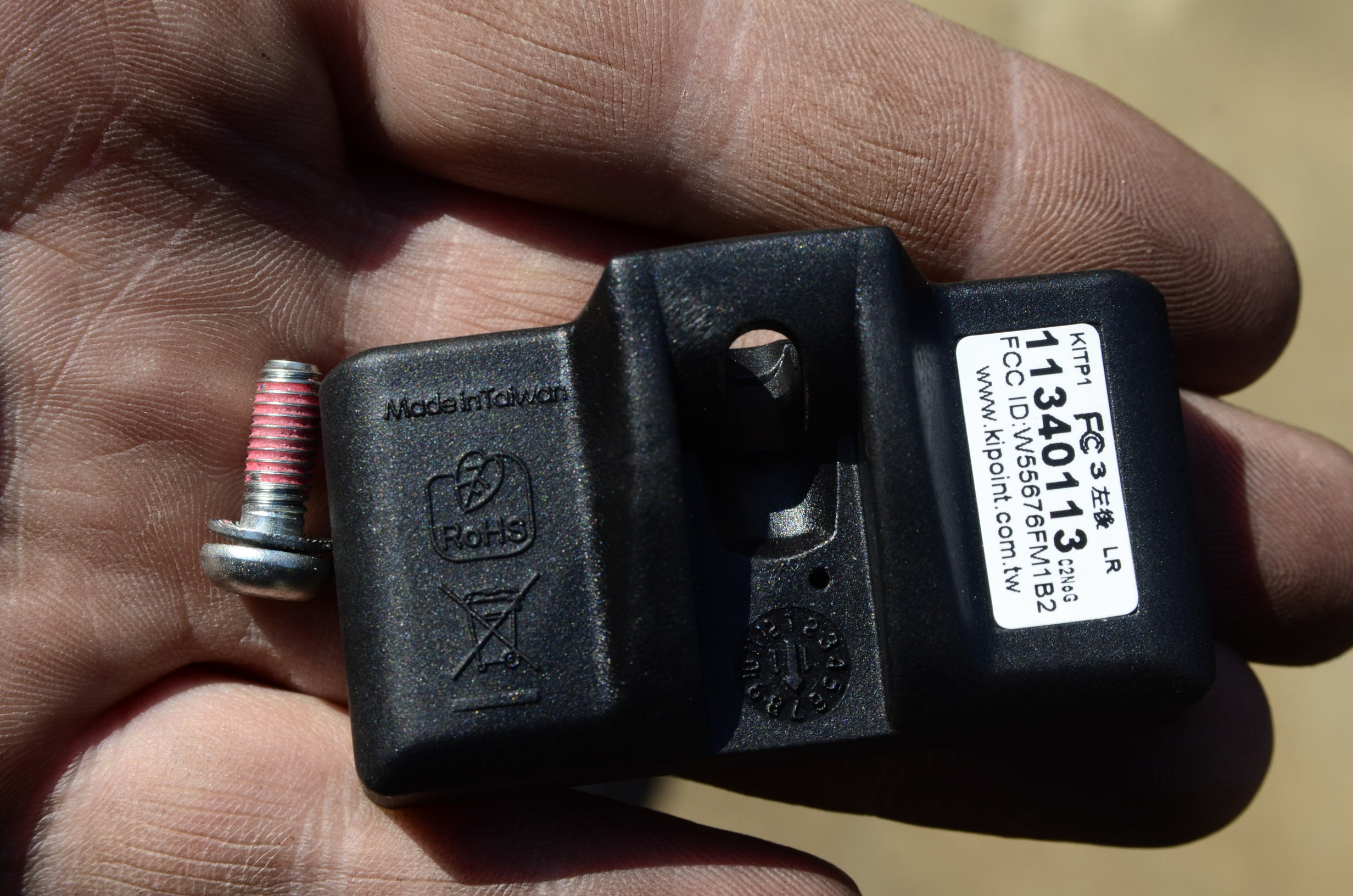

The sensor and the screw that holds it:
The screw is a bit special, it in nylon coated to prevent it from rattling loose and has a hole through the length.

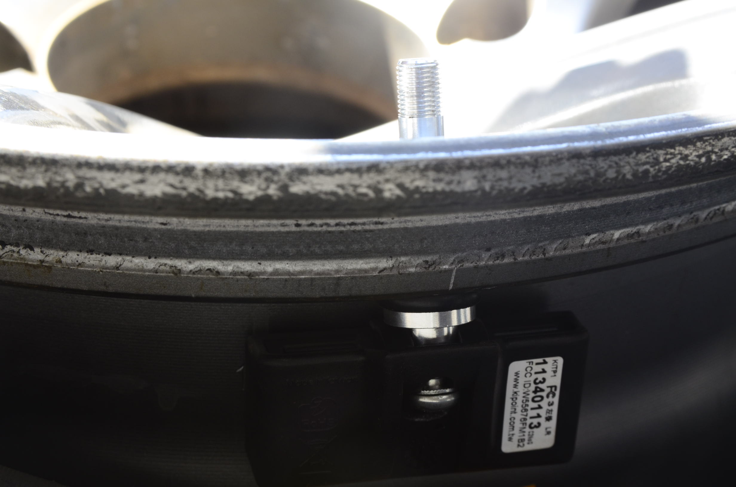

Fitted into the rim:
So far I am dead happy. The unit responds quickly and seems to be pretty accurate. Seeing how the temperature and pressure respnds to your driving is also very interesting!
