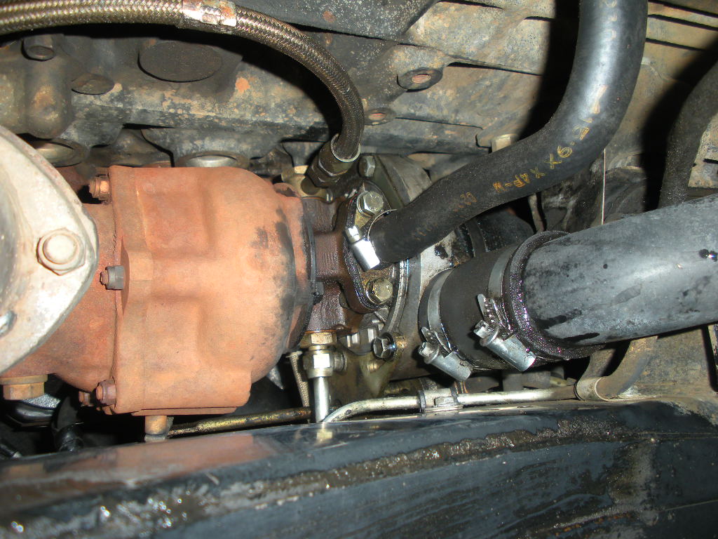

Here is the Turbo from below
- DSCN1394.jpg (194.53 KiB) Viewed 6908 times

Re: Anyone here turbo'ed a TD42?
Grant
Great pictures.
Do you know from what point was the oil connection tapped in for the turbo and does it have water cooling too?
Is the exhaust manifold one or two pieces?
Info from the web site. Go to www.safari.com.
Hi Ratu,
The turbo on my troll sits on the bottom. See pics above. You can also discuss this with Mynard as he installed this unit. I would also be more than willing to meet up with you, so you can have a look at the fitment. A test drill will seal the deal to fit a turbo.Fell free to call me on 084 520 6570
Also please check with Mynard as the unit I have fitted is set at .7Bar boost. All the local units only boost to .4 Bar.
