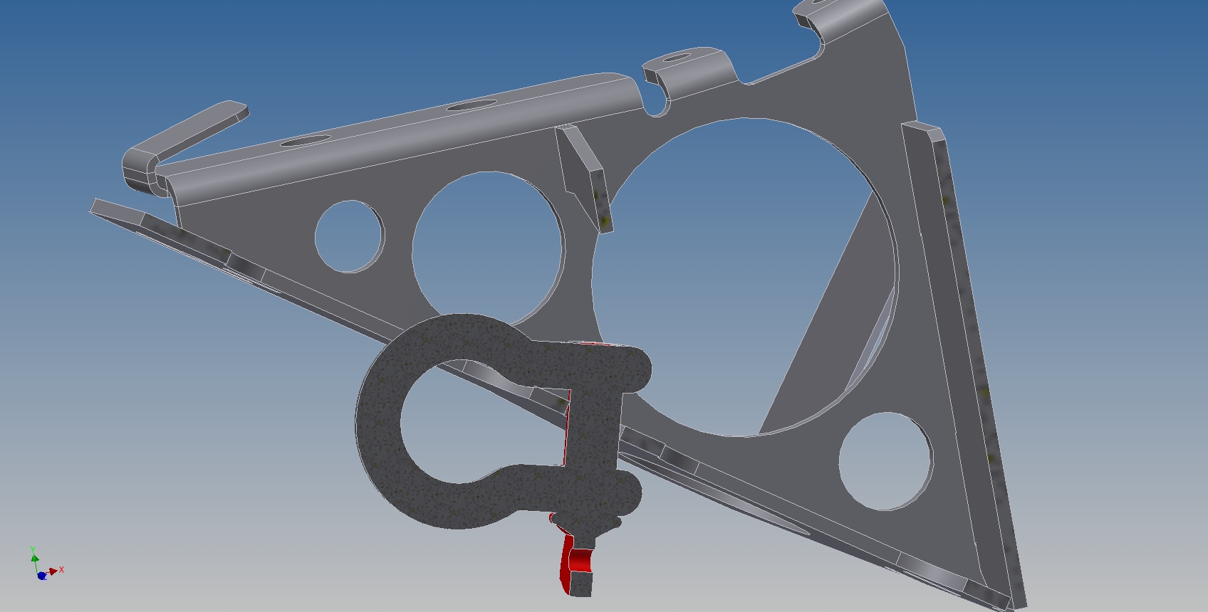

Hello Guys
Uncle Mac sent me the following PM:
Hallo P/ter
Broertjie - oompie sit meddie selle 'worri' as Stefan - as daai shackle soos opp die prentjie [askies - Skets / tekening / drawing]
ek sal probeer teken op Piant en vi jou stuur.
A - soos hy sit gaan dit maar BARS om eitas anders by hom in te haak - of sleepband deur de trek. Mens het die hele opening nodig daarvoor. [so gemiddeld 10 recoveries per Uitreik het my daai stukki al geleer]
Hoop nounie ek trap op jou toon nie - dis bloot advies - en jy weet mos, hirri outoppi weet okki alles 'ie [al dink die str^nt so ]
Oom I am replying on the thread because I can't attach the picture to a PM, I hope you do not mind.
These computer draughting programs can be quite limiting, and sometimes to get the result you are looking for requires a lot of effort. When I placed the shackles in the original picture I posted I was being lazy. The point is that the shackles we use are generally 3/4" shackles. The pin diameter on these shackles is 19mm. The hole in my plate, however is 22mm. Therefore the shackle can "twist", as I am attempting to show below:
This means that in fact most of the bow is accesable to hook things into.
Further, the shackle holes are placed as far as possible forward and as high as possible so that you don't have to dig too deep if it is your car that is stuck, but far enough down to not damage any part of the vehicle.
I decided not to extend the vertical mountings downward through the plate for this purpose because they will then be vulnerable to being bent (I did that on one of my previous bumpers and they have been bent).
However if you have a bullbar with recovery points, it would be better to use them. They will be higher, so the pulling angle will be better, and they will be more accessable.

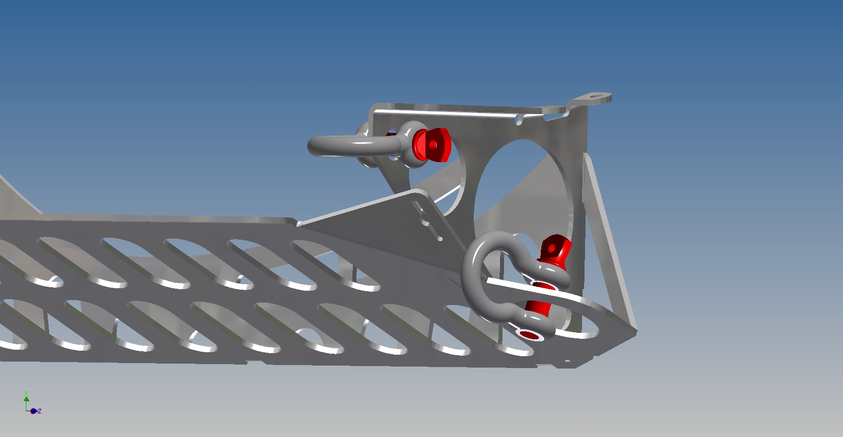

Re: Bash Plates
Hello all.
Oom Mac I hear what you are saying. It is easy to get the shackle horizontal on the 4.8l model's bash plate as shown on the picture below. The shackle on the left is the recomended mounting point.
The other shackle shows another possible attachment point which is available on all the bash plates. However I do not recomend using this unless you are really deep in the poo. Using this point, the plate is almost guaranteed to bend, but what worries me far more is that the bolts holding the plate onto the car may well fail.
The plates on Y61 patrols will be held on with 4 M16 bolts at the front and four M8 bolts at the rear, and the M8's are probably not strong enough to withstand these types of loads.
I thought about extending the vertical mounting plates through the bottom of the plate, but I am sure they will be very vulnerable. Perhaps the answer is for me to make up some angle-iron brackets which can be hooked into the slots in the plate and then bolted into place securely but quickly?
Let me know your thoughts?

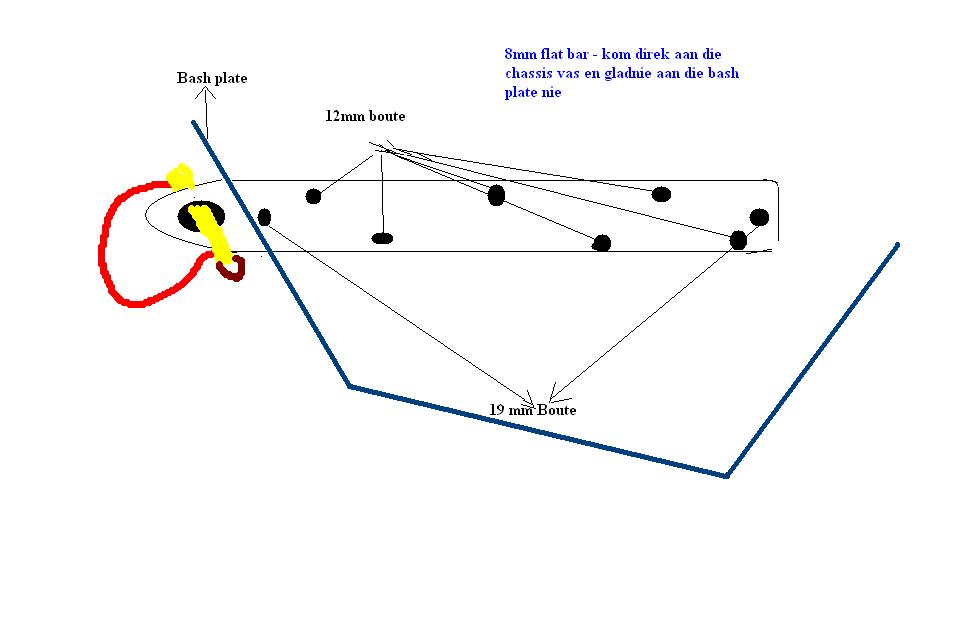

Posts: 3462
Re: Bash Plates
Haij daa P/ter - Sommer gedagte - kan mens nie die "recovery point" [snatch & tow point] direk aan die 'chassis (ONDERSTEL) heg nie?
Ek kannie teken nie - maar idee is seker duidelik? - Dit maak dan ook vir die ouens wat net die "recovery point" (Herwinningsankerpunt) soek sonder die "bash plate" (SLAG PLAAT of ook BESKERMINGSPLAAT) ook moontlik om dit dan losstaande aan te skaf?
Wonner sommer

Dit is 'n great idee oom Mac!

Ek sal kyk daarna, maar sover ek kan onthou is daar nie vreeslik baie geskikte gate aan die kante van die chassis nie. Sal die naweek bietjie kyk.
