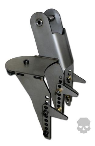

What a pain. Diff has been in and out 3 time today trying to work around my lack of jacking equipment, and worried the Sani is going to fall of it's stands. Only way I can do this, is to guess the height, do the buckets on the chassis, and see what I actually get. Pull the buckets off the chassis and adjust as needed.
Wanted to build this, but there were concerns about strength, and I don't think I have the time left to do this anyways.

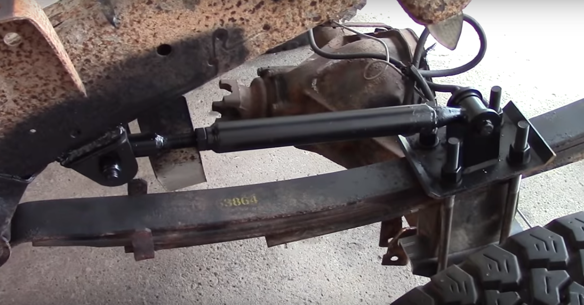

Just saw this. Not sure if you have the rear axle issue.

Jakes, I don't have lift blocks, so my axle wrap should not be that bad. We will see once I start pushing double gearing through 35s. But for now, I only expect to be doing a bunch of sand driving. Our site and accommodation is in a sand pit, Atlantis type sand.
