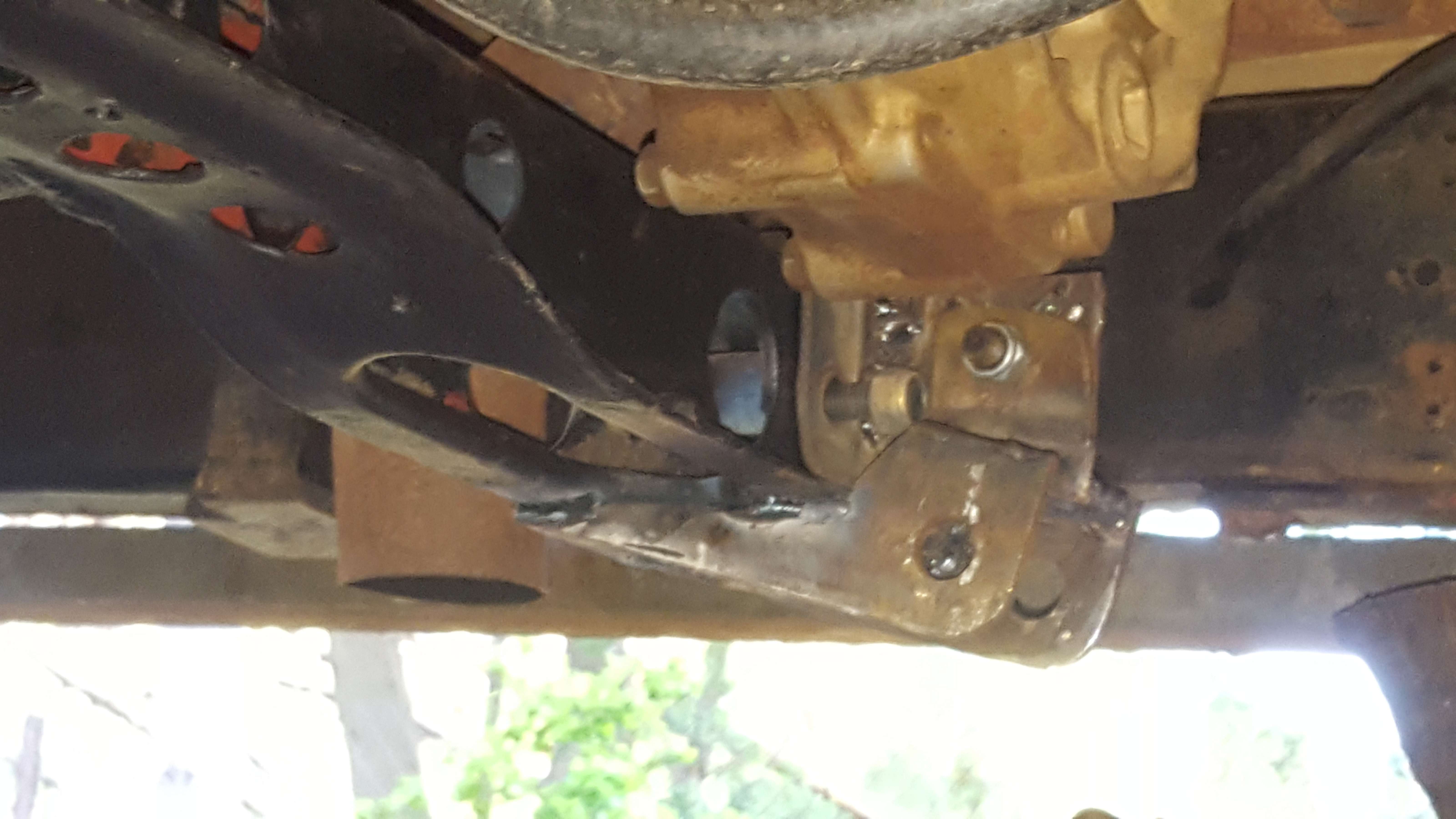

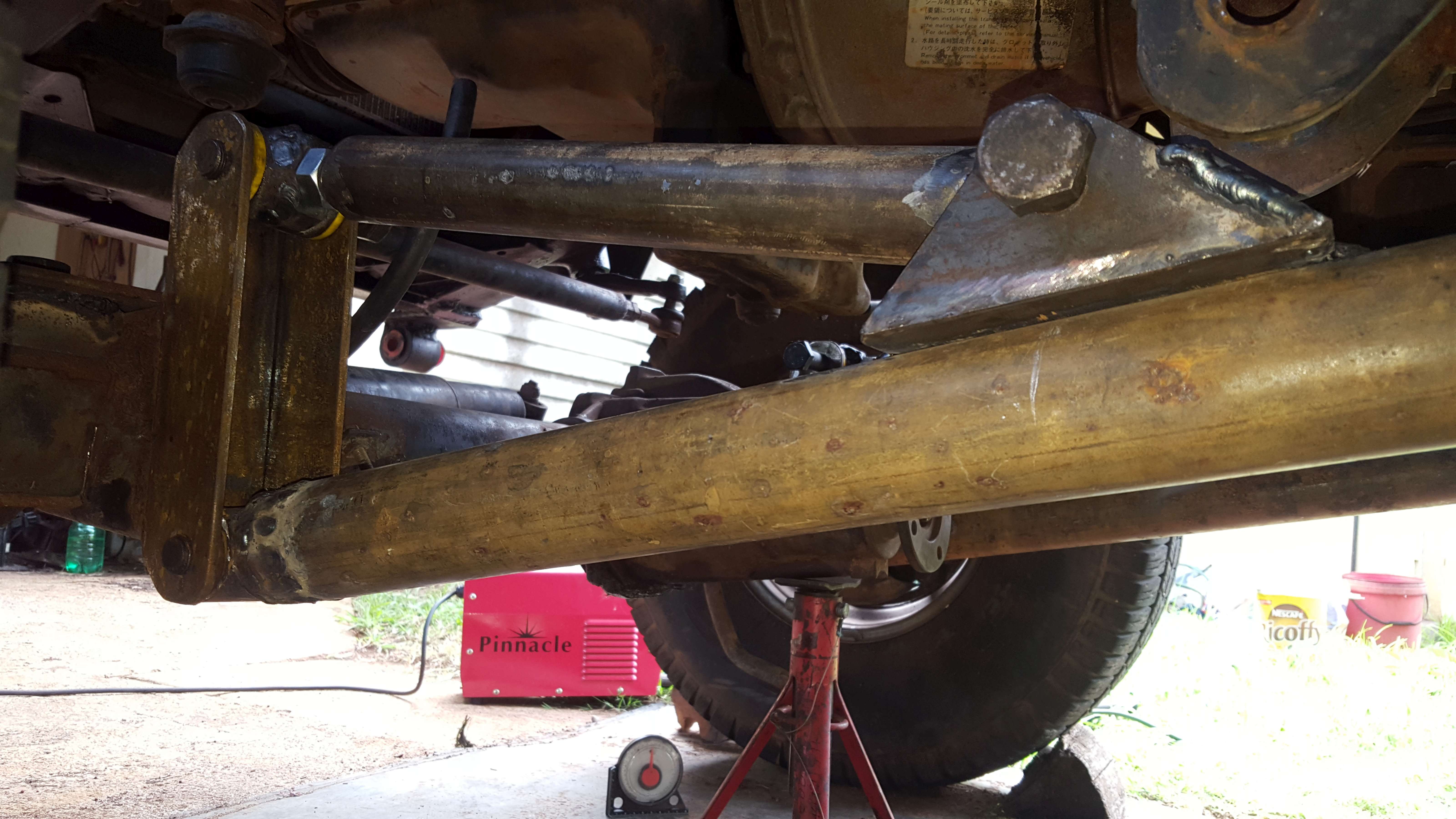

Done the Chassis mount brackets with the added brackets to add an additional bolt on section on the old torsion mount cross member, axle mount brackets with some stuff left to do once I figure where the coils, panhard and shock mounts need to go. Busy with the lower/main radias arms and short arms today. Will take some pics.
Those pipes you gave me are bigass. 60mm OD is as wide as my bushings. So I have had to make a reduction section on the ends to get back down to a 50mmID to make things easier to fit my standard bushing pipe into. Making the main arms standard length with no adjustment, but the top/short arms will have around a 50mm adjustment as I could only get 100mm length bolts for this task on such short notice.
BUT, I see I'm running out of steel. I only got 12 meters of 60x6 flat bar. Some places I am having to build plate out of 3 flat bar sections next to each other. Welding them together, and doing it slow enough to prevent the whole lot warping. And my guy I had that was going to help me with the welding, is AWOL, so it's hillbilly 3D welding all the way

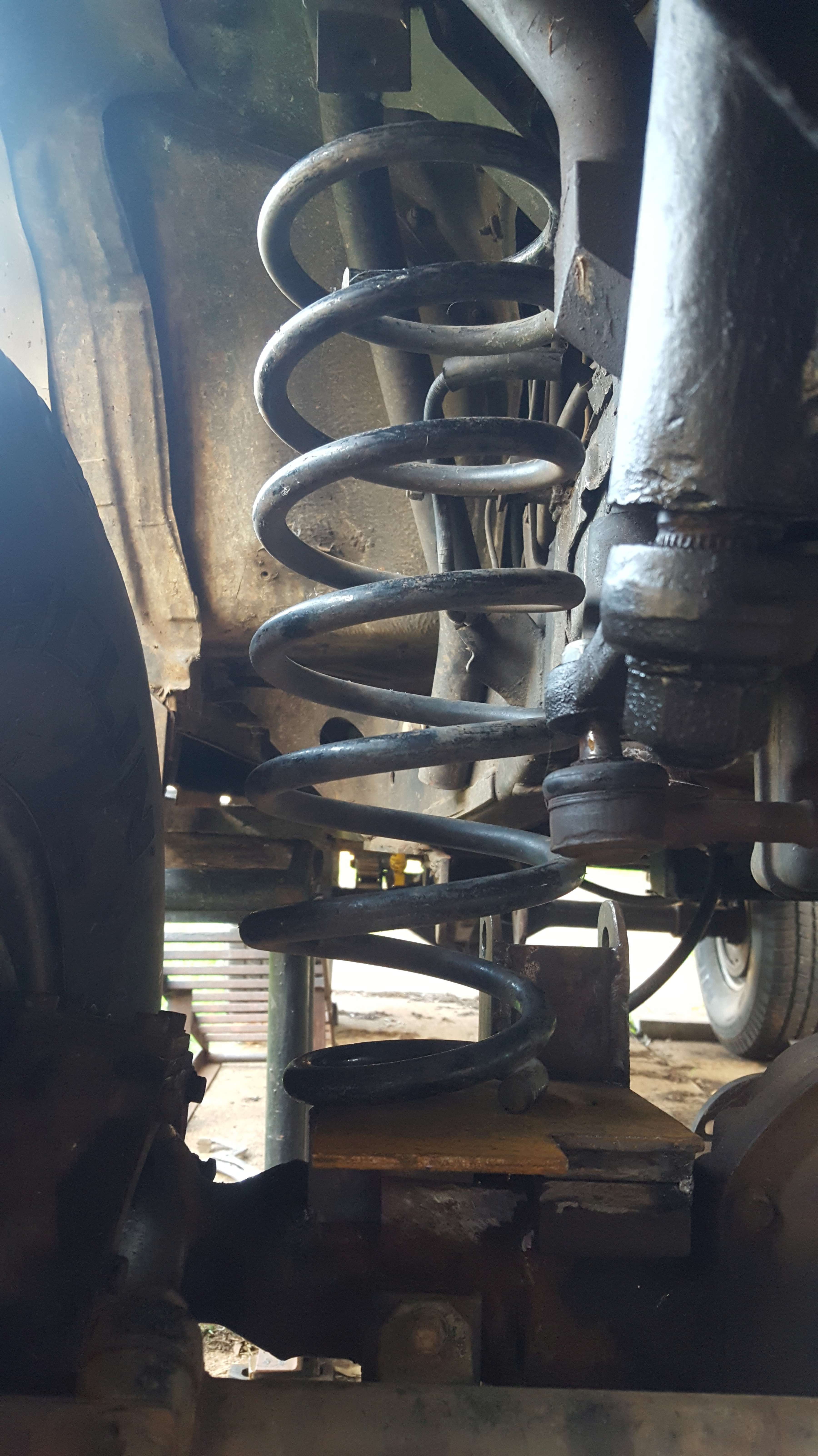

Somehow going is slow today. I am finishing off the radias arm welding and brackets. Preset the maximum setting to -5deg castor. I wanted to be working on the Panhard by now. Wanted to have it in place by Monday so that I can start testing coil spring compression to see where the upper coil bucket needs to be, and I can start fabbing that. But now I have to take another trip to town in the morning to get more stuff. Suppose I'll be loosing at least half the day with that exercise. It's a bugga when you don't have transport.

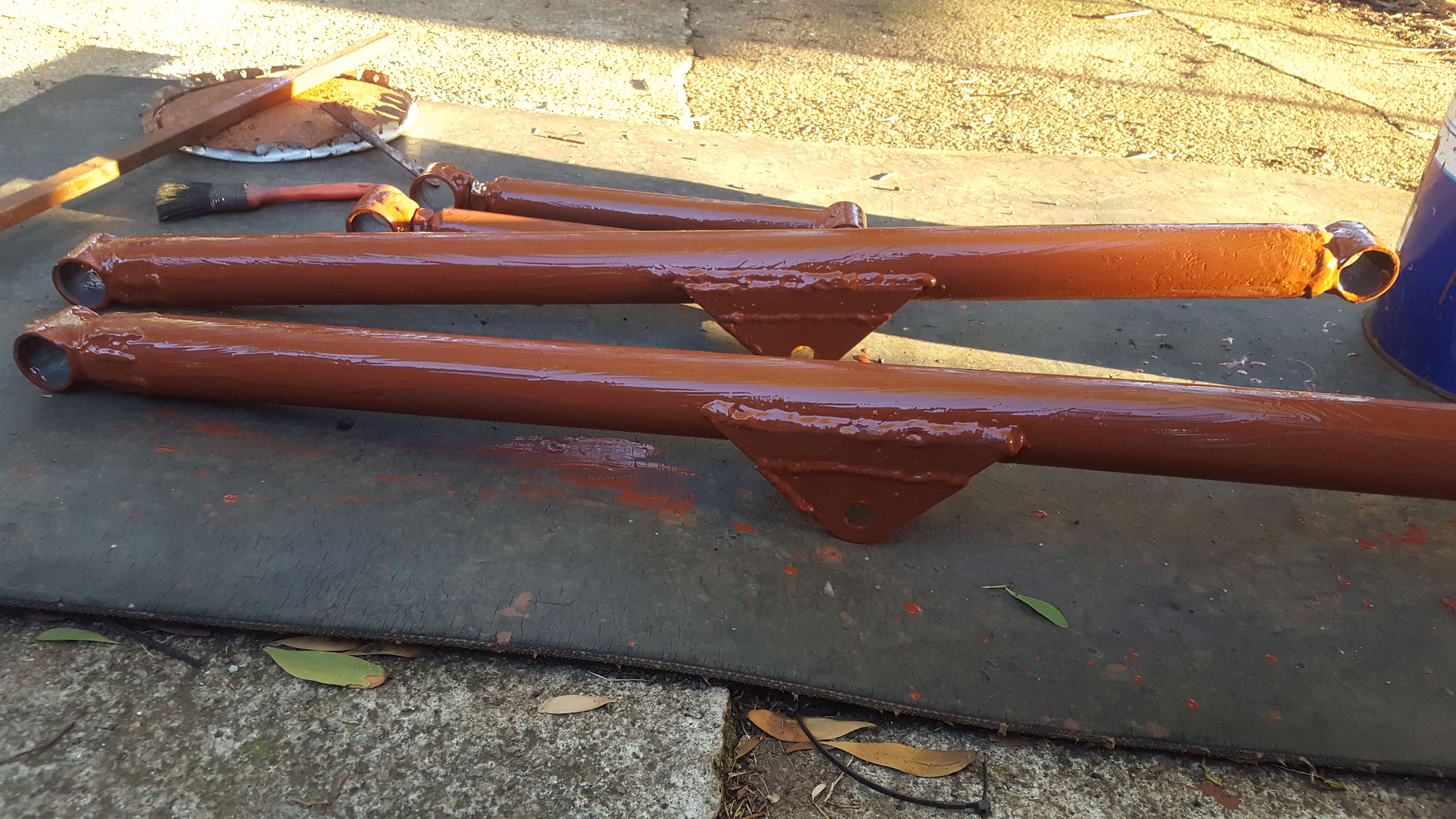

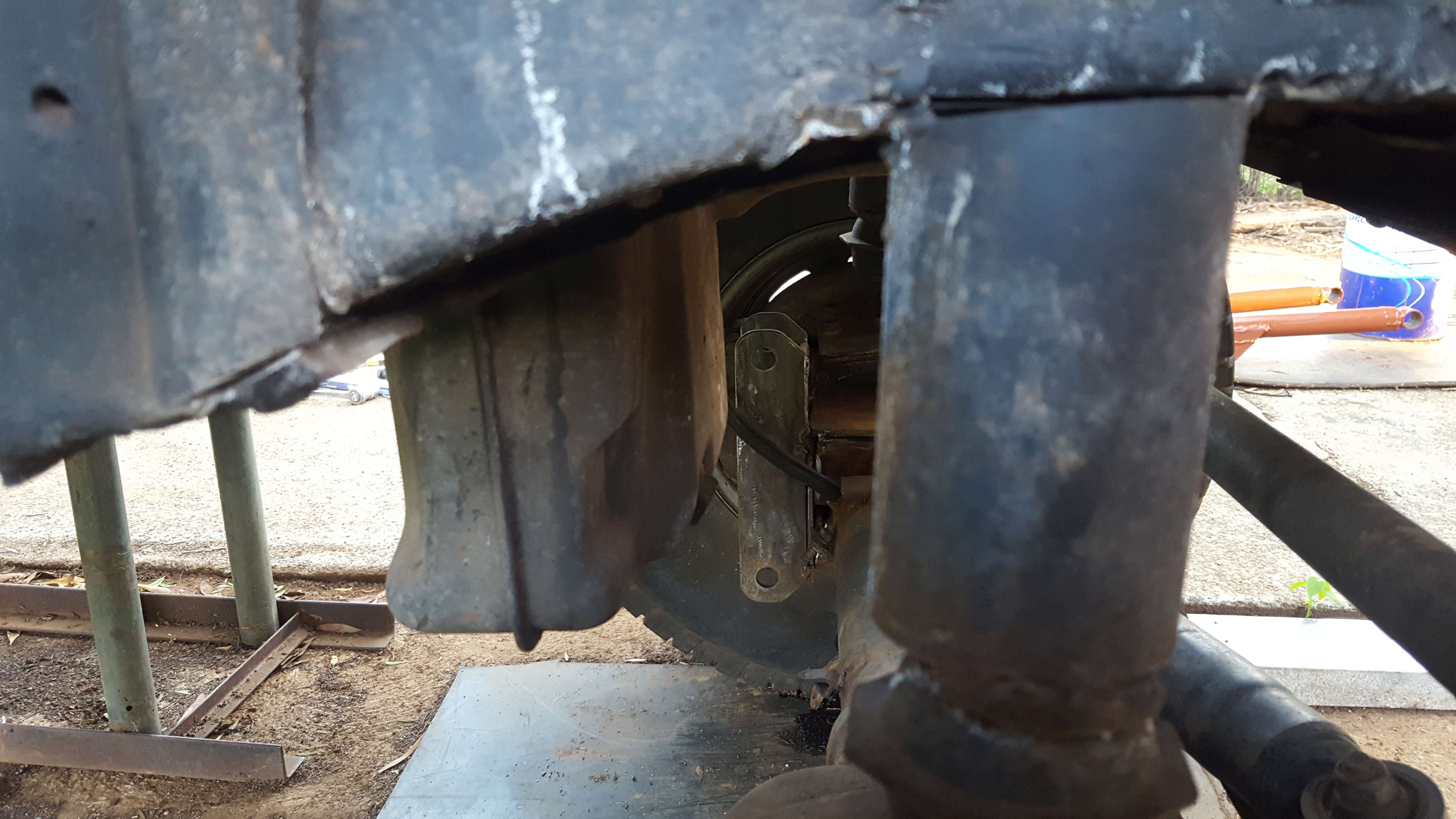

Got the arms welded and even painted. Damn I miss the Cape already, it is still light there, I could have been working another hour or two.
Some pics
Some pics
