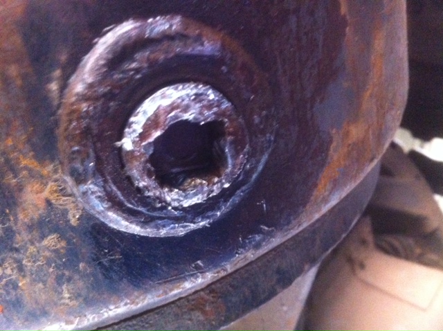

Pieter, die regte tool is 'n gewone 1/2" square drive soos op ratchets en strongarms.
Fanus, panel-beat die gebuigde dele in, kry vir jou 'n baie kort socket extension (verkieslik by 'n pawnshop), slaan hom daar in, en dan draai jy hom versigtig terwyl jy hom herhaaldelik met 'n hamer slaan.
As dit nie werk nie, swys hom daar vas en draai hom dan uit.

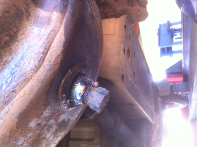

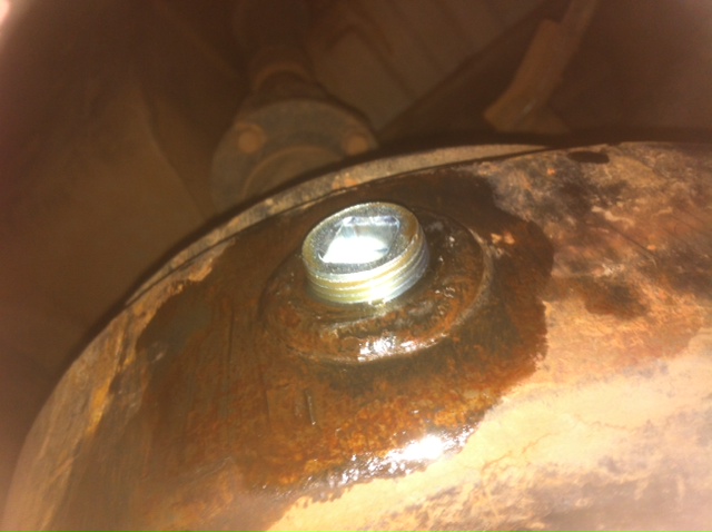

ok, new diff oil and new diff plug is in, for what it is worth. I am not really convinced that a working lsd is worth all the effort....only time will tell. However, I wish nissan put a locker in my bakkie.
Tried to remove the stripped plug with a bobejaan spanner... did not work. Then got someone to help me weld a bolt onto tyhe stripped plug. New shiny plug is in. Most of the protruding part will probably get smashed on the river trip....

Ja kyk hoe mooi blink daai prop, hy gaan defnitief met n klip koppe stamp. Die vorige een was baie korter gewees agv klippe...
