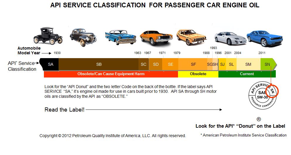

Re: Best Oil - TB42 High Milaege
Would Delo 400 be reccommended for a TB42? I see Delo 400 is a API-CJ rated oil.
TB42 manual says: API SE, SF or SG is reccommended.
Been using Helix HX5 all along which is API SN rated.
Somehow I devoloped an itch to feed my TB42 some delo 400, but now I'm wonderingh if it was a mistake....
