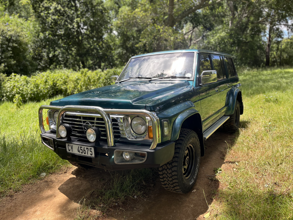

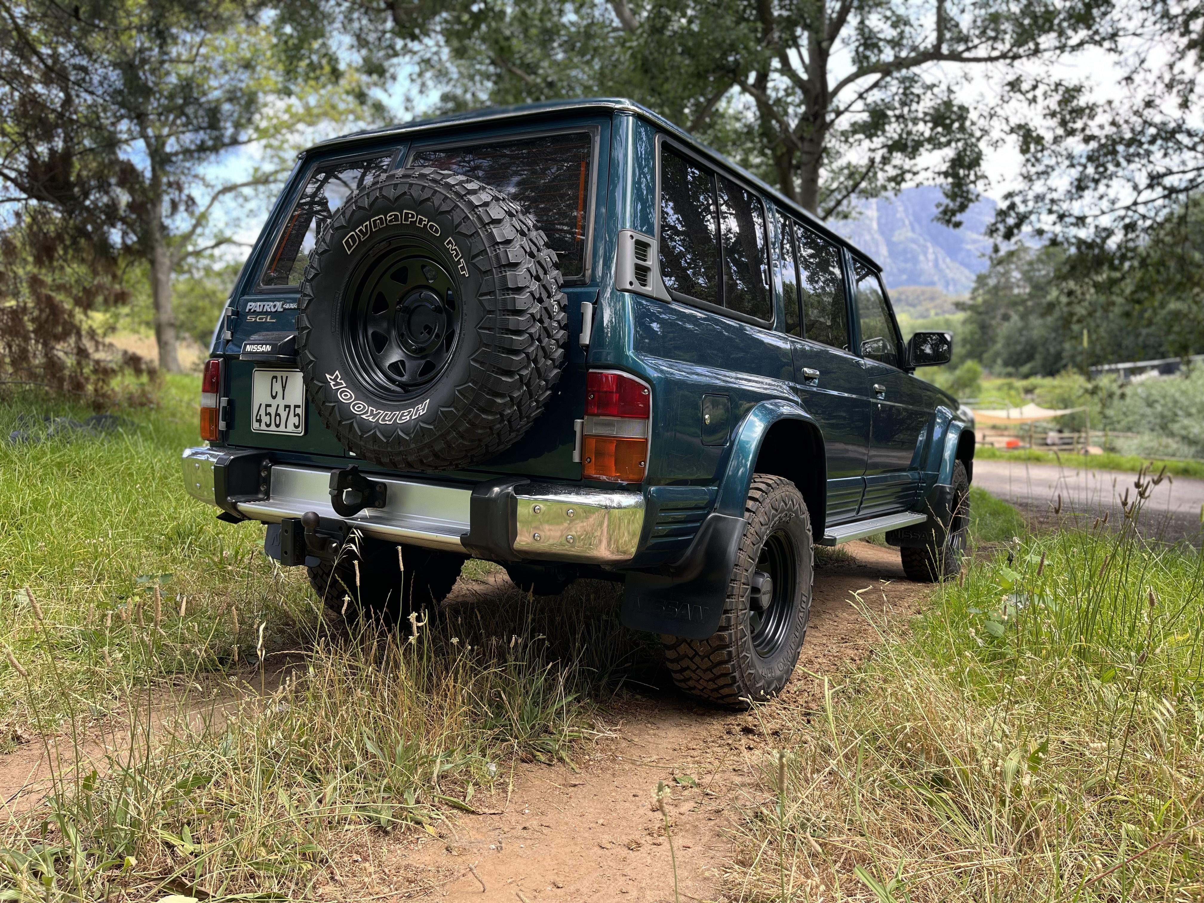

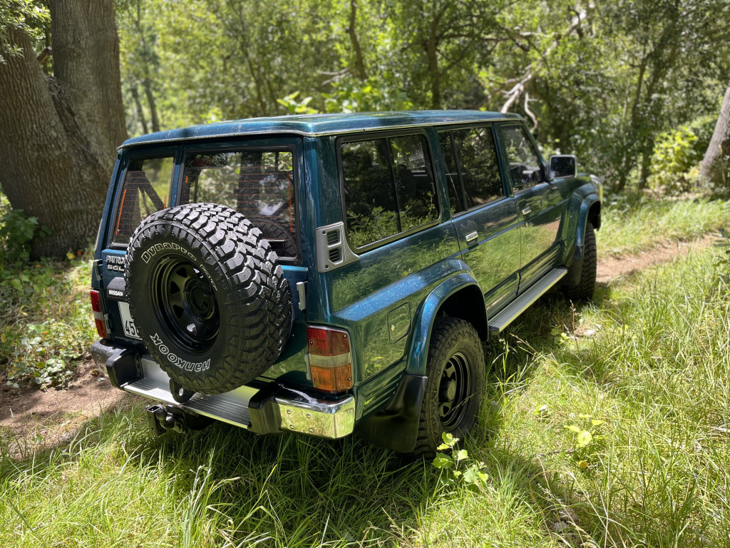

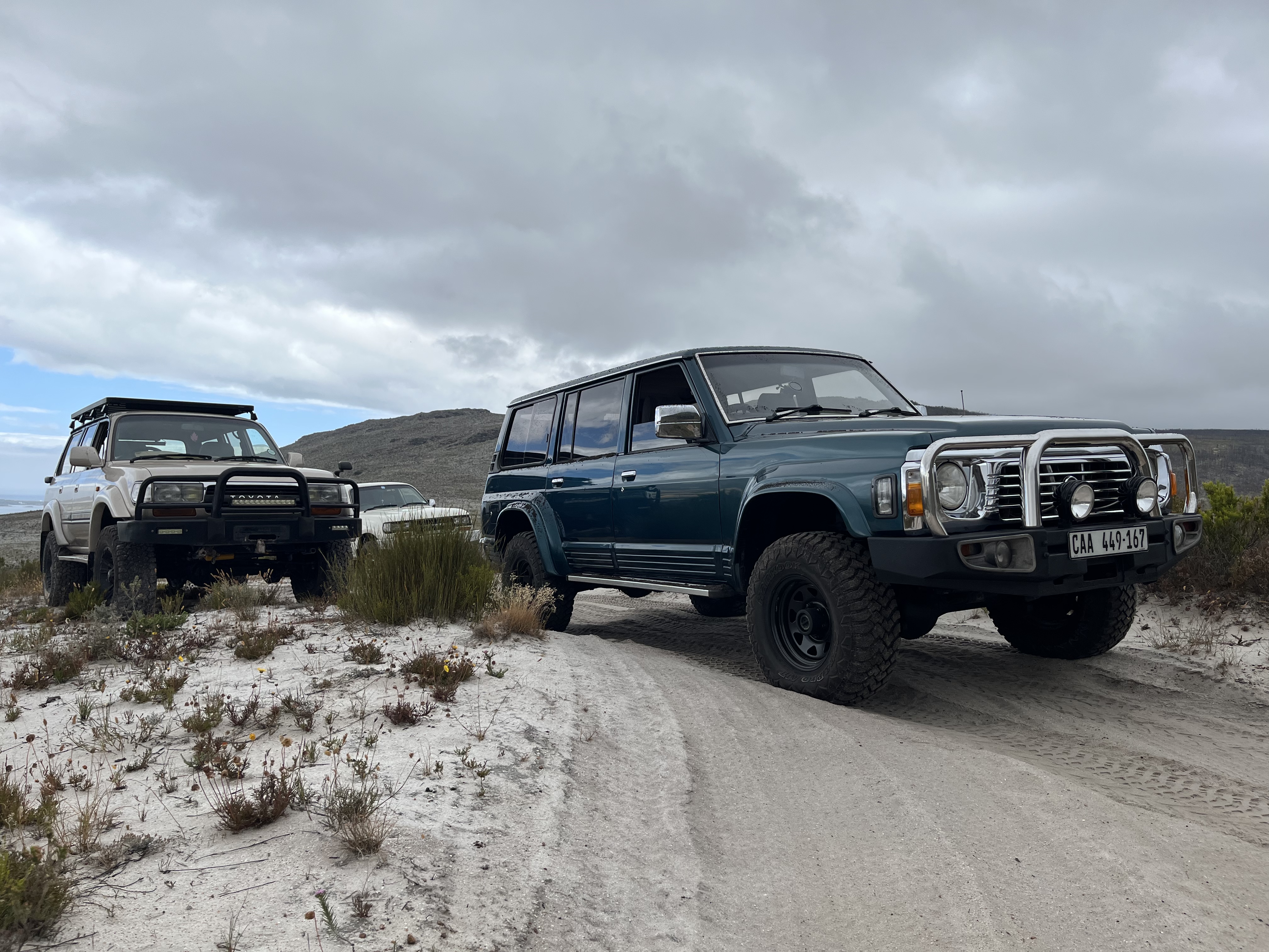

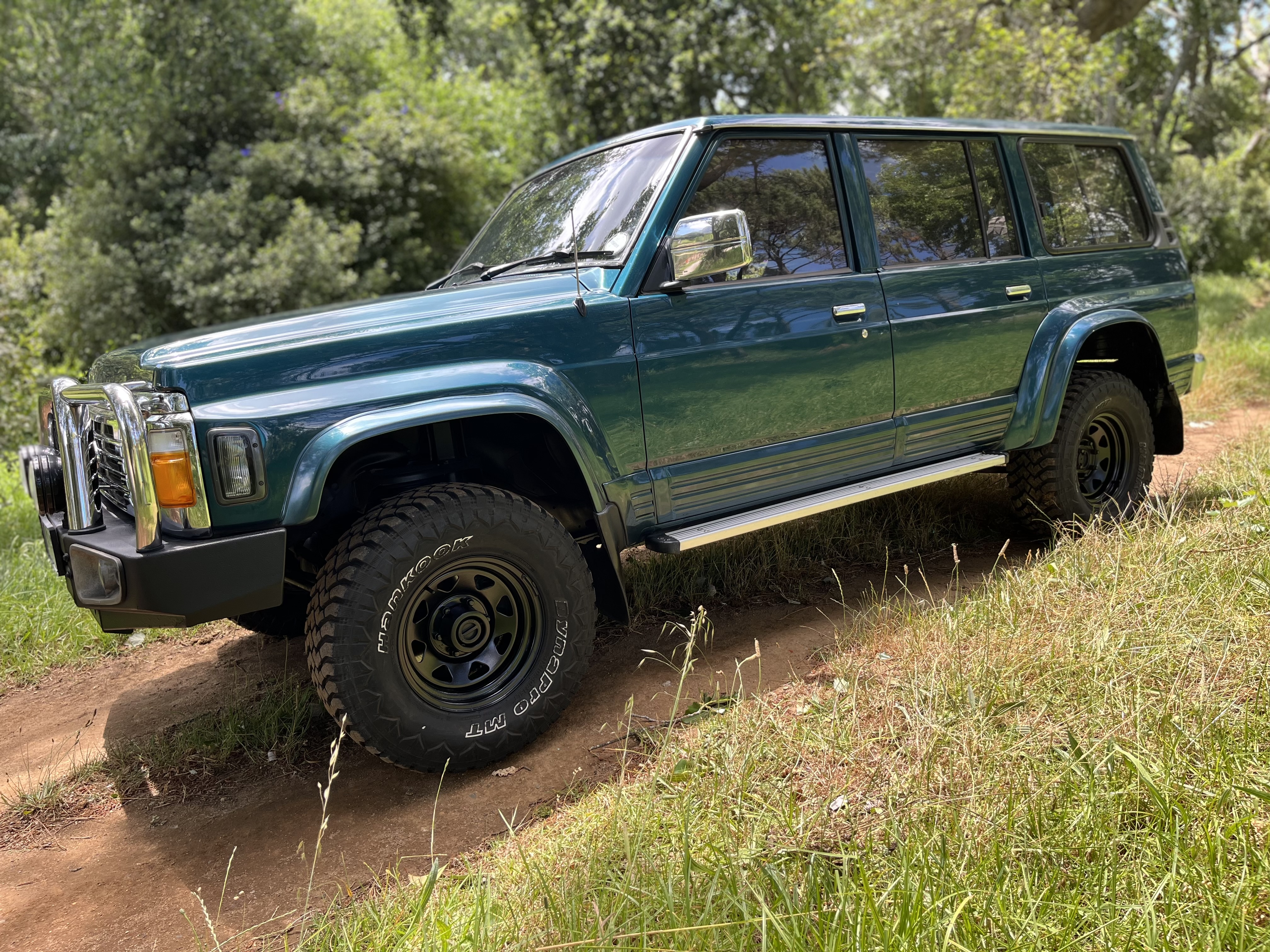

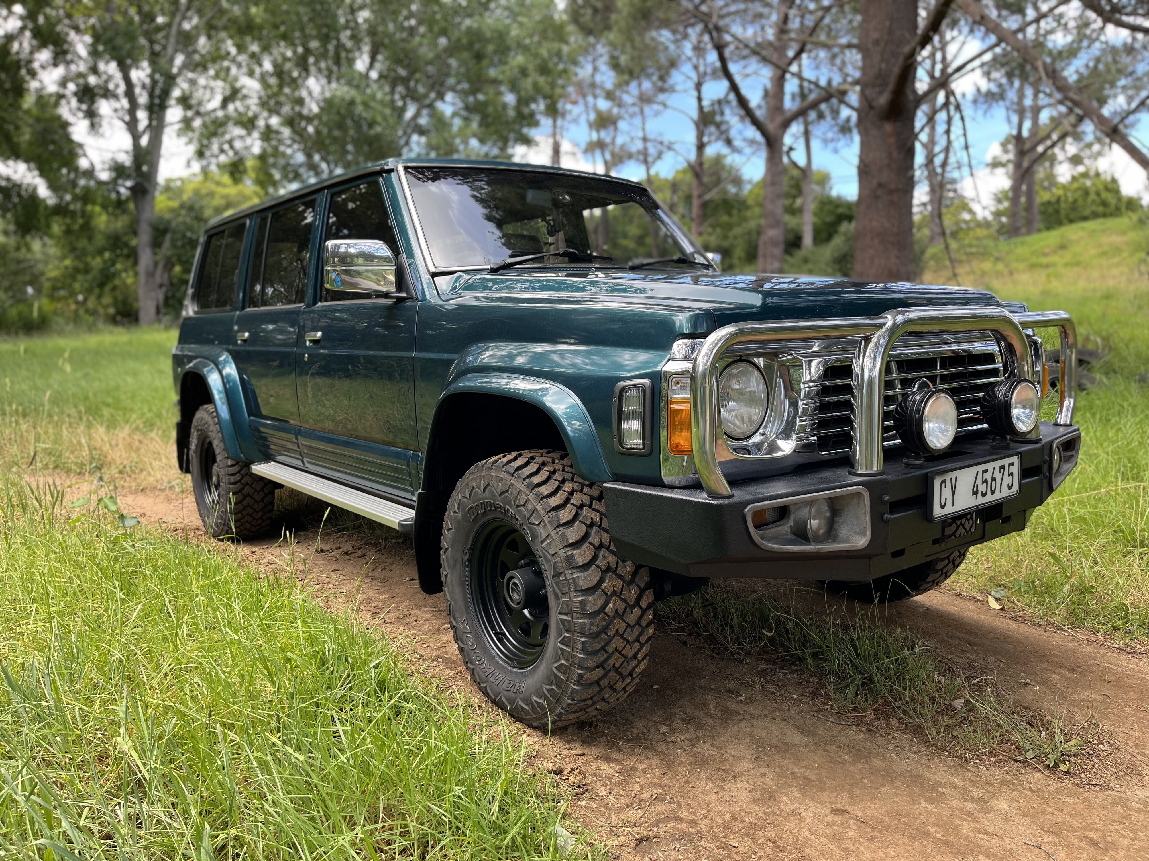

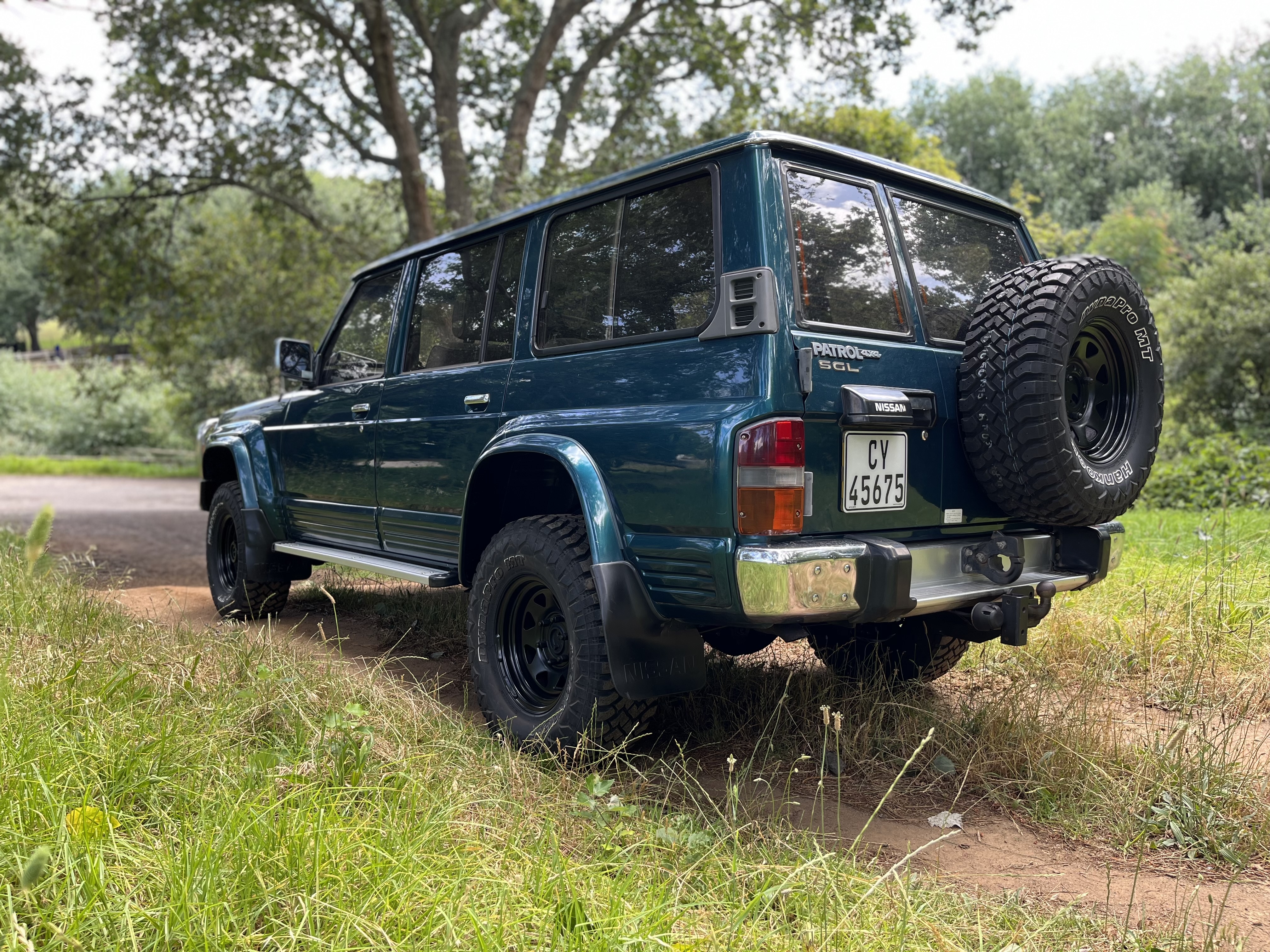

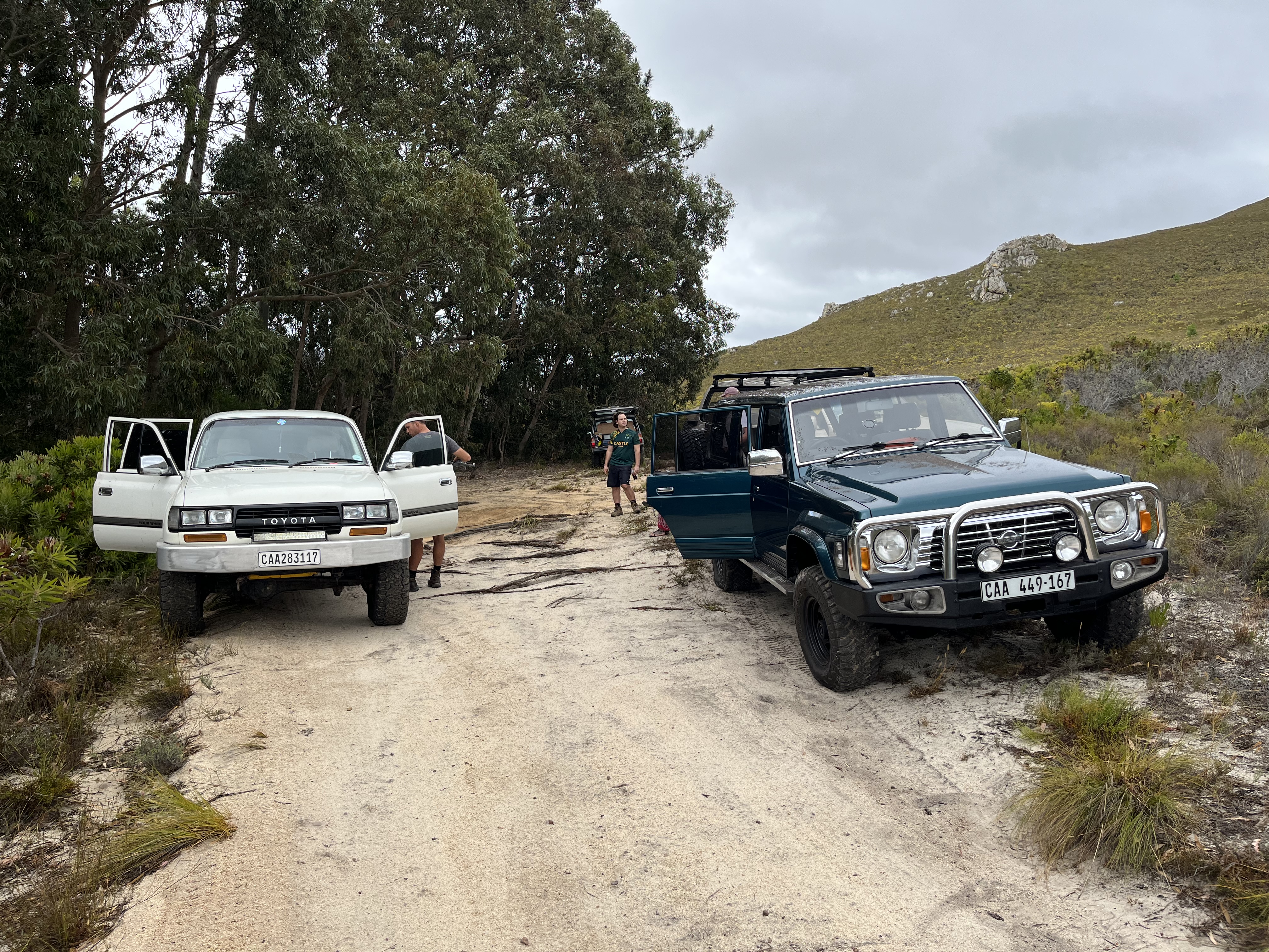

Took a couple pics of the old girl yesterday:

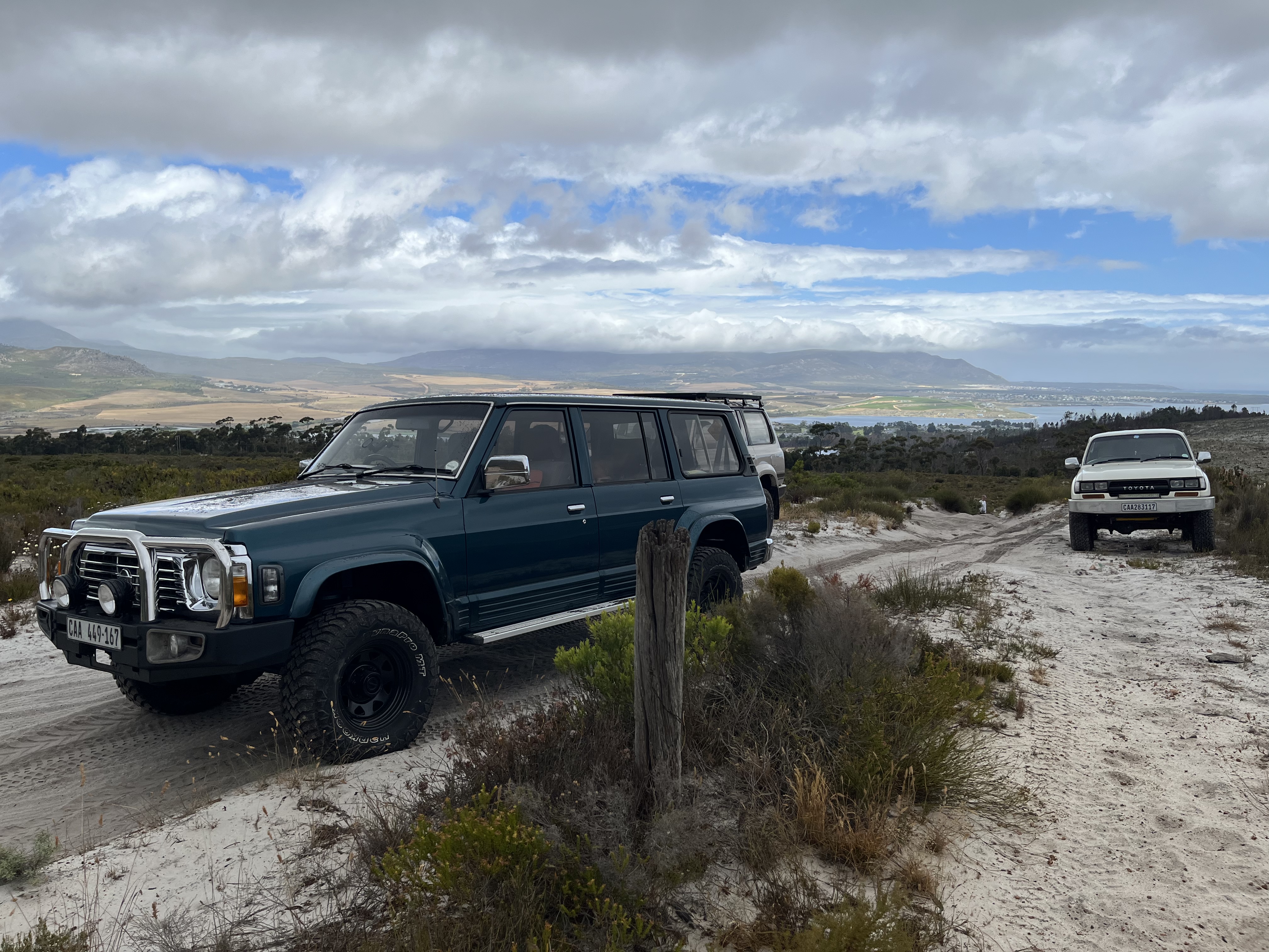

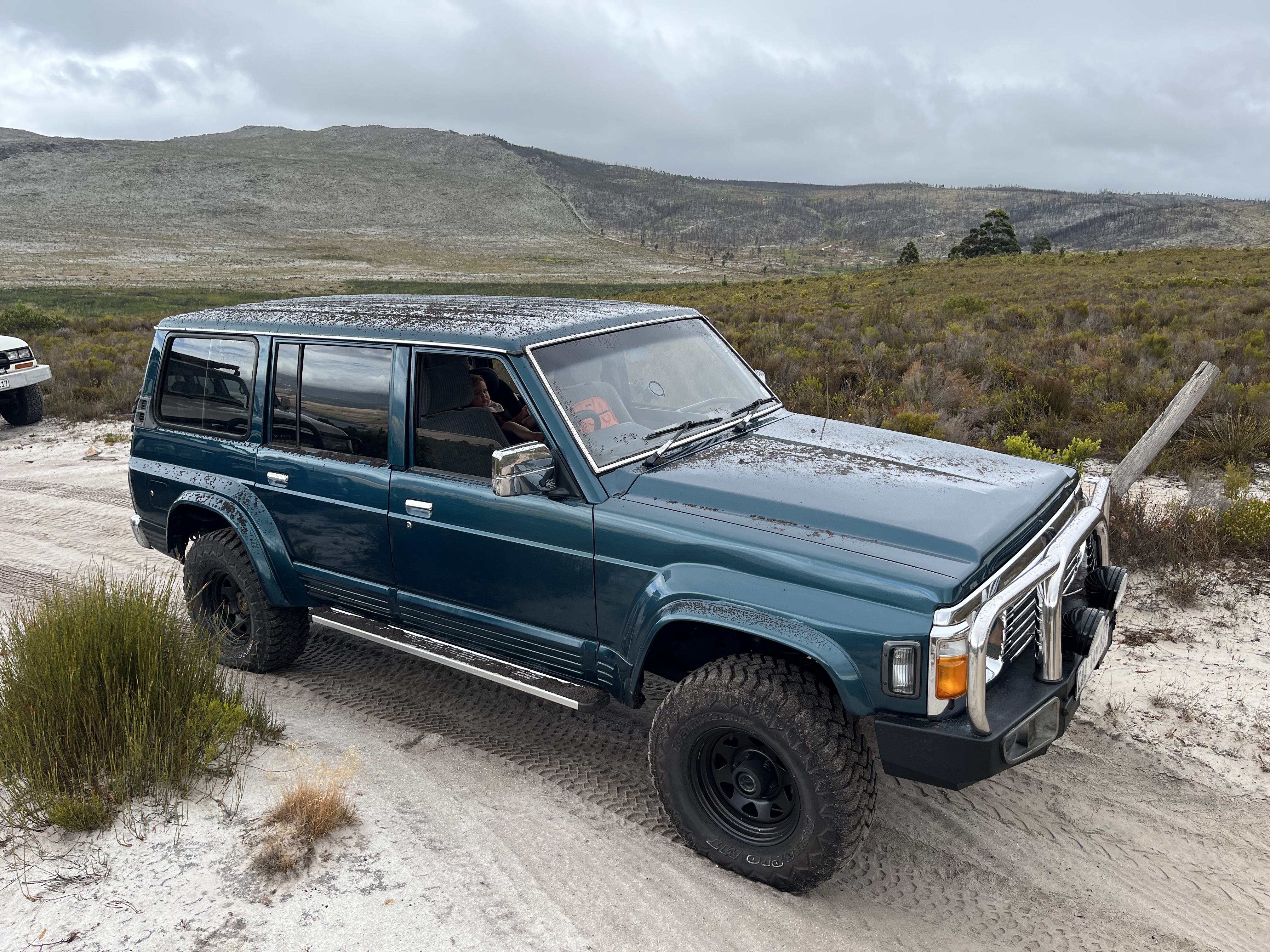

Also did Honingklip 4x4 trail this past weekend, the Patrol was amazing, love it! With a few choice mods it will be a beast!
Was there with some unlocked 80 series LC’s and an unlocked XJ Cherokee, and having that oem locker on the GQ made a world of difference, so much more control. I’m really liking this GQ platform, has so much potential! Even just with a 2” EFS suspension lift, 31” muds and the oem locker, it is potent off-road. Very comfortable in the rough stuff as well. It just looks so good as well, especially in green😍
