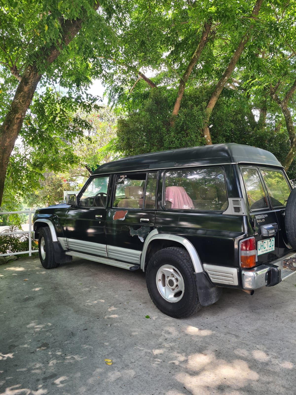

Thanks fellas for the quick responses.
The engine sound seems more "clickish", like metal-to-metal then the clunk sound of other diesels td42 I listened to. It's like going down the rabbit hole when trying to diagnose sounds and using google.
The suspension sound is from the top fronts when relaxing from being compressed.
The coolant was green.
Strong ride. Felt solid like my fj80 same class so it's in my comfort zone.
Will keep you updated.
