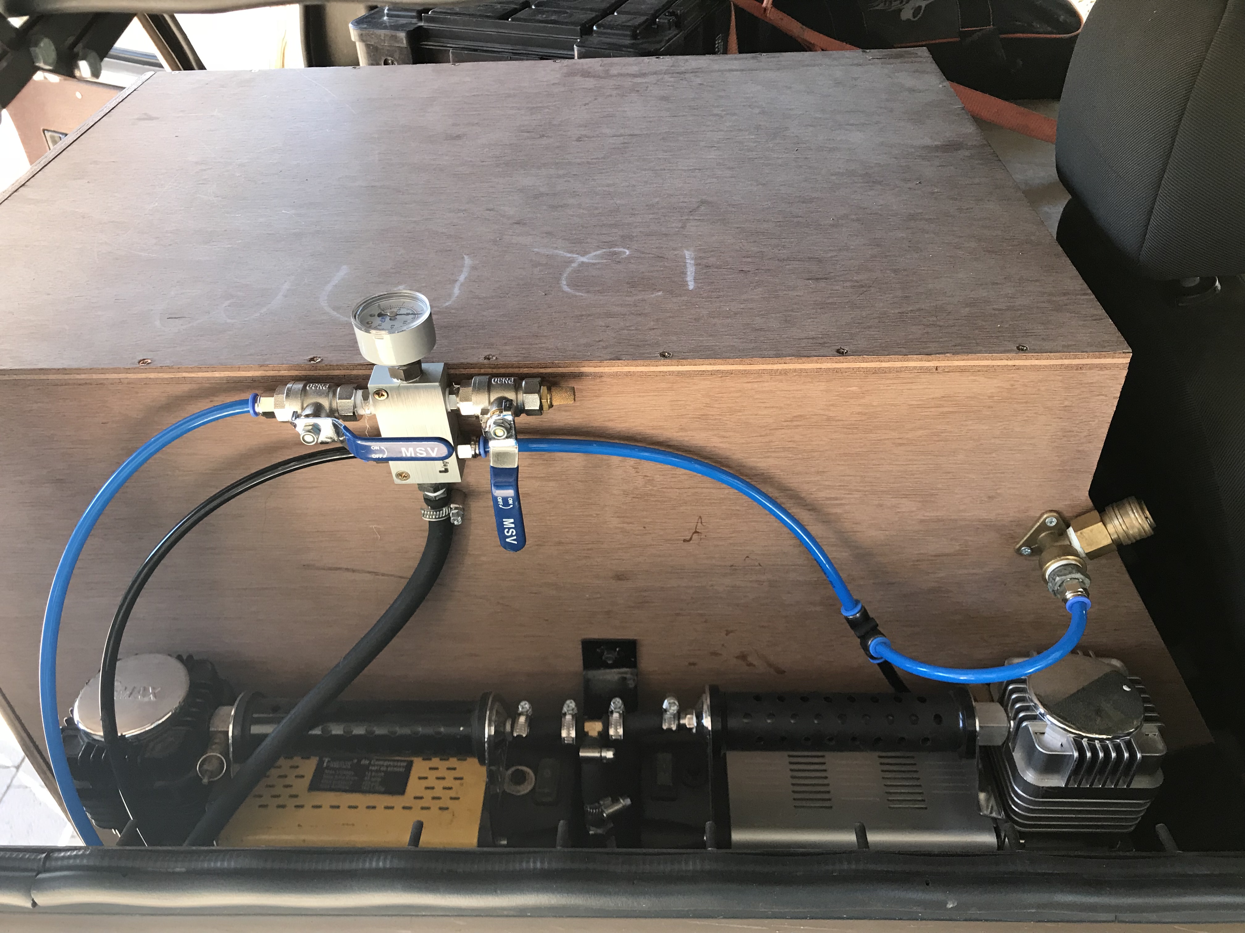

I Bought 2 of those 160 L/min Adendorf compressors, think about R1400
Hooking up both works very well but my alternator just cant keep op with roughly 90A. I believe the petrol engines has bigger alternators and could cope better. I have researched the issue quite extensively and the other 2 alternatives is either:
ARB twin piston at roughly R10 000 but pumps insanely well
Endless air system with a second Air con compressor and quite a bit of fiddling around to get it to work, I think a air con pump would be about R2000, then you have to consider brackets (possibly laser cut) belts, fittings, time, effort and the testing of ones patients in trying to make it work and fit, electrical, cutout pressure switch etc.... And suddenly one has equated easely R10 000 now that I think of it.
Considering that I have built quite a complicated system with the cheap adendorf compressors that seem to be the best alternative at the moment, even the effort I have spent and "school fees" I might as well have just bought the ARB one and get it over with.
One thing I can certainly say it that is very pleasant to have a built in system. It proved itself again this last trip that the ones with loose compressors would rather wait for me than to take out their pipes and bags and wires and open the bonnet and balance the whole contraption on the bumper because otherwise it sucks in sand.... But I also have proved hoe difficult one can make it on yourself :rolleyes:
