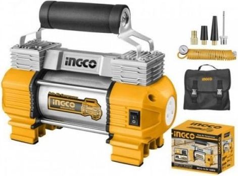

When I went form 29" to 33", I found it took me more than 1.5 times longer to pump them. That itself is not too much of an issue, the heat build up was though. I had my old pump heat trip once or twice when I was pumping from 0.8 bar back to 2. Now I am worried that a 160L/min won't be up to pumping the 35's I wan't to fit to the hardbody. May old 160 has packed up, and as my vehicle is stuck in the driveway at the moment, it's not a big issue, but when it comes to buying a new one, I don't know if I should be going for a 160 again.
I see very few places now advertise a L/min rating, they are all going with Amp and PSI ratings. I just called my supplier about this one, and they don't even know what the L/min rating is. Spec just reads:
Heavy duty air compressor With light
Power supply:12V,Rated current:18A
Max pressure:120PSI,
Duration working time:15minutes
5M air hose with a brass quick-releasing adapter 120PSI high-quality pressure gauge
3M cord with battery clips
with 3PCS LED
2x Cylinder diameter: 30mm

Considering that a 160l compressor draws around 40A, I suspect it's pretty small...
with 3PCS LED
David how concerning/sad is it if the suppliers can't even tell you the L/min ratings of their products. How do you know that the product will suffice for your individual needs or not.
