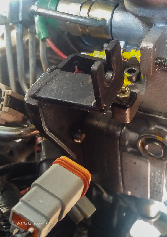

Other than that, a normally-aspirated TD42 would drop straight in mechanically. The engine mounts are interchangeable and in exactly the same place, the clutches appear to be the same. We did have to modify the bracket on the fuel pump that the accelerator cable attaches to, but the TB42's cable is just long enough to fit.

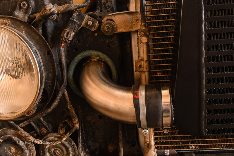

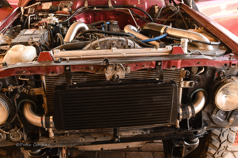

The hardest part was installing the turbo and intercooler. Tinus got me a great deal on an HT18 turbo and it's exhaust manifold (the standard Nissan units found on the last TD42 GU pickups). This was refurbished (all it needed was a new set of seals) and I polished the inlet and exhaust manifolds.

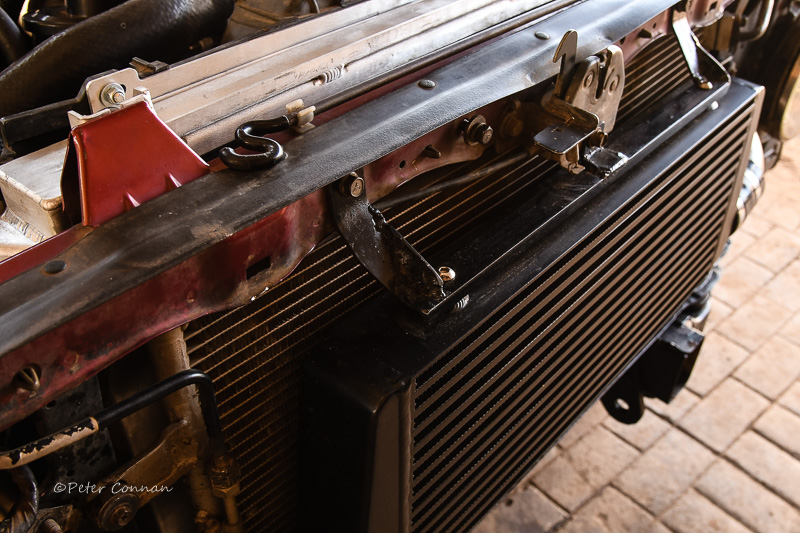

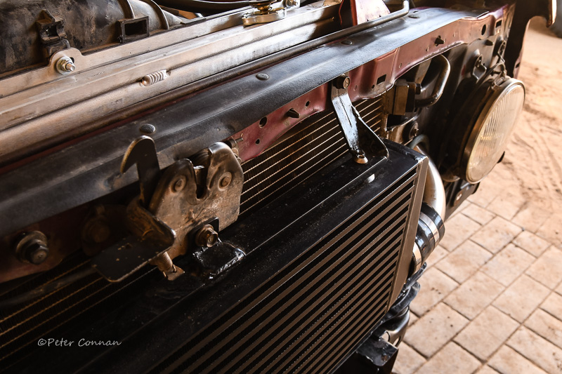

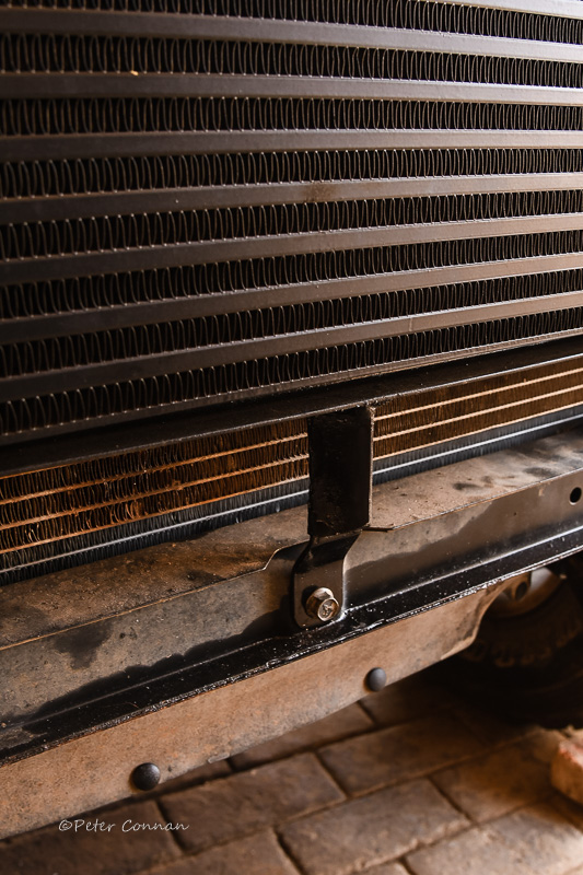

The intercooler is also from Universal Coolers. We took off the grill, removed the brace from the bonnet catch downward, fabricated new brackets and drilled two big holes through the body just above the body mount brackets. The intercooler brackets also brace the bonnet catch.
I got lucky and got a set of intercooler pipes from Tommie for a good price, and I just needed to modify one of the pipes a little bit. I then also needed to find a new place to mount the hooters and ambient temp sender unit, but that was pretty easy.
