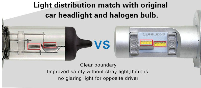

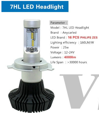

Cedric, beware the horrible abomination that results when pidgin English meets a non-technical marketing department! These blokes quote the combined power consumption of the bulbs, i.e. what they will use when both the brights & the dims are operating at the same time. This is not how headlights work, though. Real life wattage (power consumption) is half of what they say, which in turn is less than a normal halogen bulb. Therefore I did not upgrade my wiring looms because these LED bulbs use only 25W per side, which is roughly half the current draw from before.ricster wrote:Christo, did you need to upgrade the wiring to accommodate the 160w ( 80w per side ), or is the power draw on these LED's different?

I would not buy any of the bulbs you found because they do not mimic the shape of the standard bulbs. They have a single fat LED, whilst halogen bulbs have a longer, thinner wire as a light source. The dim wire should sit further away from the reflector to ensure a more focused beam, with the bright wire closer to the reflector for a wider focua. It also has a little cap below it to prevent light from shining down onto the reflector, because this light will be bounced upwards through the lens & mess up the clean cut-off that you want on dims. Finally, they have a blanking area at the end of the bulb to prevent unreflected/unfocused light from shining straight out at the road. The bulbs you found have none of these features, so I'd expect them to have a poor focus & light pattern.I also see these "butterfly"ones ( 160w ) for quite a bit less than the ones you posted. What do you think of these
http://www.ebay.com/itm/2x-80W-160W-160 ... x1&vxp=mtr
BTW: The bulbs from Extreme Lights do have all the features I mentioned above, but they have only 12 (as opposed to 16) LEDs...
