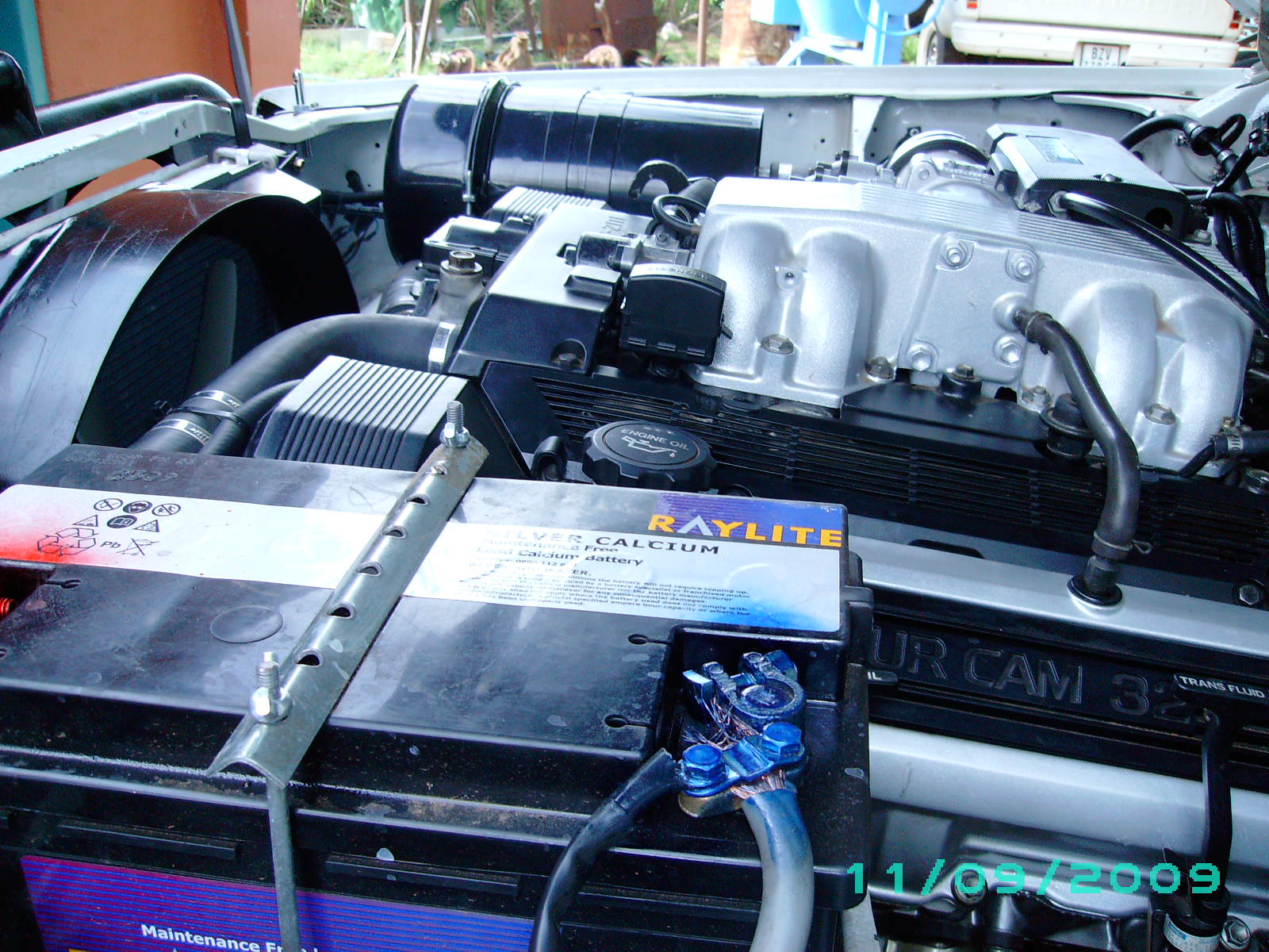

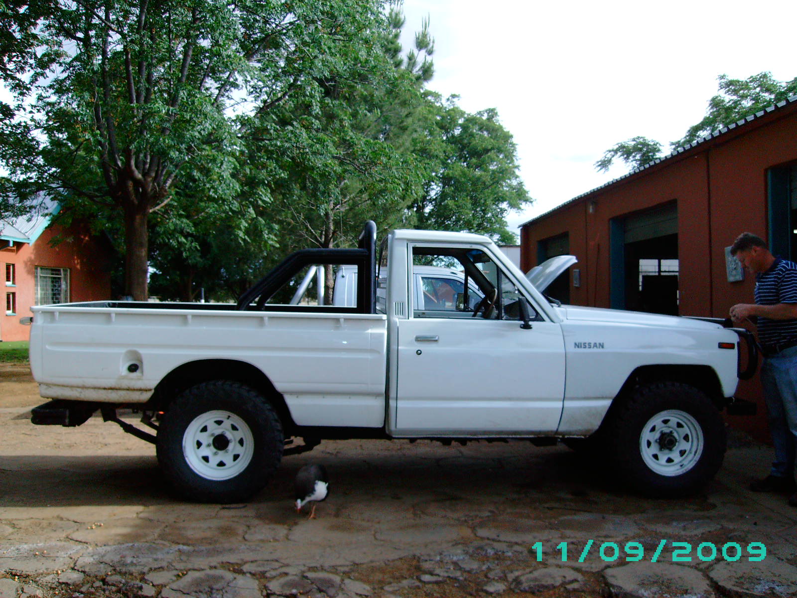

Attie who performs the transplant in Lasarus from 3.0Di to 4.8 also did this conversion with a Lexus V8 into the Safari bakkie. It is a very very neat and professional job. I test drove the Safari - unbelieveable!
- Safari - Lexus.JPG (322.4 KiB) Viewed 2647 times
- Safari - side.JPG (313.36 KiB) Viewed 2647 times
