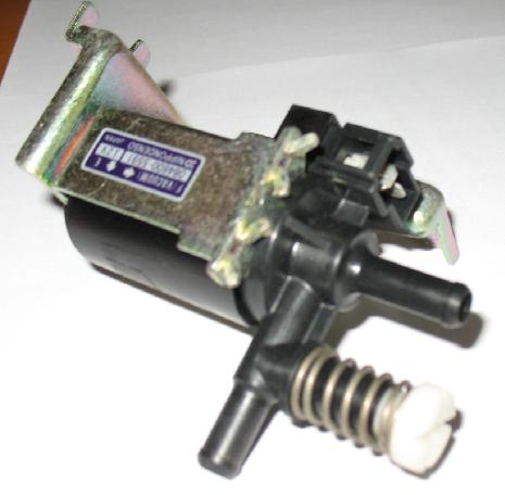

Diff Lock Vacuum Solenoid Valve- Alternative
Post by TheSourcerer »
Hi to all
Have struggled to find VSV's even from the dealers.
I was so fraustrated that I got my son to bring me back the following generic Nippon Denso VSV that the Ausie boys use for both the Patrols and the Cruisers.
This unit has an adjustable screw to set your vacuum pressure requirement.
The l/Crisuer unit has a round two pin plug on the front which is converted to the T shape two pin plug.
See attached picture.
I now have two units left. Brand New - Price R900 each.
Alan
[img]ND%201.jpg[/img]
ND 1.jpg (21.88 KiB) Viewed 2838 times
