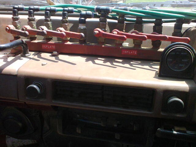

I have been trying to load my photos of my central tyre inflation system , but I seem to have a problem with my laptop .
I've asked JULES to load the photos for me , from his side . Lets hope JULES can do it for me .
My new swivels that I am prototyping at the moment , will fit inside the wheels way out of harms way (internal fitment) .
JULES ?
JULES ?

Sorry for the delay ! (it helps to send the photos to the correctly spelt email address)
I thought JULES had perhaps forgotten to post my photos .
They will be posted shortly . Thanks Julius for your help !

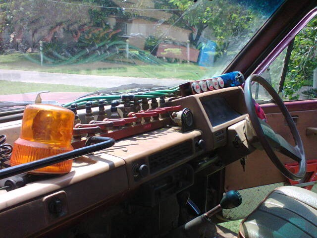

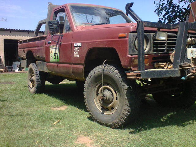

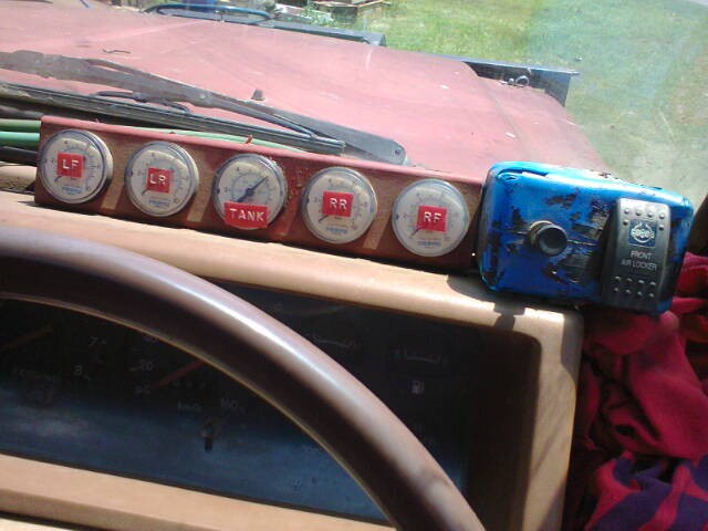

Re: Rapid inflation deflation system
Morning
Herewith the pics from Brett

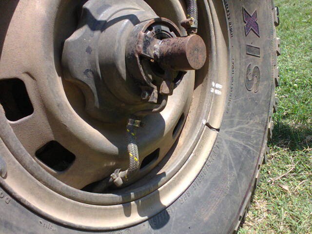

Very good engineering, would like to know more about the hubs, and how the seals hold up, although you mention that you have had 10years of use out of them. How many kilometres?

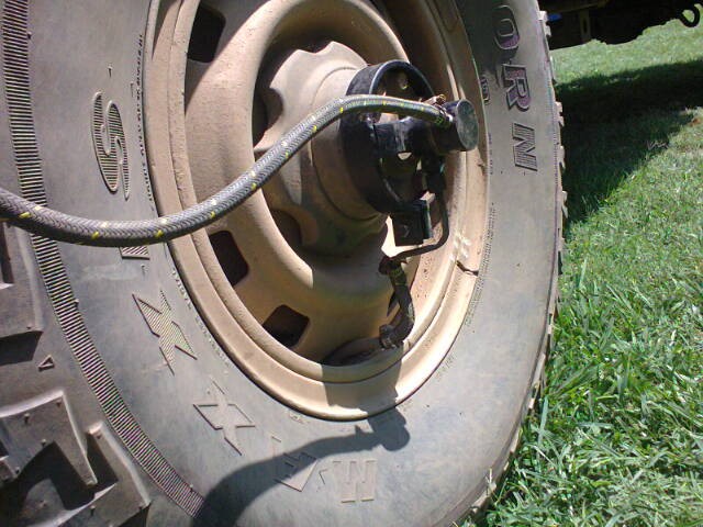

Good day SID .
The hub brackets and swivels were made by myself , the brackets use a single 6mm pinch bolt to attach to the vehicle hubs . The bearings and seals are all standard common sizes . The pipe fittings are also standard 1/8th gas thread with the steel pipes being brake tubing . The flexible hose is braided stainless steel . The tubing for the rest of the system is 8mm nylon , as used on big trucks . Mileage wise , they have done about 50-60 000km . On quite a few of my river trips , I have submerged the swivels in wet river sand , and they handled the abuse quite well . In light bush they perform well , and only have problems with big thick sticks which pull the pipes off , or bend the steel pipes . Deep mud is not a problem , but rock crawling in the big stuff is tricky .
My new system that I am working on has a few engineering "challenges" which I am trying to resolve before I can fit the system to my vehicle for testing .
