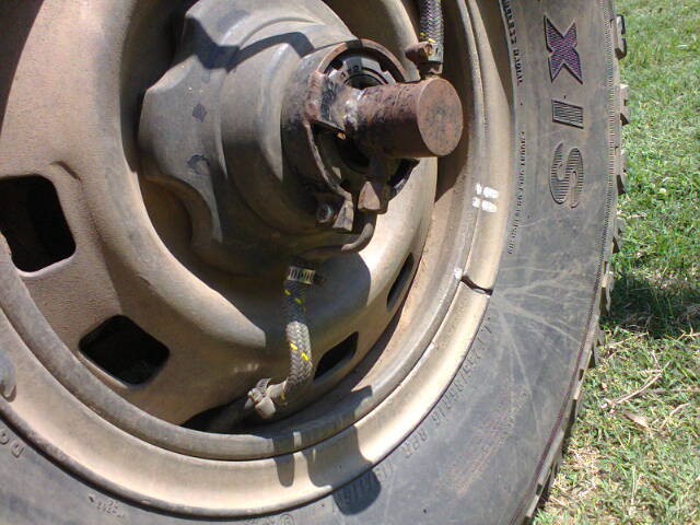

Rear wheel.jpg (91.16 KiB) Viewed 8991 times

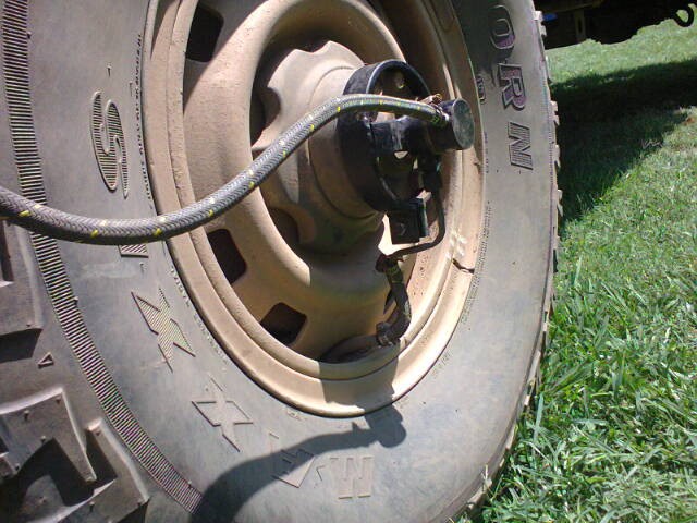

Front wheel.jpg (85.57 KiB) Viewed 8991 times

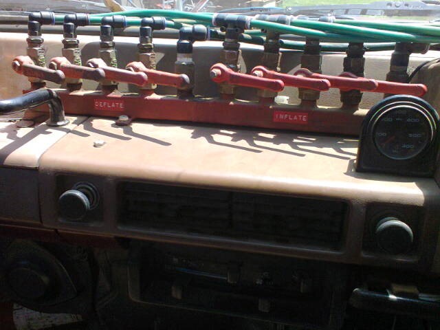

Valves on manifold.jpg (63.41 KiB) Viewed 8991 times

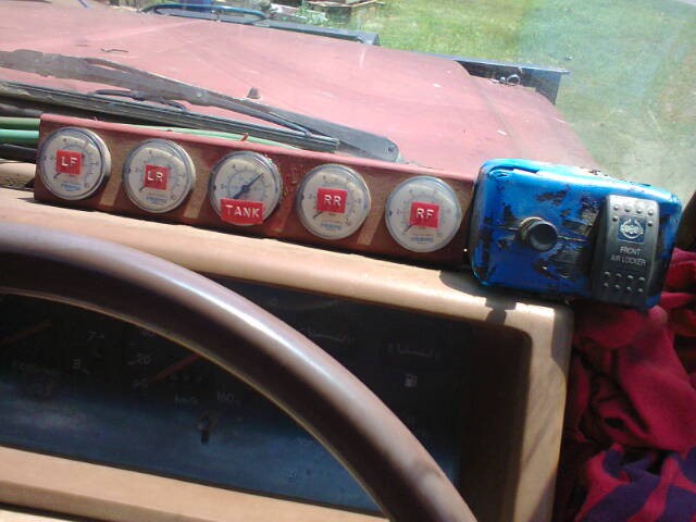

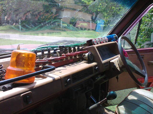

Dash view.jpg (83.99 KiB) Viewed 8991 times

Very good engineering, would like to know more about the hubs, and how the seals hold up, although you mention that you have had 10years of use out of them. How many kilometres?

The hub brackets and swivels were made by myself , the brackets use a single 6mm pinch bolt to attach to the vehicle hubs . The bearings and seals are all standard common sizes . The pipe fittings are also standard 1/8th gas thread with the steel pipes being brake tubing . The flexible hose is braided stainless steel . The tubing for the rest of the system is 8mm nylon , as used on big trucks . Mileage wise , they have done about 50-60 000km . On quite a few of my river trips , I have submerged the swivels in wet river sand , and they handled the abuse quite well . In light bush they perform well , and only have problems with big thick sticks which pull the pipes off , or bend the steel pipes . Deep mud is not a problem , but rock crawling in the big stuff is tricky .
