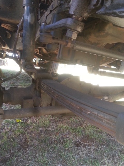

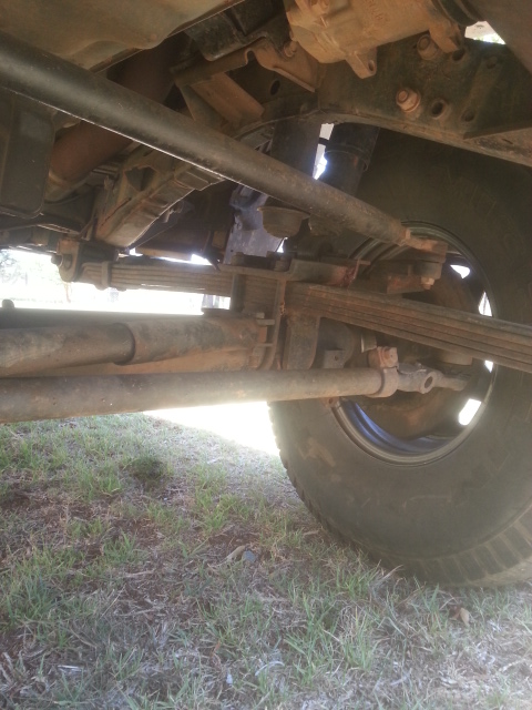

Wow that is a first class drag link you got there!
I have emailed Patrol A part for a shipping quotation for an adjustable drag link which is very similar to your one. 345 Aus dollars for the drag link.
I want to centralize the steering box 100% and the only way it can be done correctly is with an adjustable drag link.

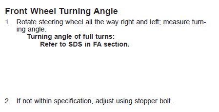

I usually agree with you, but this time I must differ! According to the service manual the stopper bolts determine how sharp you can turn.
I want to turn sharper

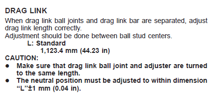

The drag link has a set length (1123.4 cm) and the adjusters should be used to accomplish this:

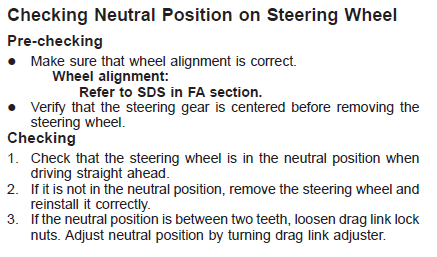

Finally, straight-ahead position is achieved by removing the steering wheel. If you have an adjustable drag-link, you may fine-tune the steering position there. I was able to get my steering wheel pointed perfectly straight without an adjustable drag-link - the splines are fine enough.

This is correct but you need to first make sure that you have centralized the steering gear which is the steering box before you centralize the steering wheel on its splines as per your attachments. Nissan stopped making adjustable drag links around year 2000 and then they set it at factory 1123.4 cm and weld the tie rods onto the bar so you cannot adjust it :thumbdown: The steering box has marks on it to show you when its centralized.
