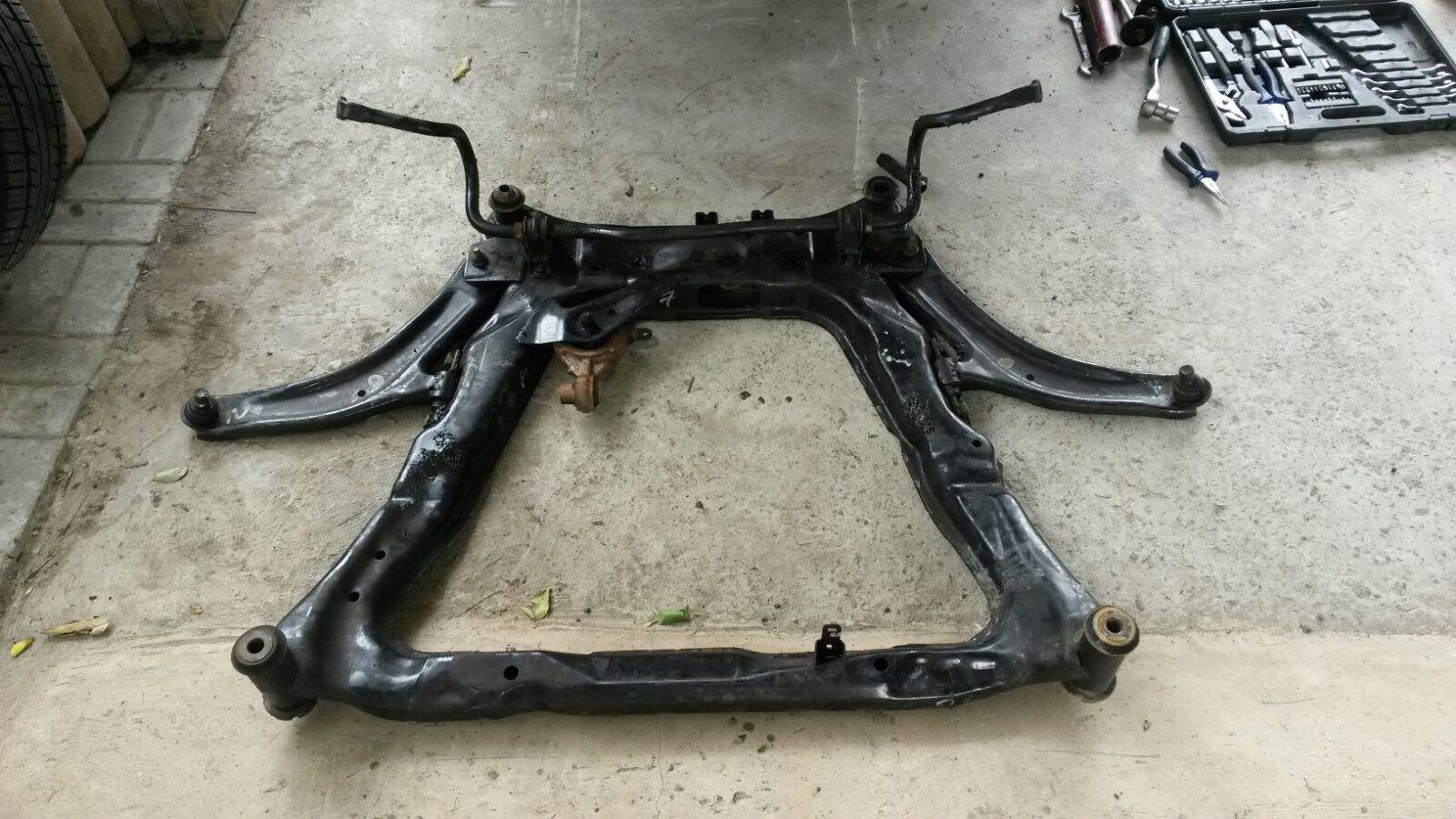

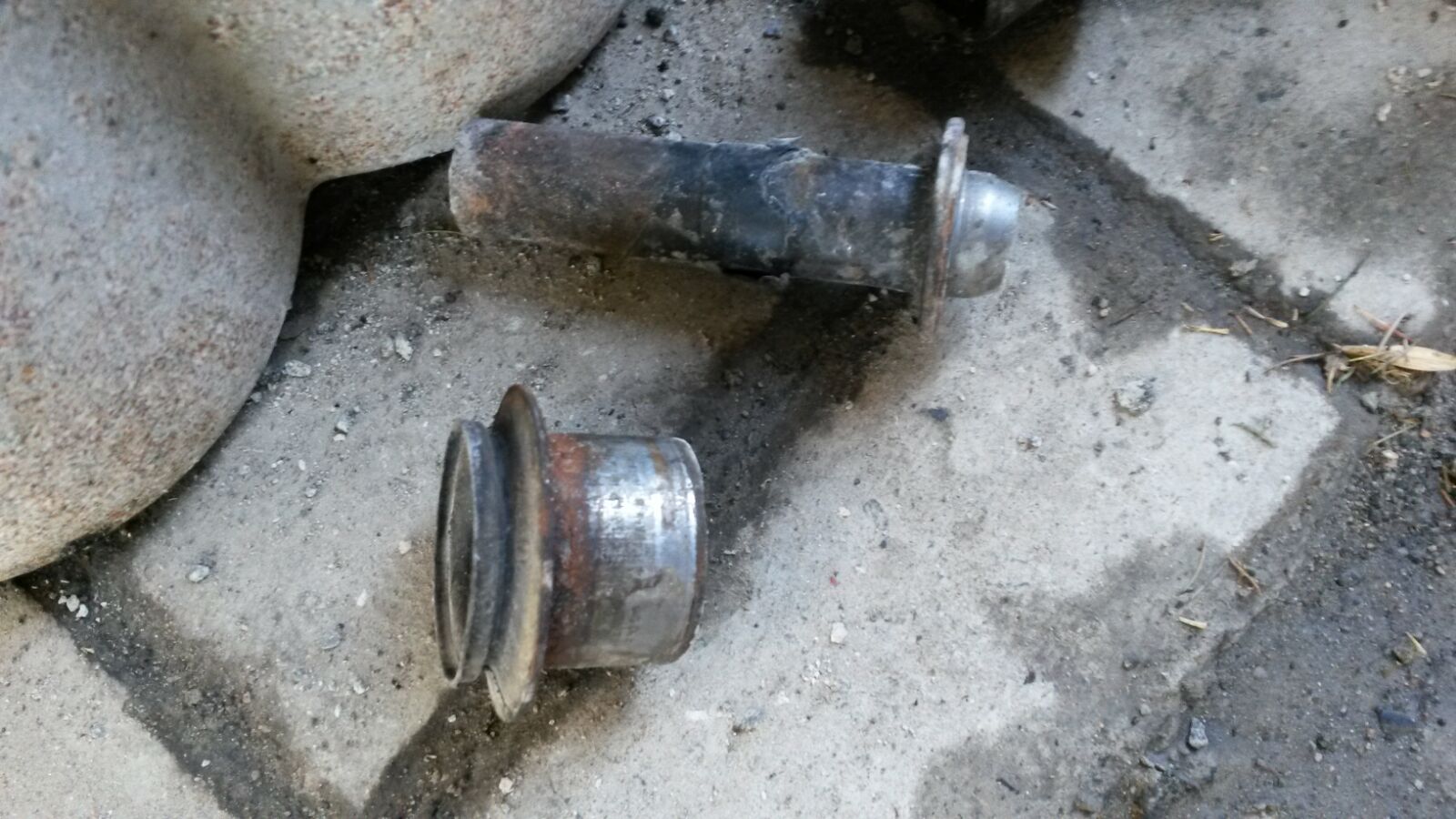

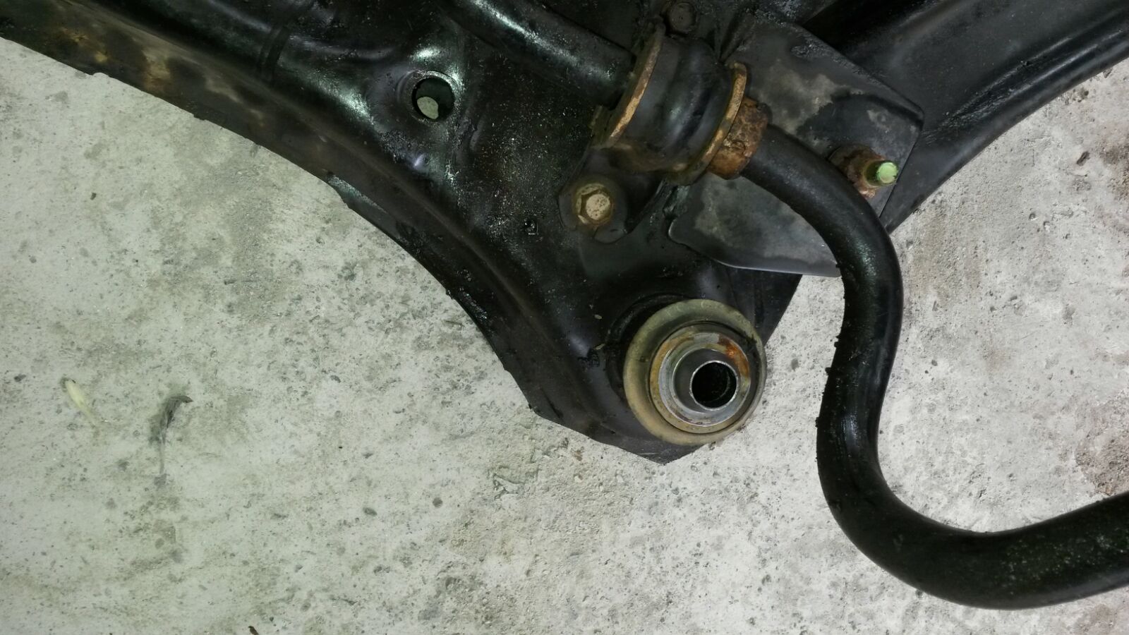

I had a terreble clonking noise on a recently acuired Qashqai. Turns out it is the subframe bushes that mounts on the body on the cab side. Bush costs R180 at the stealers. After they tried convincing me I must buy a complete subframe. Then sayd it would be 2.5k in labour to replace it. Well I stripped the subframe out today and removed the bushes in 2h45 min, without fancy tools, by myself. The new once will be hear tomorrow then I will put it all back. So dont under estemate bushes.
