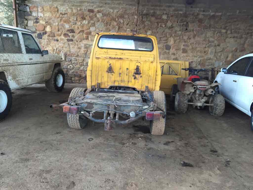

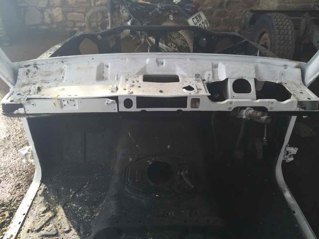

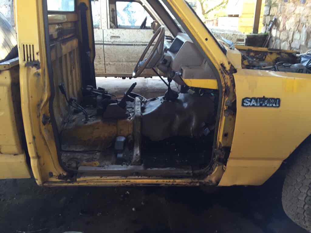

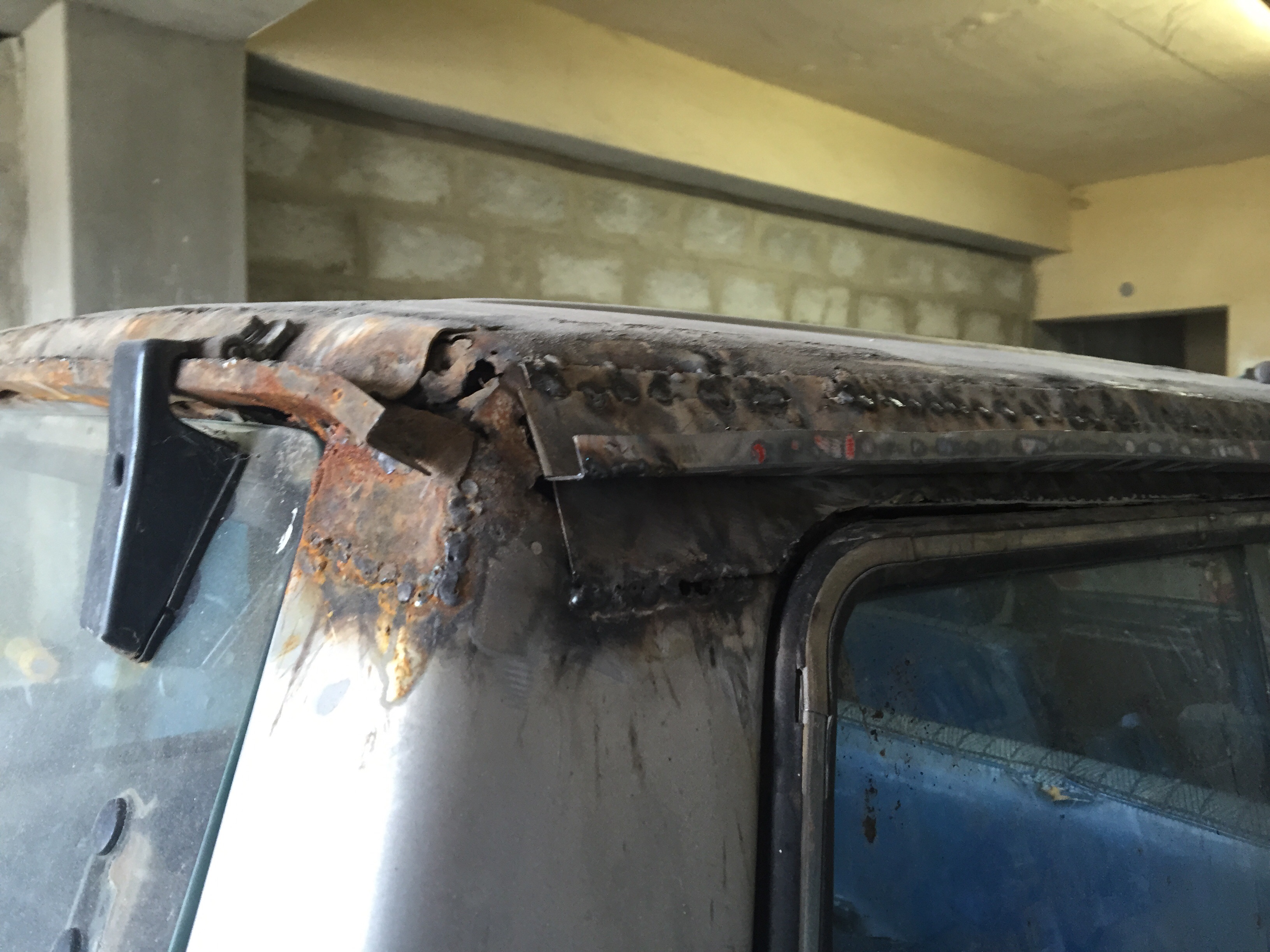

Re: 1984??? Safari pickup build

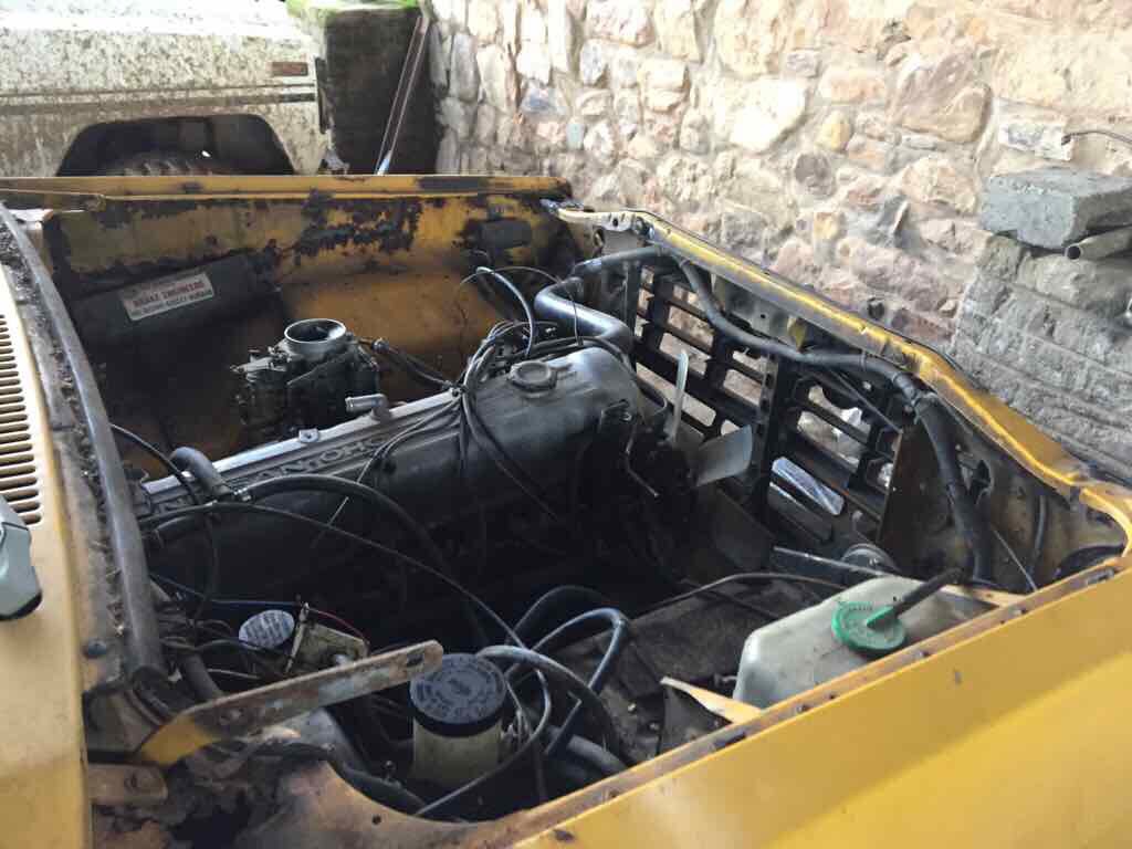

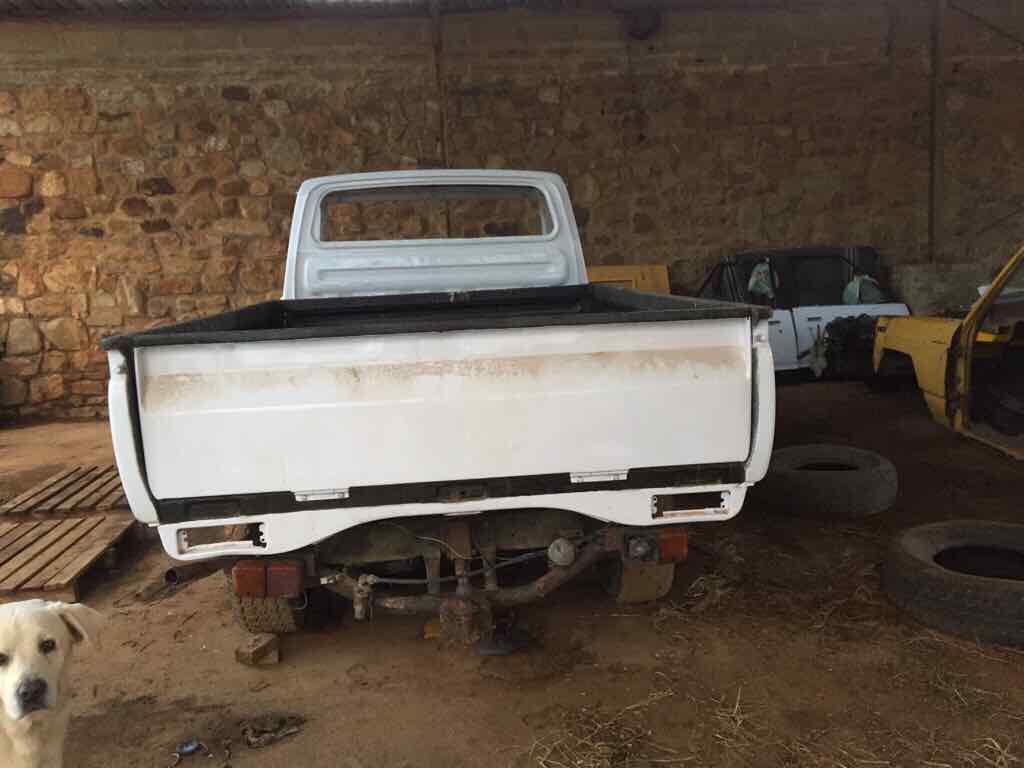

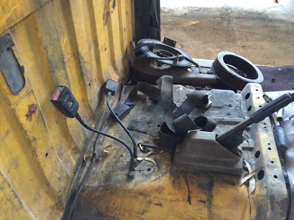

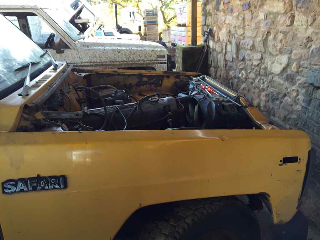

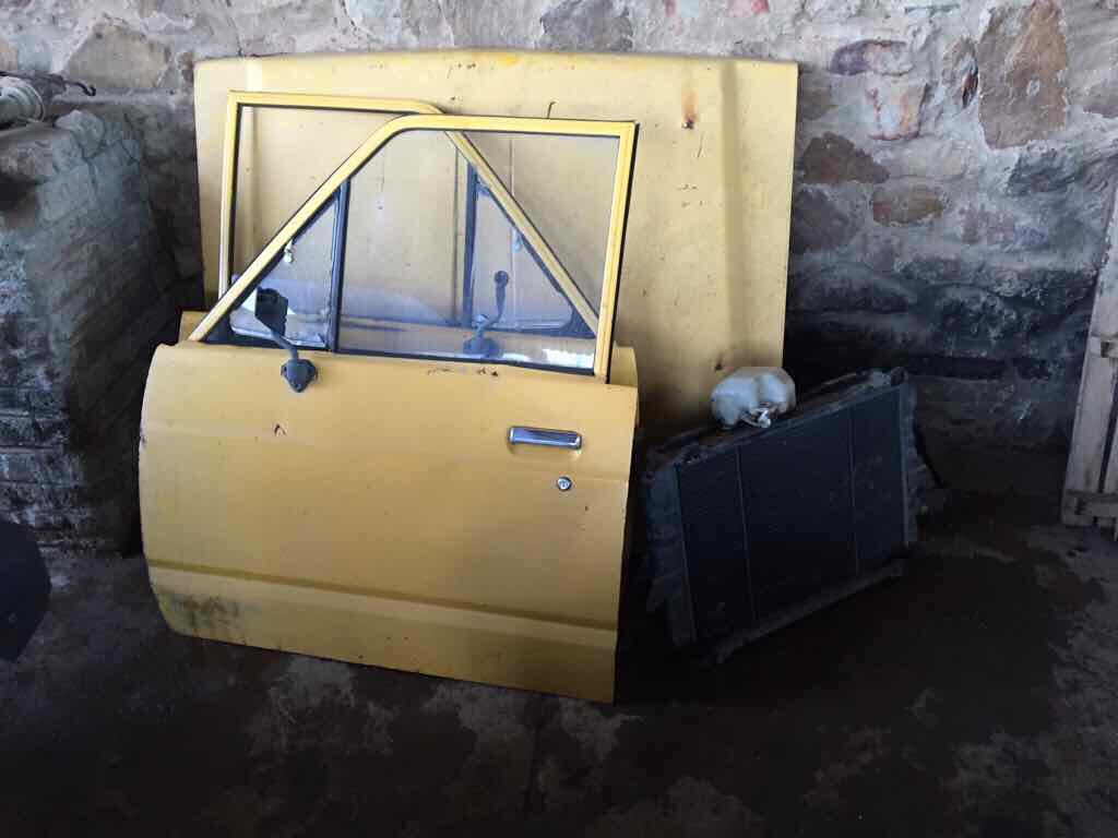

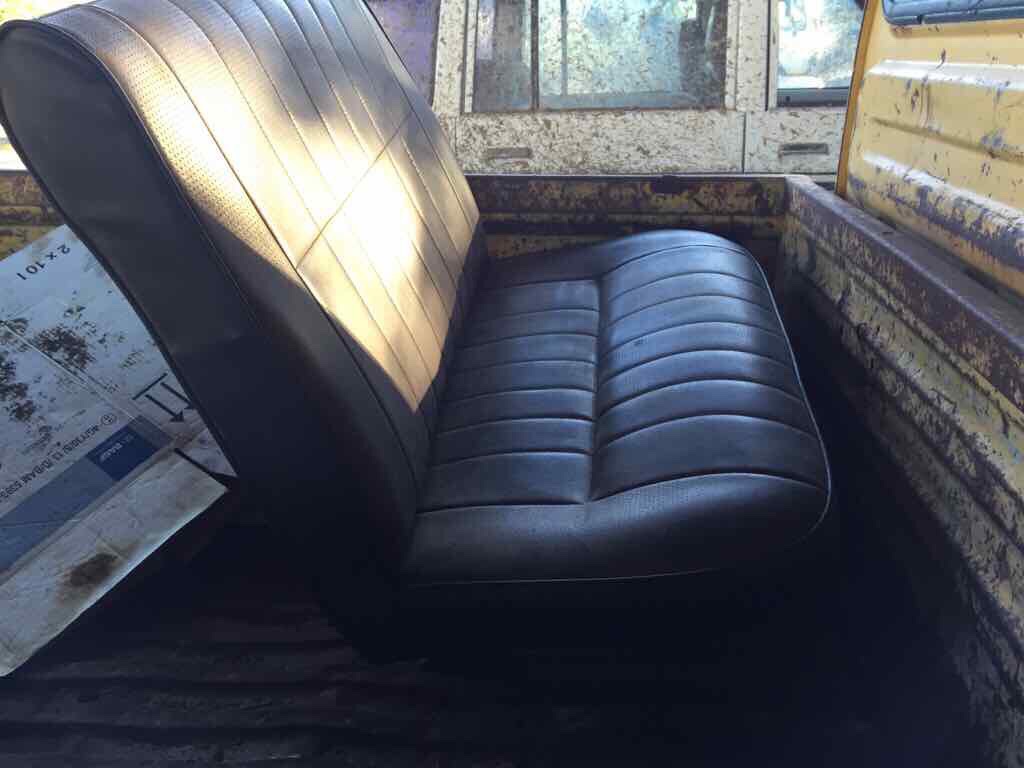

En toe om die ou cab en engin uit te strip
- image.jpg (120.77 KiB) Viewed 6329 times
- image.jpg (83.02 KiB) Viewed 6329 times
- image.jpg (100.47 KiB) Viewed 6329 times
- image.jpg (100.06 KiB) Viewed 6329 times
- image.jpg (99.94 KiB) Viewed 6329 times
- image.jpg (105.66 KiB) Viewed 6329 times
- image.jpg (91.07 KiB) Viewed 6329 times
- image.jpg (93.16 KiB) Viewed 6329 times

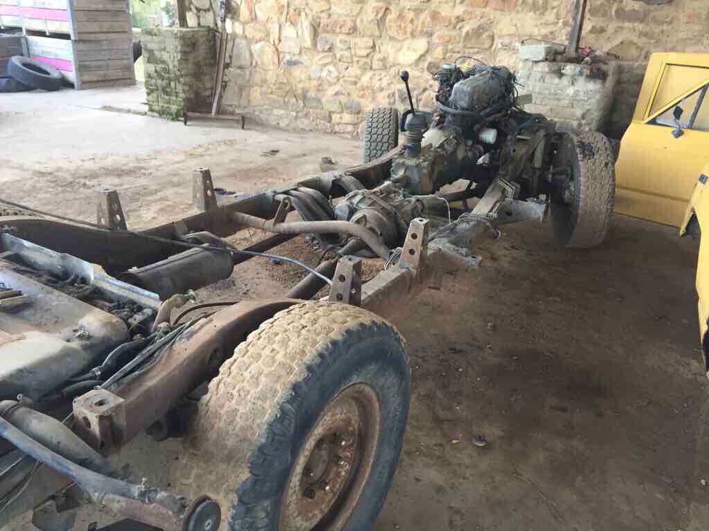

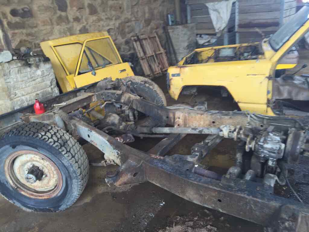

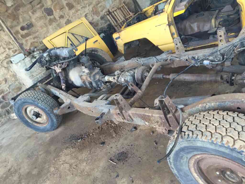

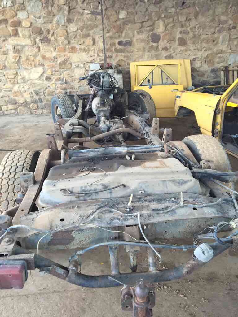

En verder strip
- image.jpg (112.7 KiB) Viewed 6328 times
- image.jpg (119.76 KiB) Viewed 6328 times
- image.jpg (117.56 KiB) Viewed 6328 times
- image.jpg (140.74 KiB) Viewed 6328 times
- image.jpg (138.47 KiB) Viewed 6328 times
- image.jpg (121.06 KiB) Viewed 6328 times

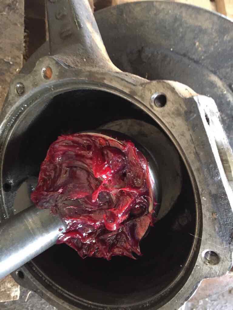

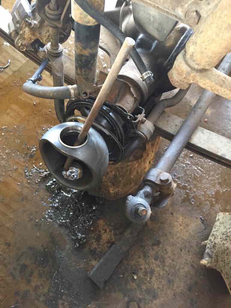

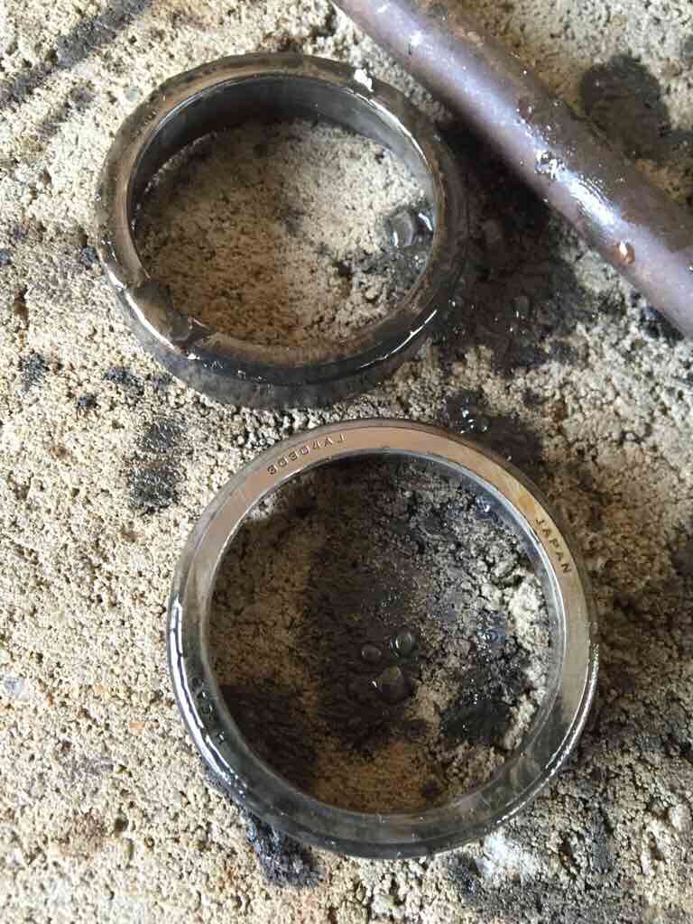

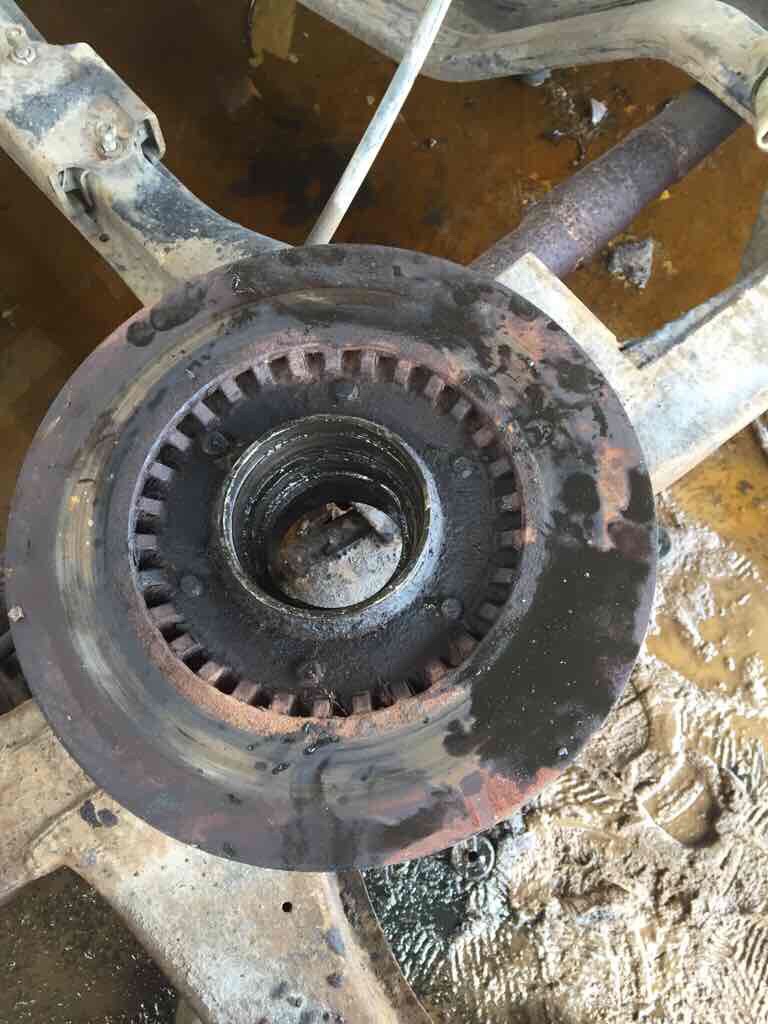

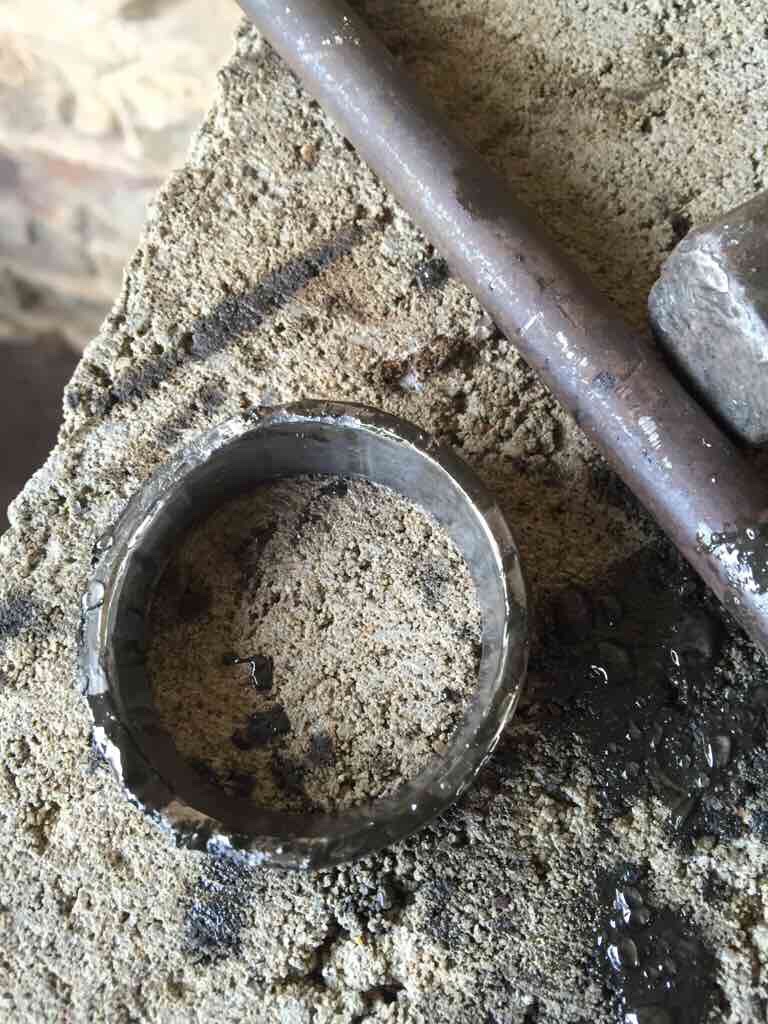

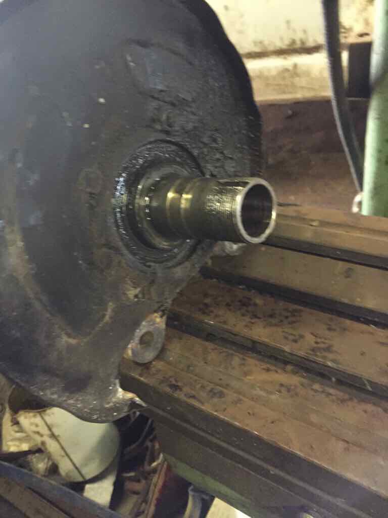

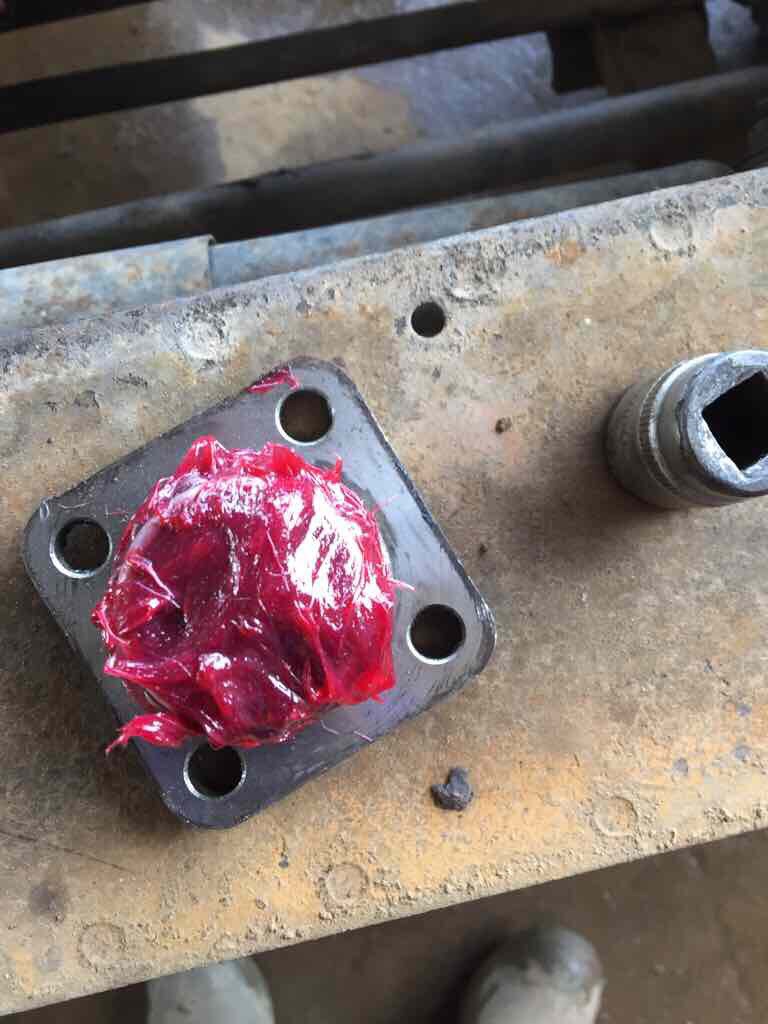

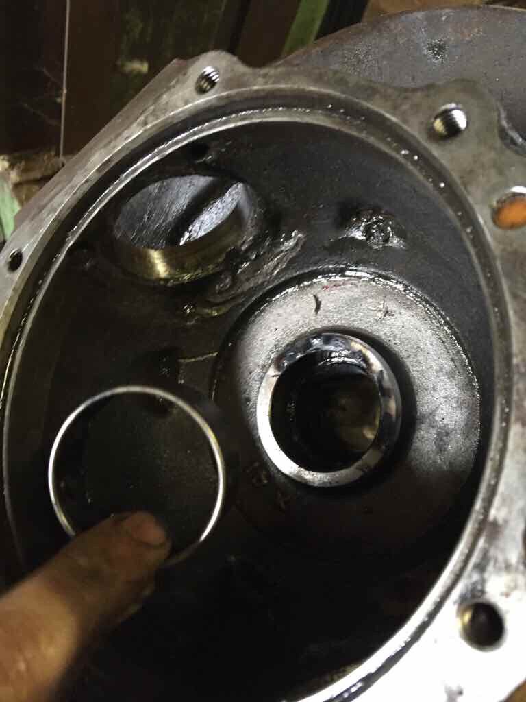

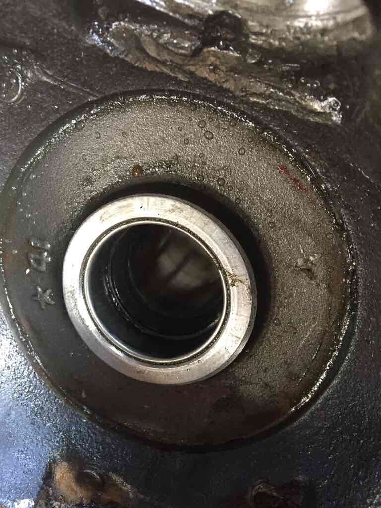

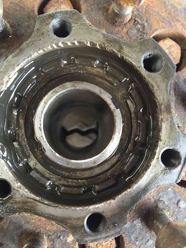

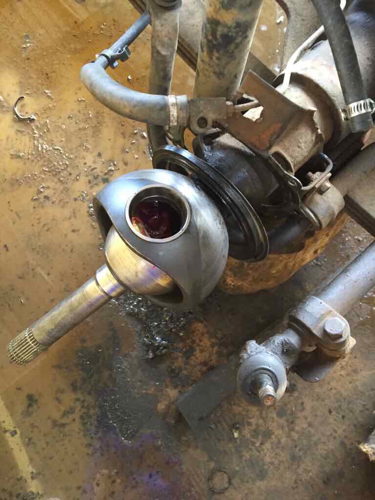

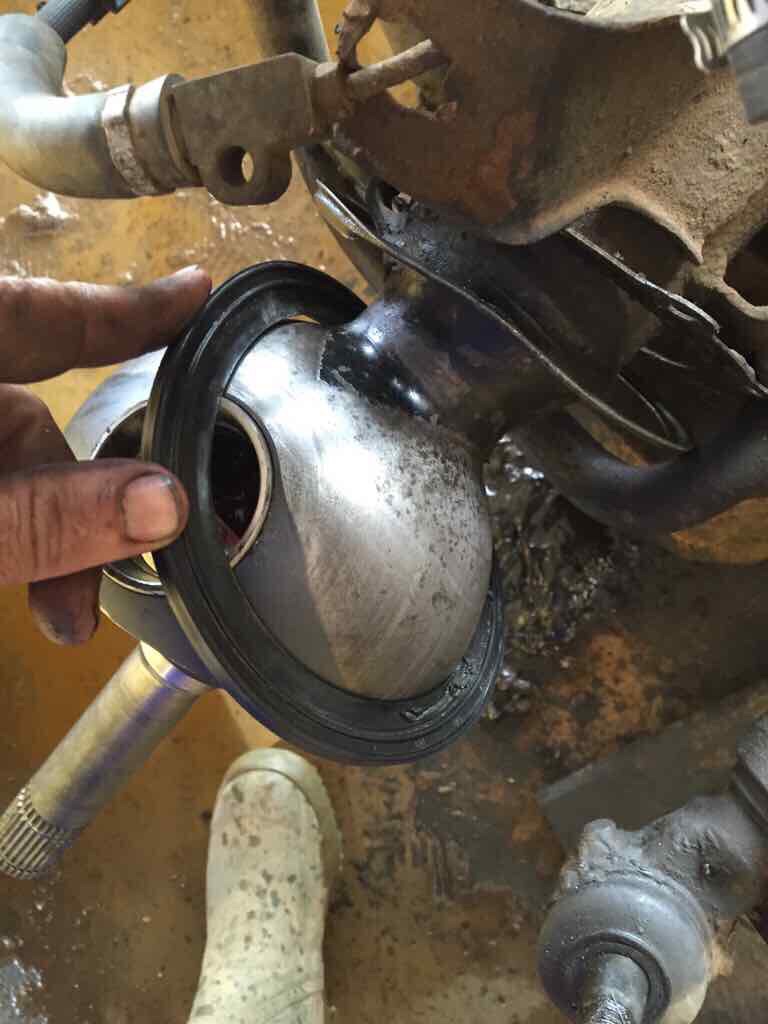

Voor hub se kingpin bearings en wheelbearings word vervang
Bearing sizes:
30304
30209
LM501310
Seel: 88 65 7
Needle bearing: 42 35 16
Burfield seel: 138 148 7
Vergrygbaar by jou naaste bearing plek
Bearing sizes:
30304
30209
LM501310
Seel: 88 65 7
- image.jpg (95.27 KiB) Viewed 6328 times
- image.jpg (137.1 KiB) Viewed 6328 times
- image.jpg (93.12 KiB) Viewed 6328 times
- image.jpg (73.32 KiB) Viewed 6328 times
- image.jpg (144.24 KiB) Viewed 6328 times
- image.jpg (138.45 KiB) Viewed 6328 times
- image.jpg (200.28 KiB) Viewed 6328 times
- image.jpg (108.06 KiB) Viewed 6328 times
- image.jpg (101.88 KiB) Viewed 6328 times
- image.jpg (112.65 KiB) Viewed 6328 times
- image.jpg (202.31 KiB) Viewed 6328 times
- image.jpg (118.52 KiB) Viewed 6328 times

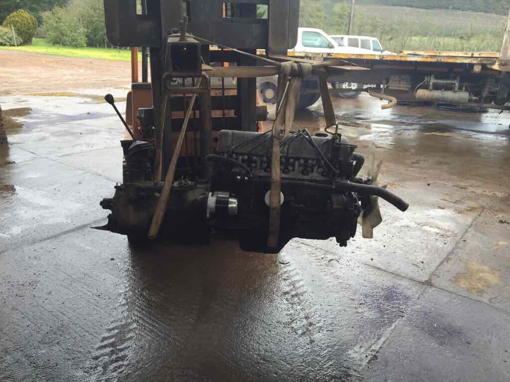

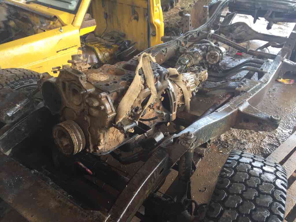

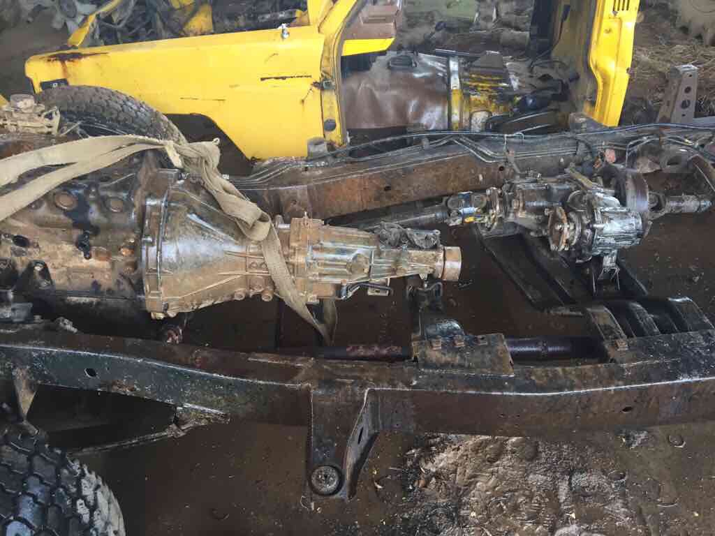

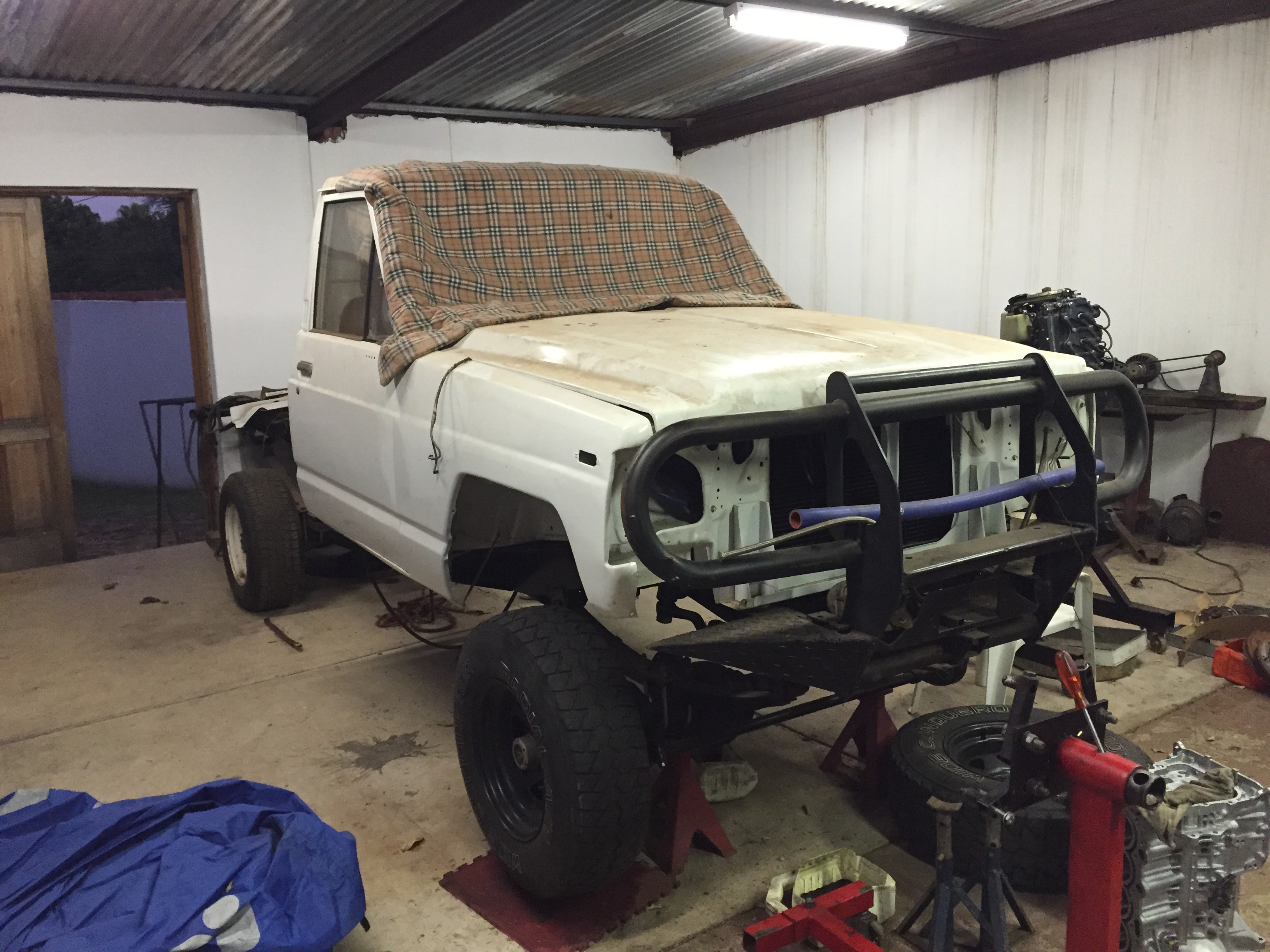

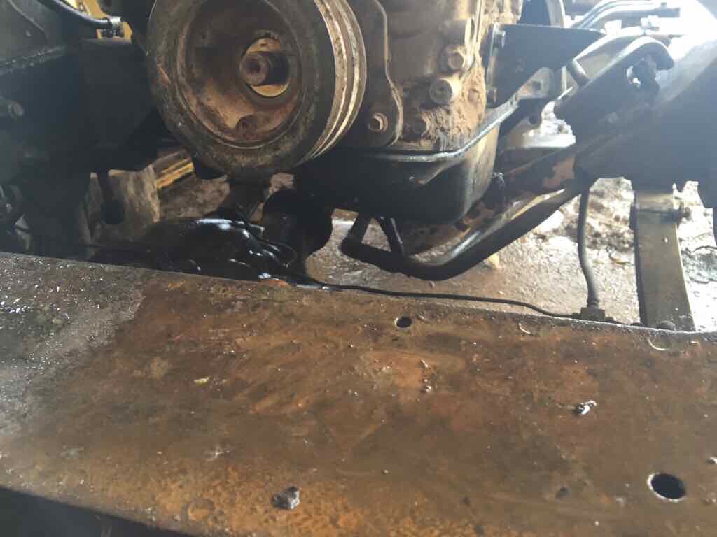

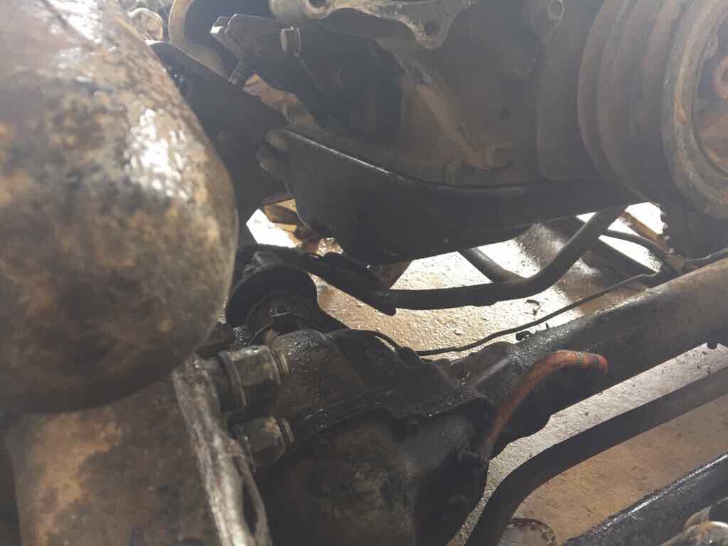

Dummy engin en gearbox om te kyk of die regte engin en gearbox gaan pas/veranderinge te maak.
Dit is n straight drop in, slegs agterste gearbox mounting moet 50 mm skuif
Sump clearance op dif lyk ook goed.

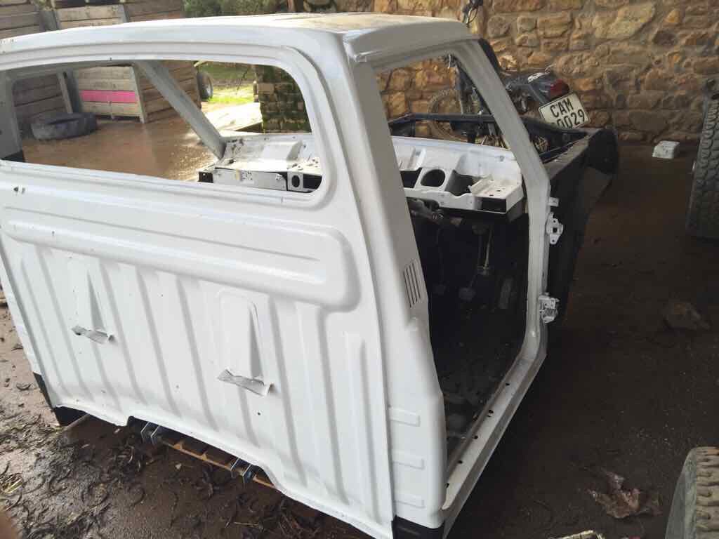

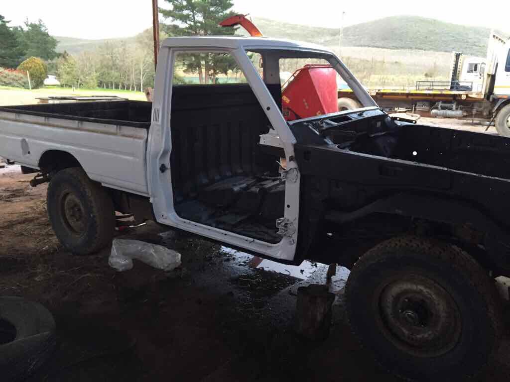

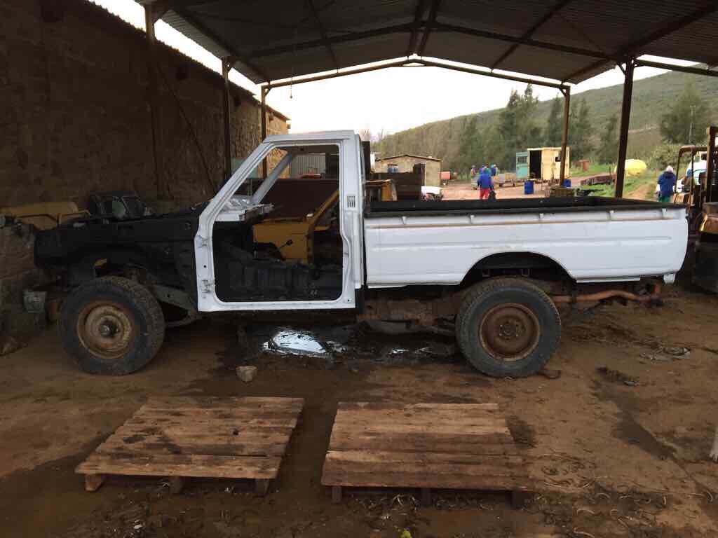

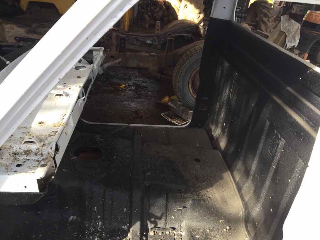

Kry nuwe cab en loadbox reg
- image.jpg (97.31 KiB) Viewed 6327 times
- image.jpg (88.37 KiB) Viewed 6327 times
- image.jpg (96.46 KiB) Viewed 6327 times
- image.jpg (109 KiB) Viewed 6327 times

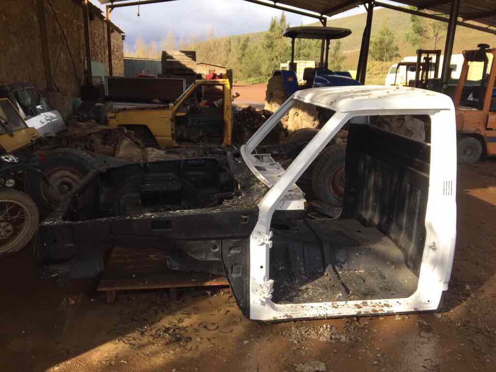

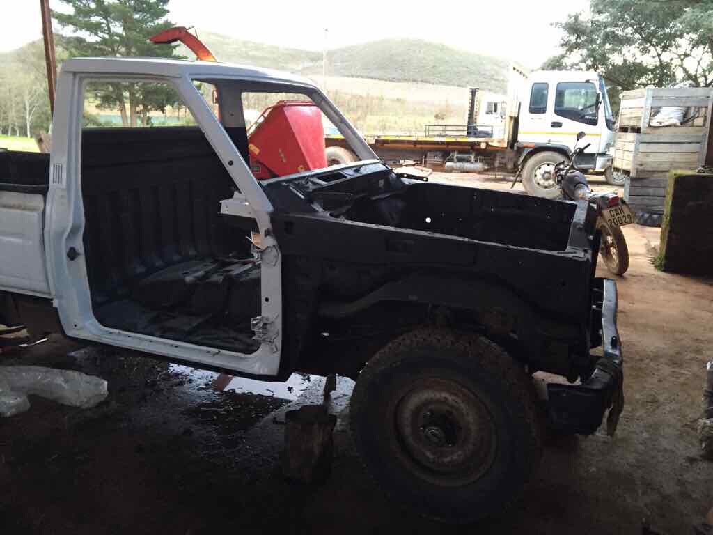

Begin darem weer na bakkie lyk.
Nou om elke liewe draaidjie, stukkie trim, en wat ook al uit die ou cab oor ye bou na nuwe een...

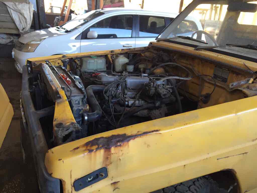

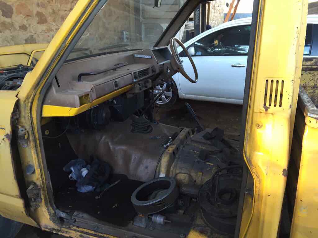

Mooi, ons maak hulle almal weer reg.
Td27, turbo intercooled, vanaf n Terano II
Besig met n safari stasiewa ook
