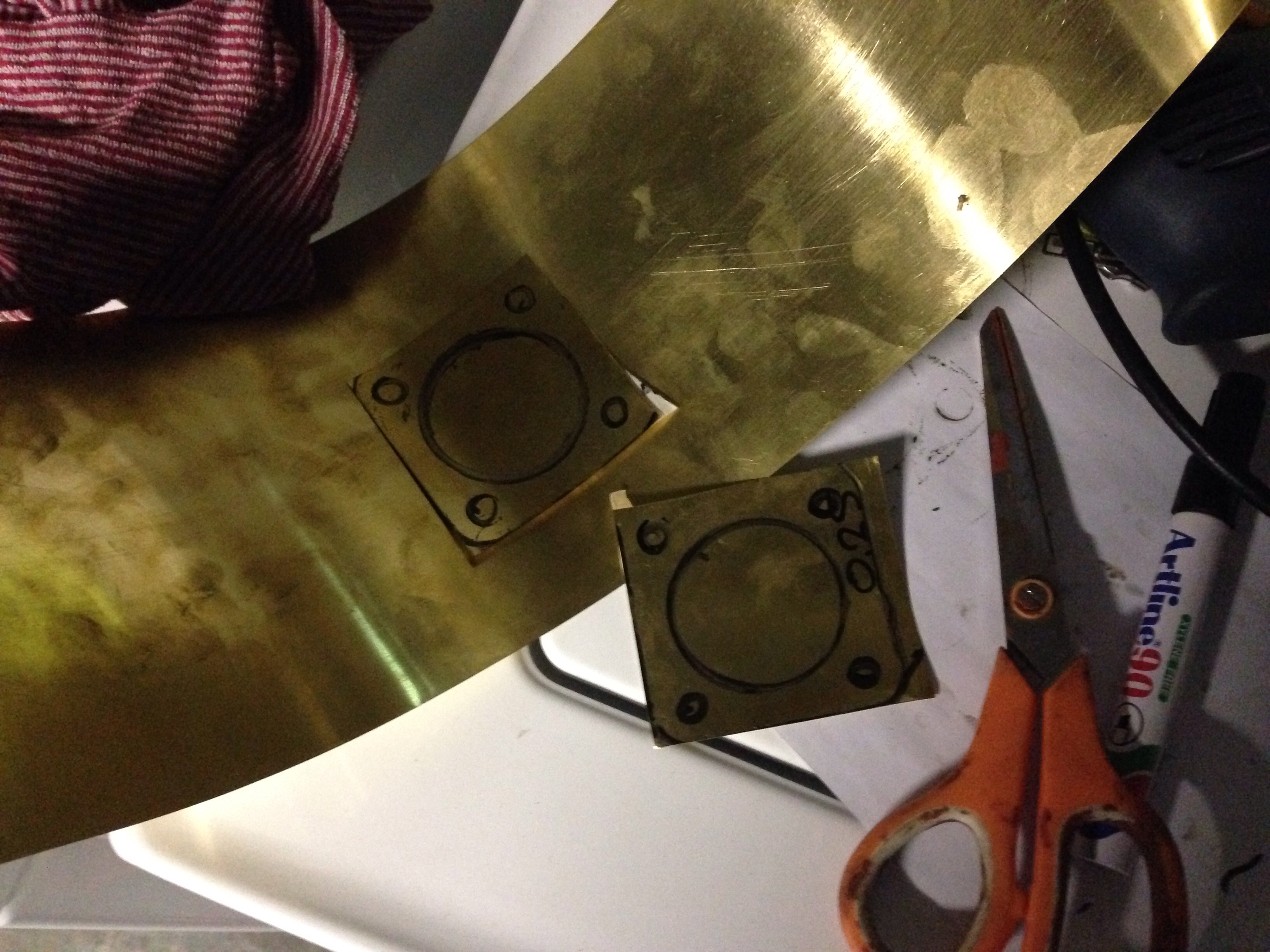

Called around and finally got some .25mm shim plate for free as it was an offcut. It is brass so hope it's alright to use, the company that gave it said it will be fine to use so holding thumbs.
I never knew it would be so hard to cut it into the correct shape though, took about 15 min per shim
- image.jpg (1.23 MiB) Viewed 3611 times
Re: Kingpin shims needed
haha.... yip cutting the shim stock is not the easiest, but 15 mins is a good time though.....
Brass will be 100%, you could use stainless steel too. just add one shim, tighten everything up and see how much Nm it takes to start moving the hub left to right. Then add another if needed.
