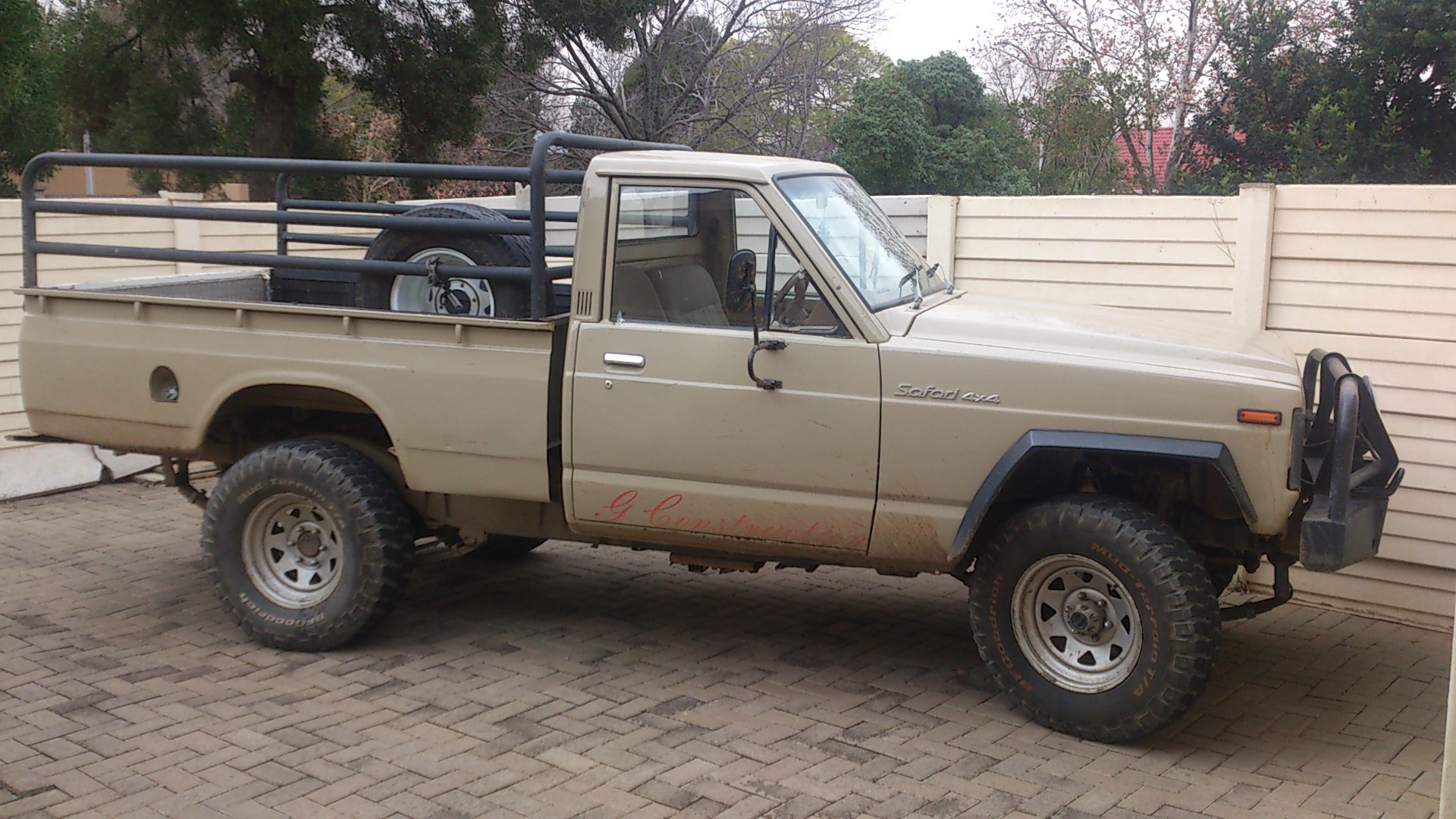

Post by Moeggesukkel »
Hier is my Bakkie,moet net nog dai rooi stickers by die deure afhaal.
