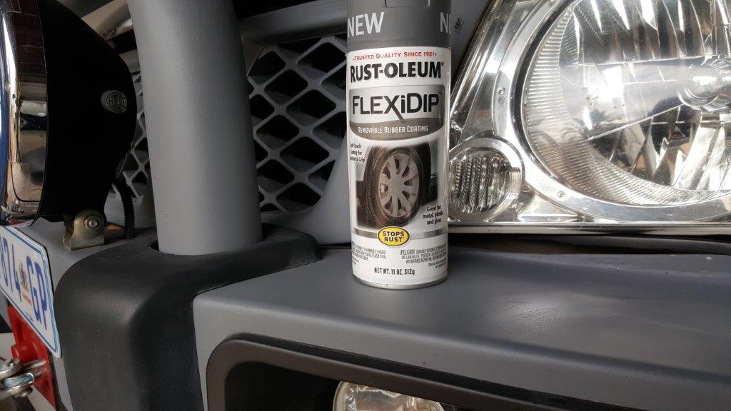

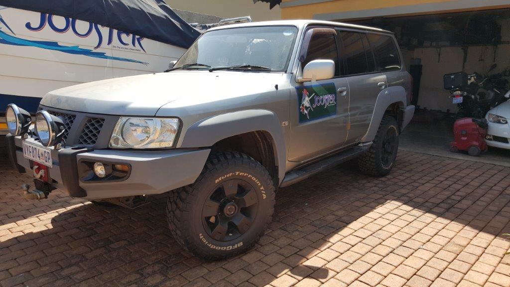

I did my rims with plastidip about 15 months ago - since then 3 times to Moz and towing on really bad roads/dunes/beach - still looks great...
Definitely recommend... but would use a newer product called flexi-dip - its a product made by Rust-o-Leum and sold in the spray can section at Builders.
I did my bumpers and wheel arches and grill with it and it seems a bit more forgiving and easier to apply.

Black rims is on my to do list... will give this flexi dip a try..Chris Skinner wrote:I did my rims with plastidip about 15 months ago - since then 3 times to Moz and towing on really bad roads/dunes/beach - still looks great...
