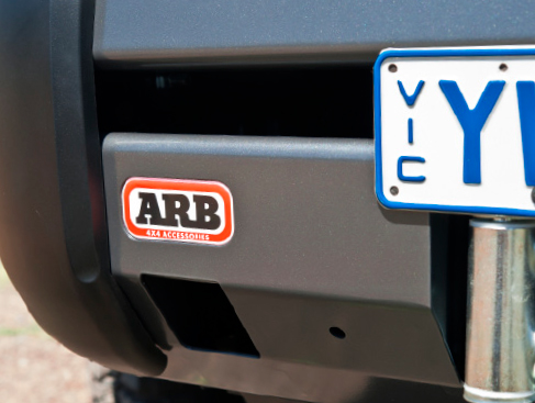

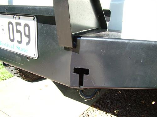

Ok so I am looking to make some High lift jack points on my newly built rear bumper, but just want some opinions on how they should look.
I don't want the round ones as you need another heavy adapter that needs to be in the tool box at all times but rather the "T" hole in the bumper or just a squire hole as in the ARB bumpers. The squire hole seems very easy to make, but not sure if it needs to be re-enforced on a 3mm steel bumper?
Opinions please.
Opinions please.

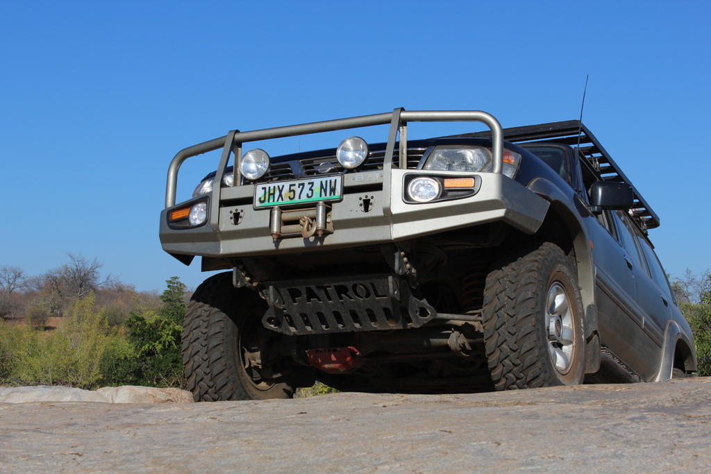

Re: Jack Points
The best one is like the ones on Bzt ones you can actually push the car of the jacks and it will work will ask Ian to post a pic

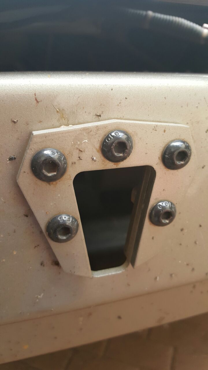

Re: Jack Points
As requested.Tinus lotz wrote:The best one is like the ones on Bzt ones you can actually push the car of the jacks and it will work will ask Ian to post a pic
Best photo I have at the moment. I do not have a chance to take photos at the mooment, but if you'd like more of a close up, please let me know and I'll take a photograph later.

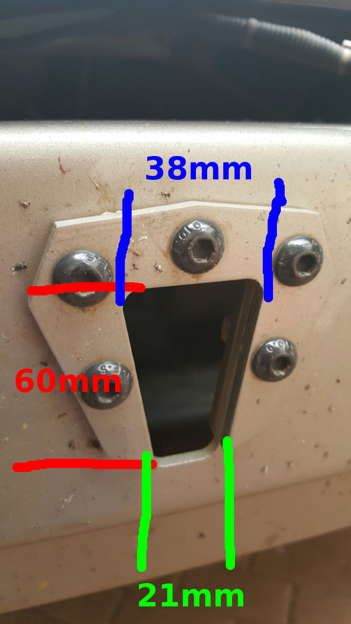

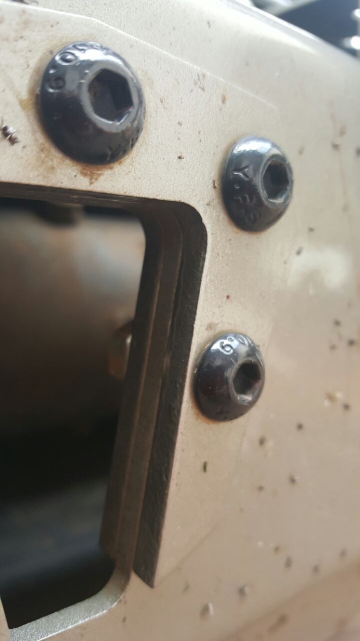

Re: Jack Points
Just a few close-ups of the hi-lift jack points on my front bumper.
The points seem to be simply the oblong hole cut in the bumper. The reinforcement consists of similar looking steel plates inside and outside and bolted together. All is 3mm steel. There is no additional reinforcement.
Excuse the "dirty" bumper - I see it has killed a few million innocent insects since it has last been washed...

Re: Jack Points
Thanks for the photos Ian

Re: Jack Points
Sorry - I posted, but then I realised I should probably give dimensions as well.
These are the dimensions I measured. The maximum and minimum widths are measured just before the "bends" start at the corners.
Once again, please acknowledge my awesome photoshop skills....
