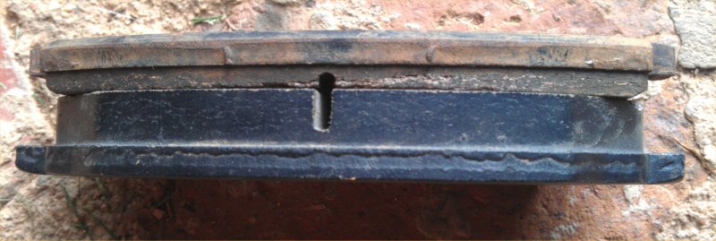

I went with these ATE brakes on the rear of Chuck - also meant for the front of an Astina if I'm not mistaken:
Friction material is identical
ATE 857 1.jpg (51.81 KiB) Viewed 5331 times
Backing plates are different
ATE 857 2.jpg (182.55 KiB) Viewed 5331 times
I used an angle grinder to trim away the steel marked in red.
A file would have taken way too long, but Cedric is much stronger than I am and he probably has a better file too! :rolling:

Re: Source for Y61 REAR Brake Pads
Huh??.... I never cut away that much steel!!! I think I still have the old pads....I will go have a look... :think:

Got mine fitted last week and had to cut the bottom only as per pic above. Used a hack saw :thumbup:
I think I used Mazda 323 MK VI - part number Ferodo FDB1455 :surprised:
